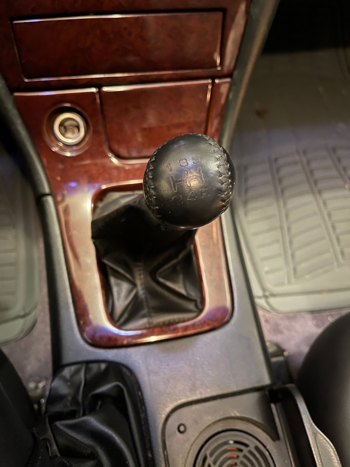

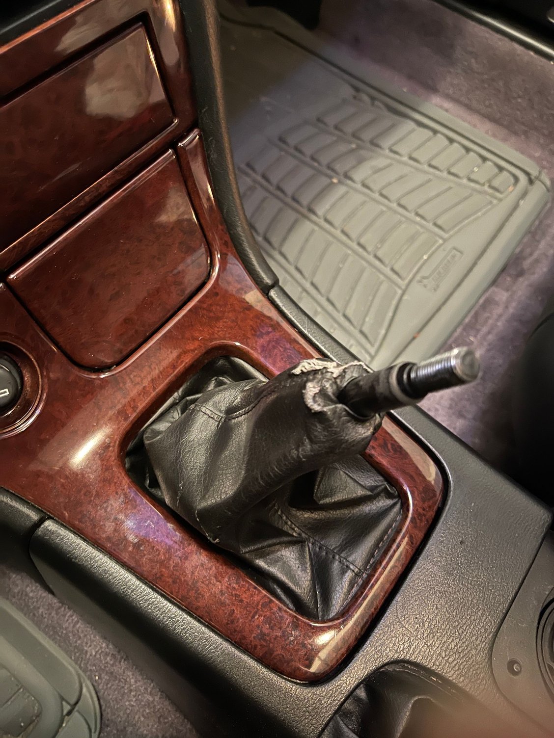

Replaced a few worn items with some new ones. The shift boot is from RedlineGoods. Also got some other plans lined up for the next few months.
Old Shift boot and ****
New OEM **** with leather boot from RedlineGoods

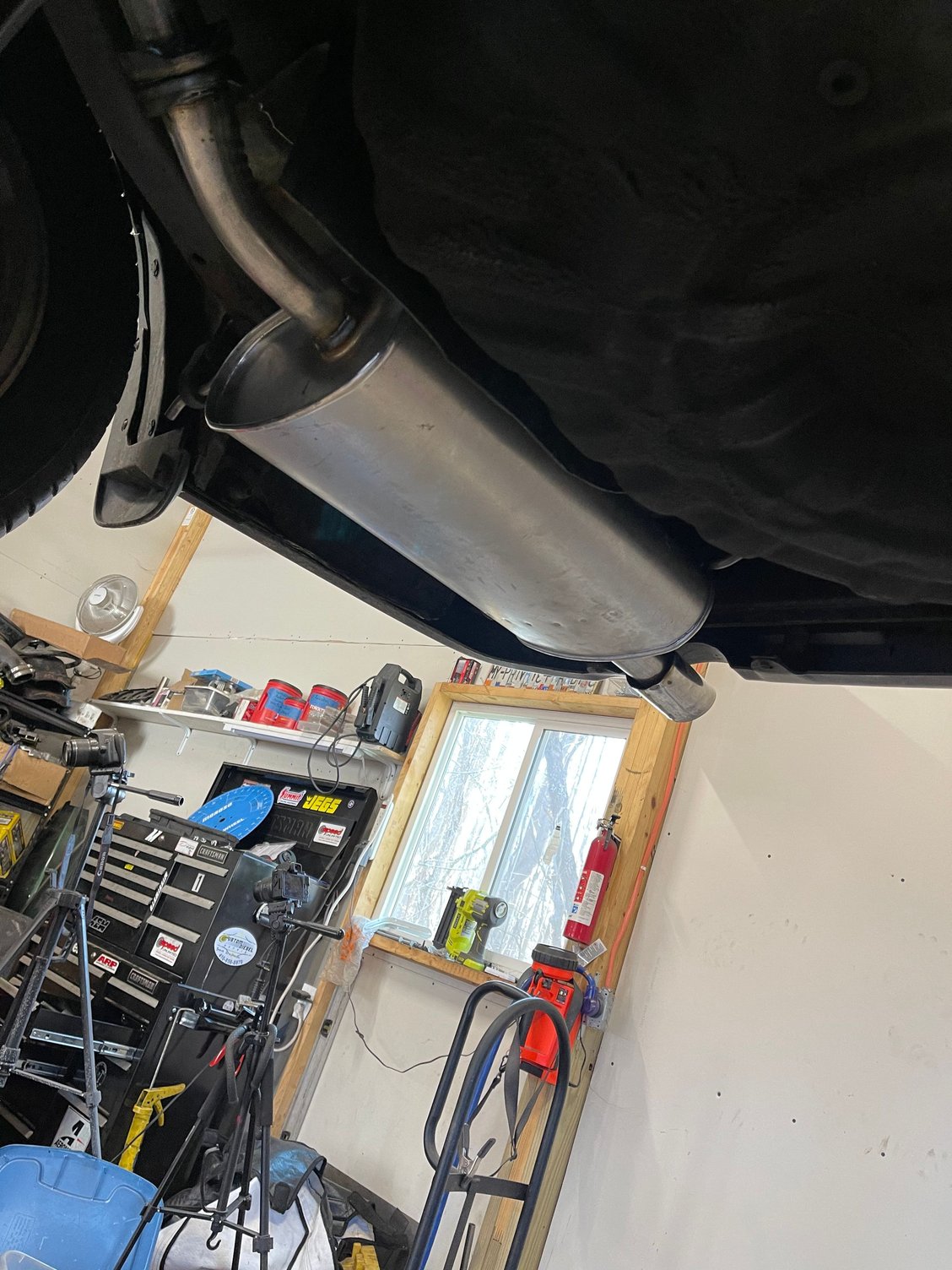

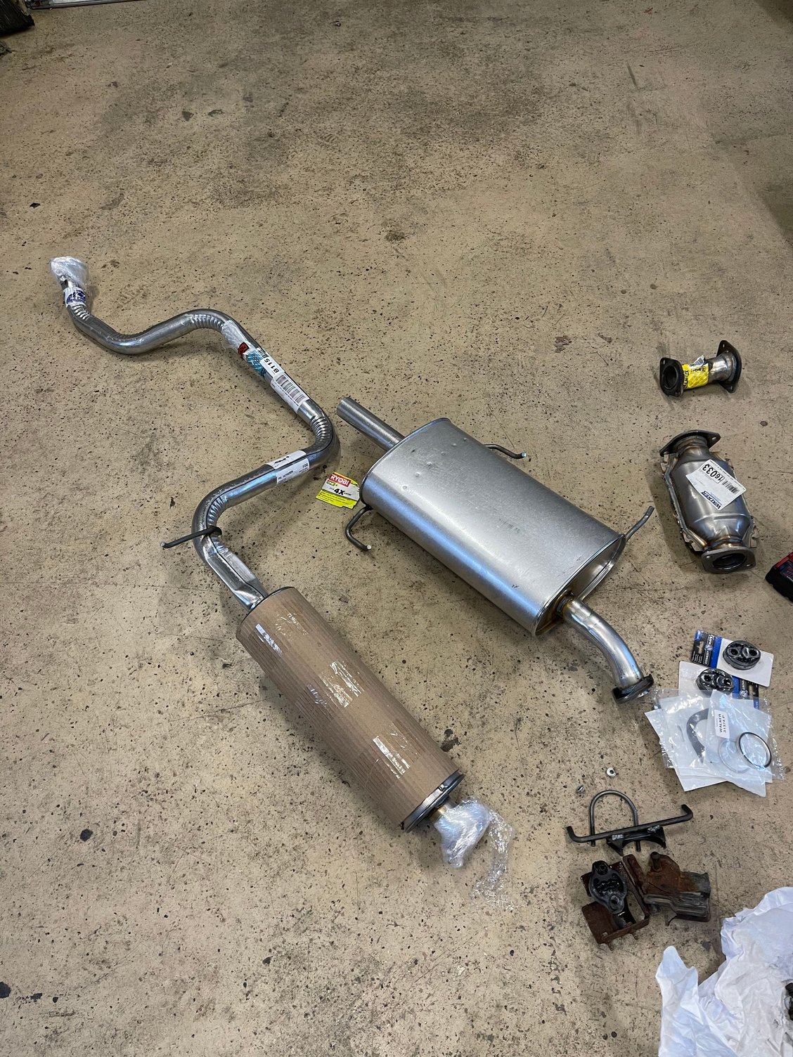

Replaced the entire exhaust after the y-pipe.

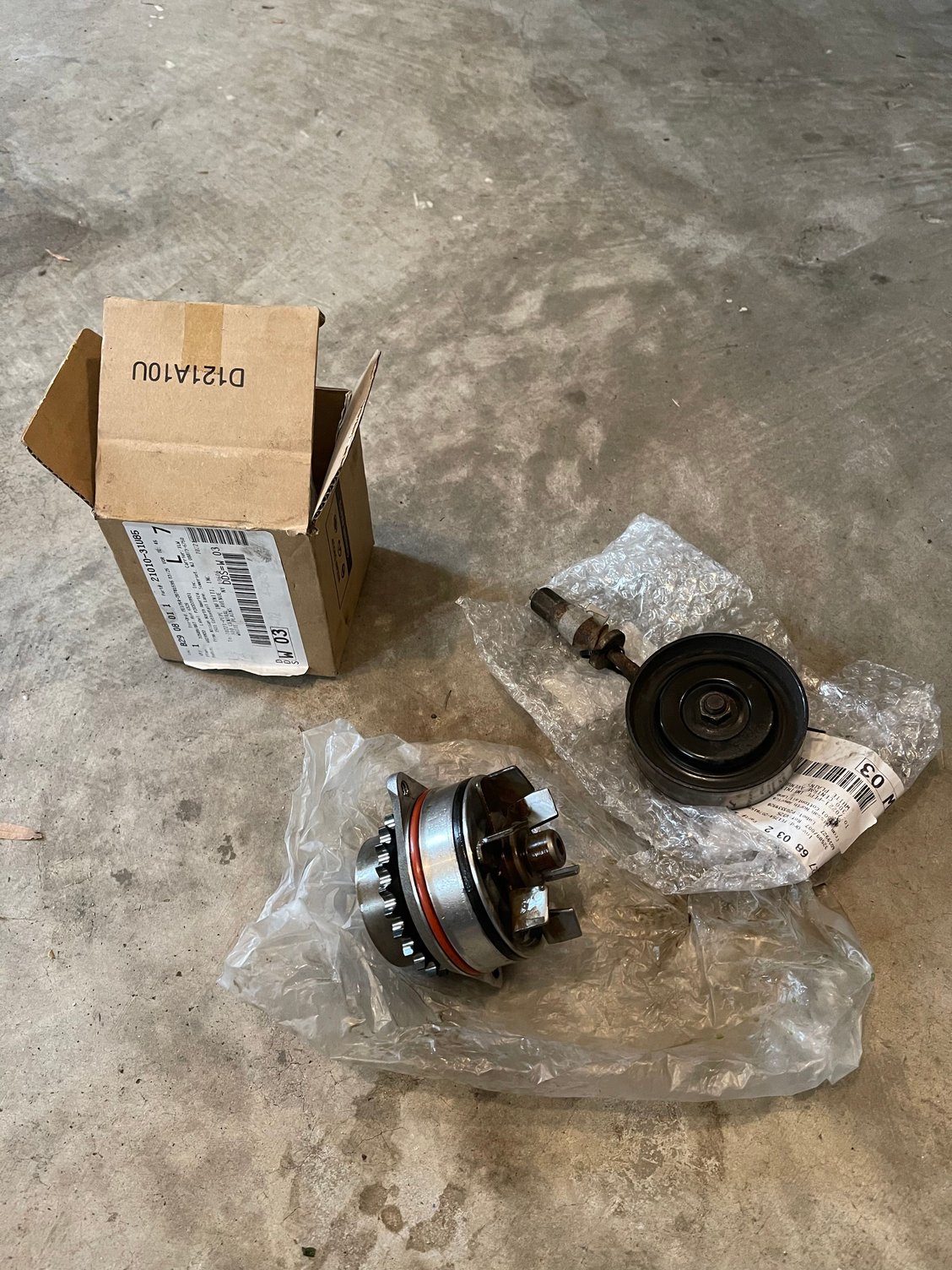

I had the water pump replaced as preventative maintenance after a few members here had the o-rings fail in the last year or so. Definitely didn’t want that happening and possibly mixing coolant and oil. This wasn’t a job I was comfortable dealing with, I took it to a guy that has done this job many times before. Also had the tensioner pulley replaced since it had to come out anyway.
Old pump and pulley

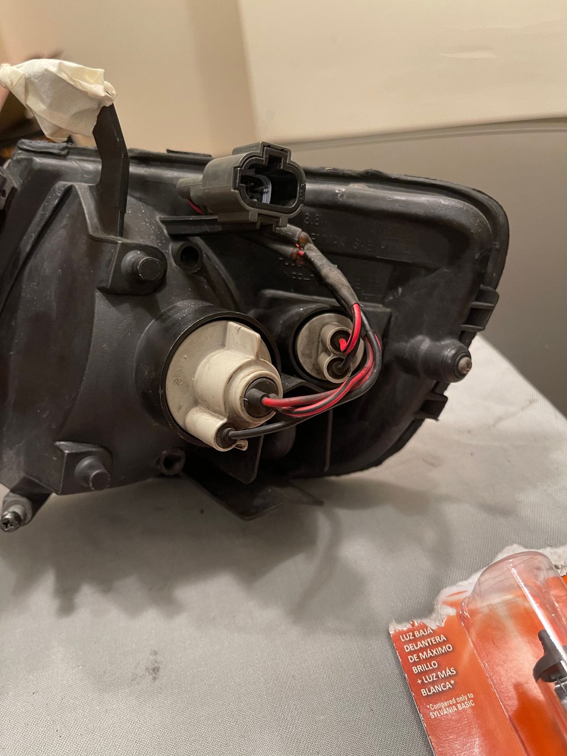

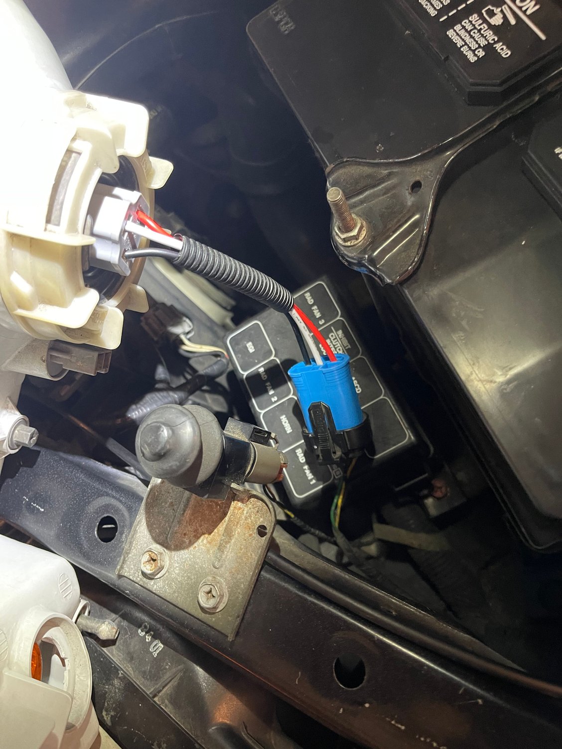

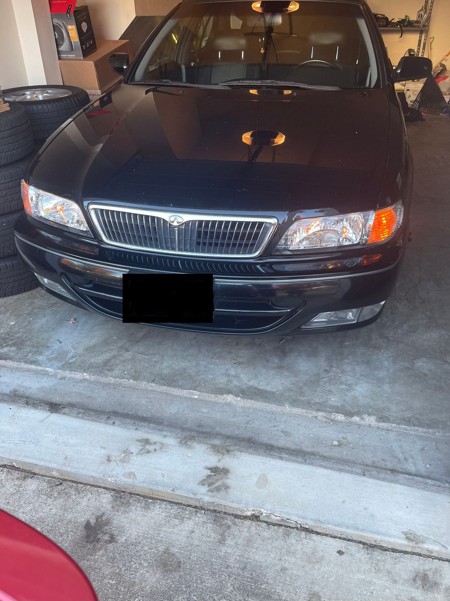

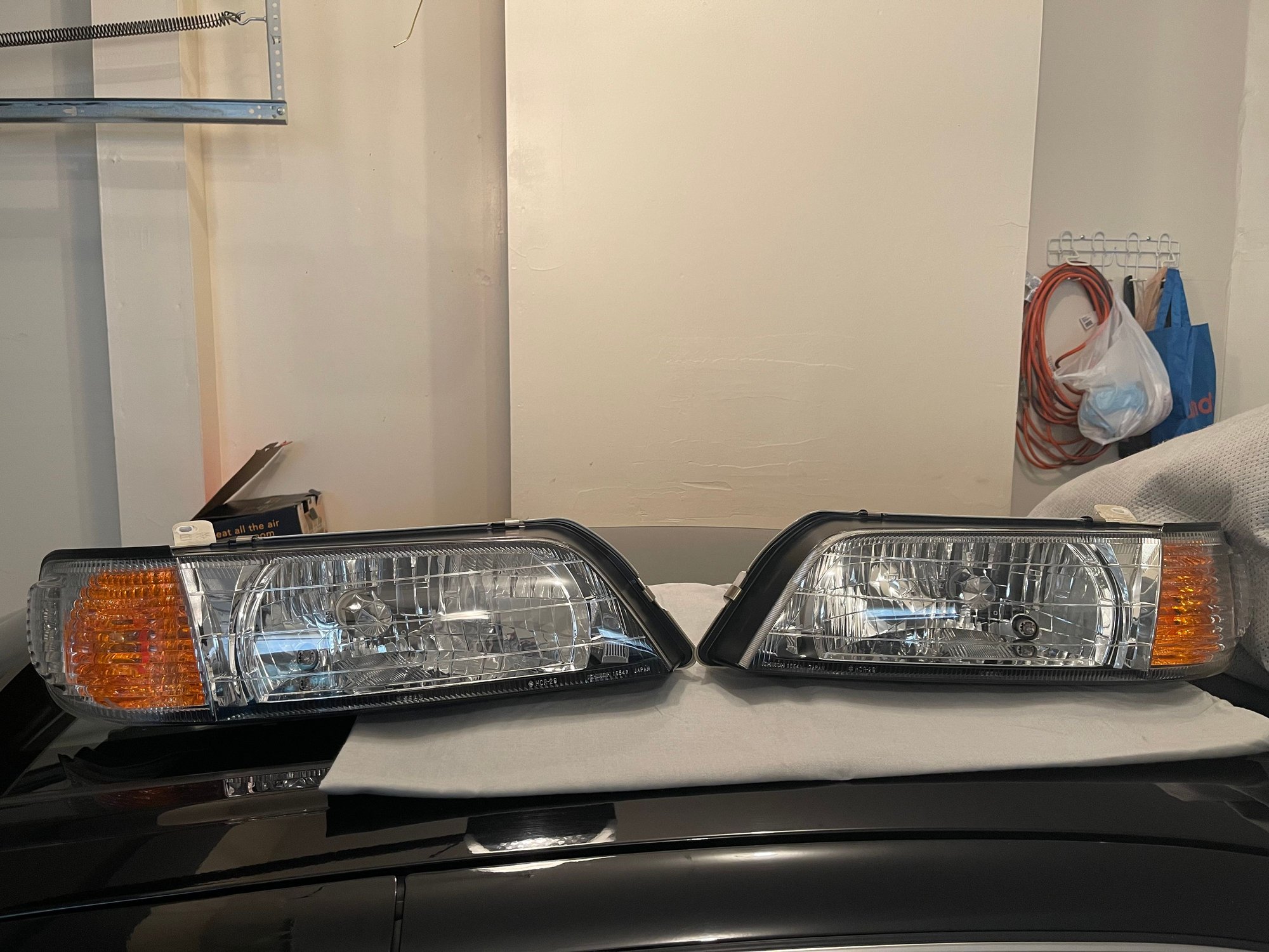

Installed the Cefiro headlights. I have to take some night pics.
Old Oct 31, 2021 | 06:52 PM
  #103
aembleton's Avatar
Joined: Jan 2018
Posts: 291
From: Vancouver, Washington
That looks so clean. Was it a direct swap or did you need to splice harnesses?
Old Oct 31, 2021 | 09:32 PM
  #104
98 i30t 5spd's Avatar
Joined: Sep 2017
Posts: 215

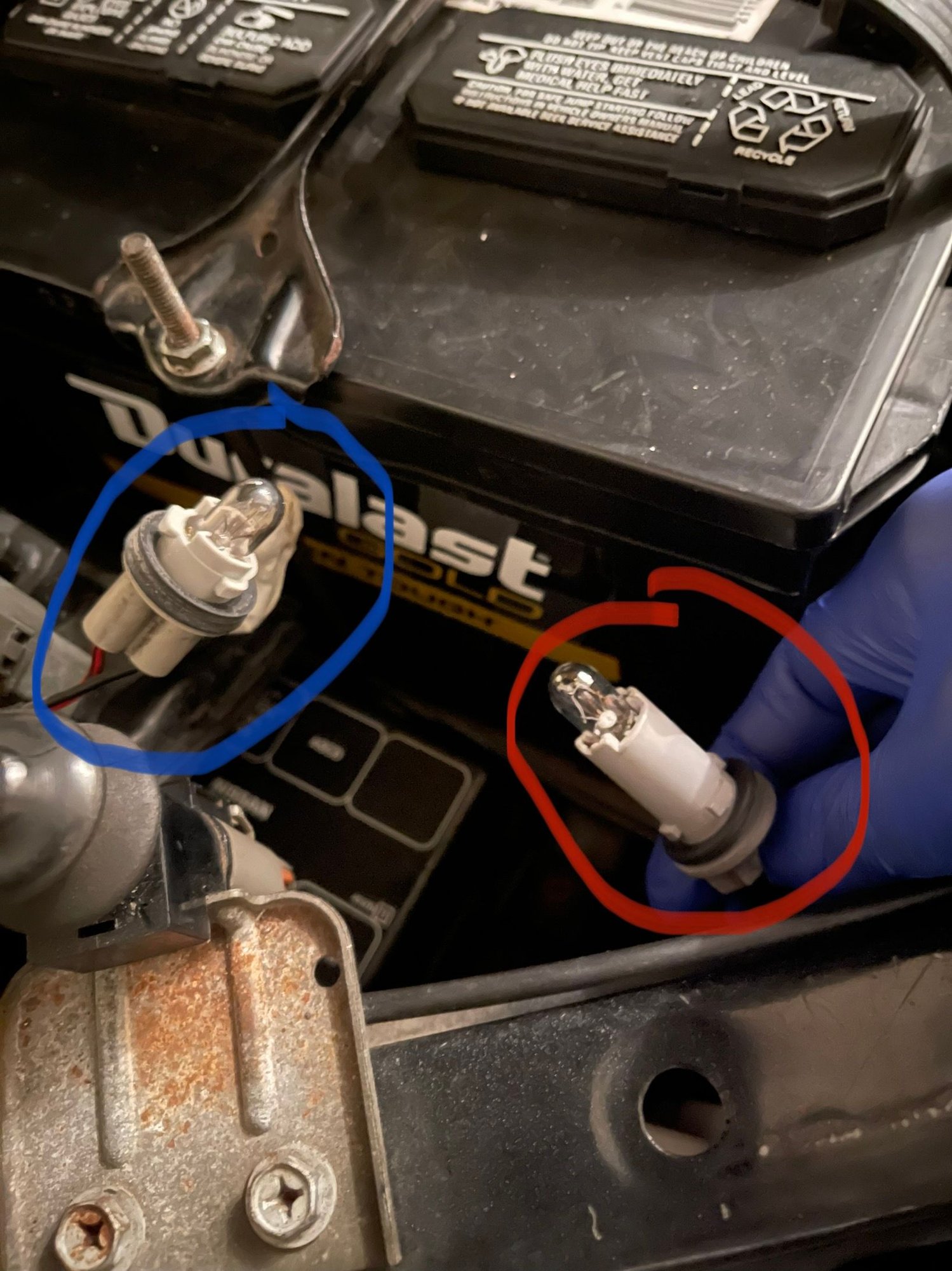

Thanks. I bought a 9004/H4 harness adapter that connects between the H4 bulb and wire harness because the Cefiro headlights use H4 bulbs. This allowed me to avoid cutting into my harness and it allows me to return to the stock headlight assembly without any issues.
The side lamp (city light) is different though. The stock side lamp has its own harness and houses two bulbs (city light and turn signal). The stock turn signal housing will fit in the Cefiro headlight assembly but the city light housing does not.
The stock city light housing has three notches and is short, while the Cefiro city light housing has four notches and is considerably taller. So you must pull/splice the ground and power wire from the stock city light housing and connect it to the Cefiro city light housing.
To avoid doing this to my side lamp harness, I pulled two side lamp harnesses from my local yard from a i30 and did what I mentioned above. Again, if I choose to go back to my stock side lamps, which the original harness is still connected to, I can do so without any issue.
If you don’t care for the city lamp, then you can skip that part and it all becomes plug-n-play with the exception of a 9004/H4 harness adapter. On a side note, these are the headlights the i30 should’ve came with from the factory.
What it looks like connected between the H4 bulb and 9004 wire harness.
The stock city light housing circled in blue with the ground and power wires which must be spliced into the Cefiro city light housing circled in red.
The stock side lamp harness you will have to pull from a yard if you don’t want to cut into your existing side lamp harness. The smaller bulb is the city light.

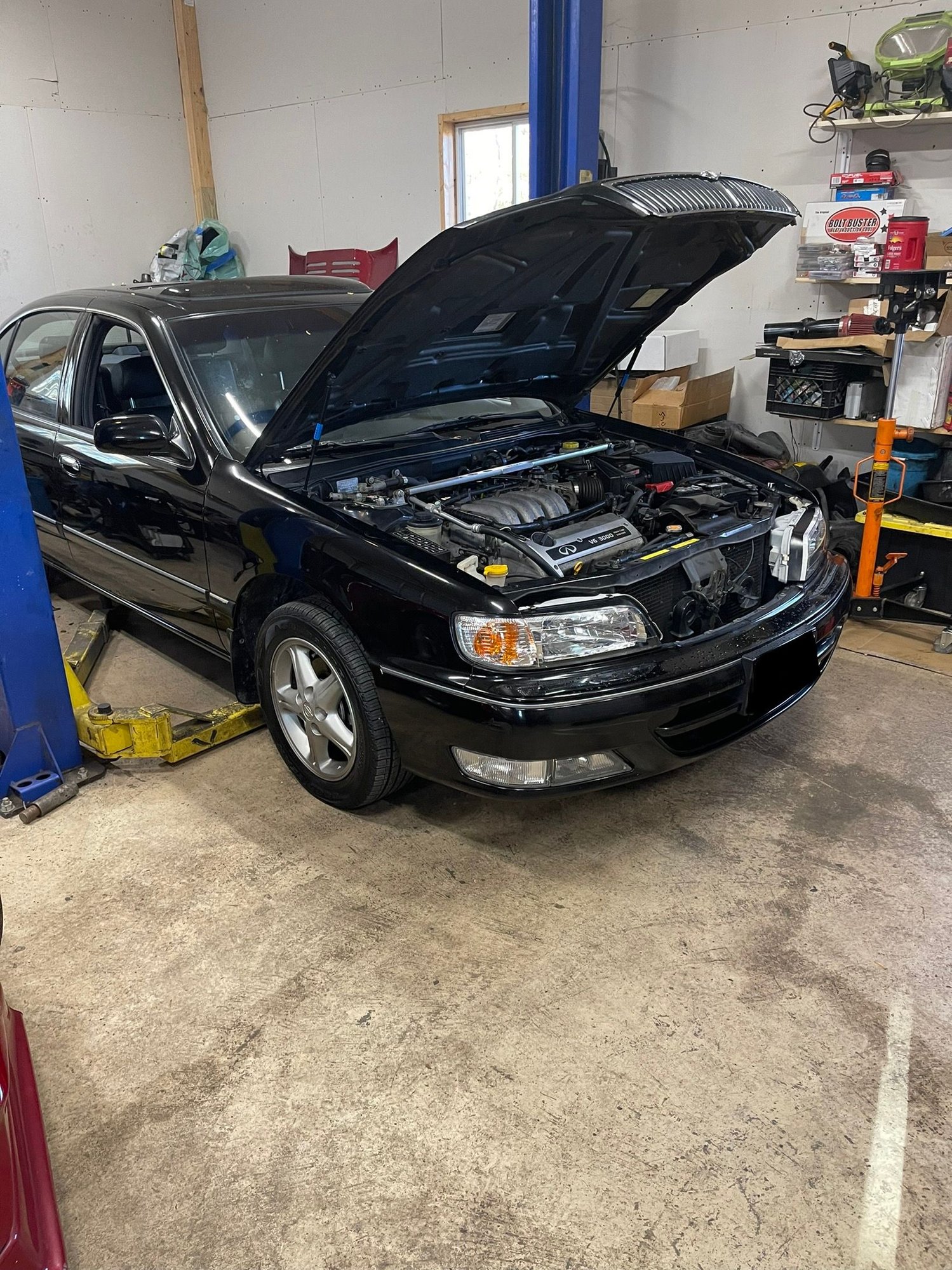

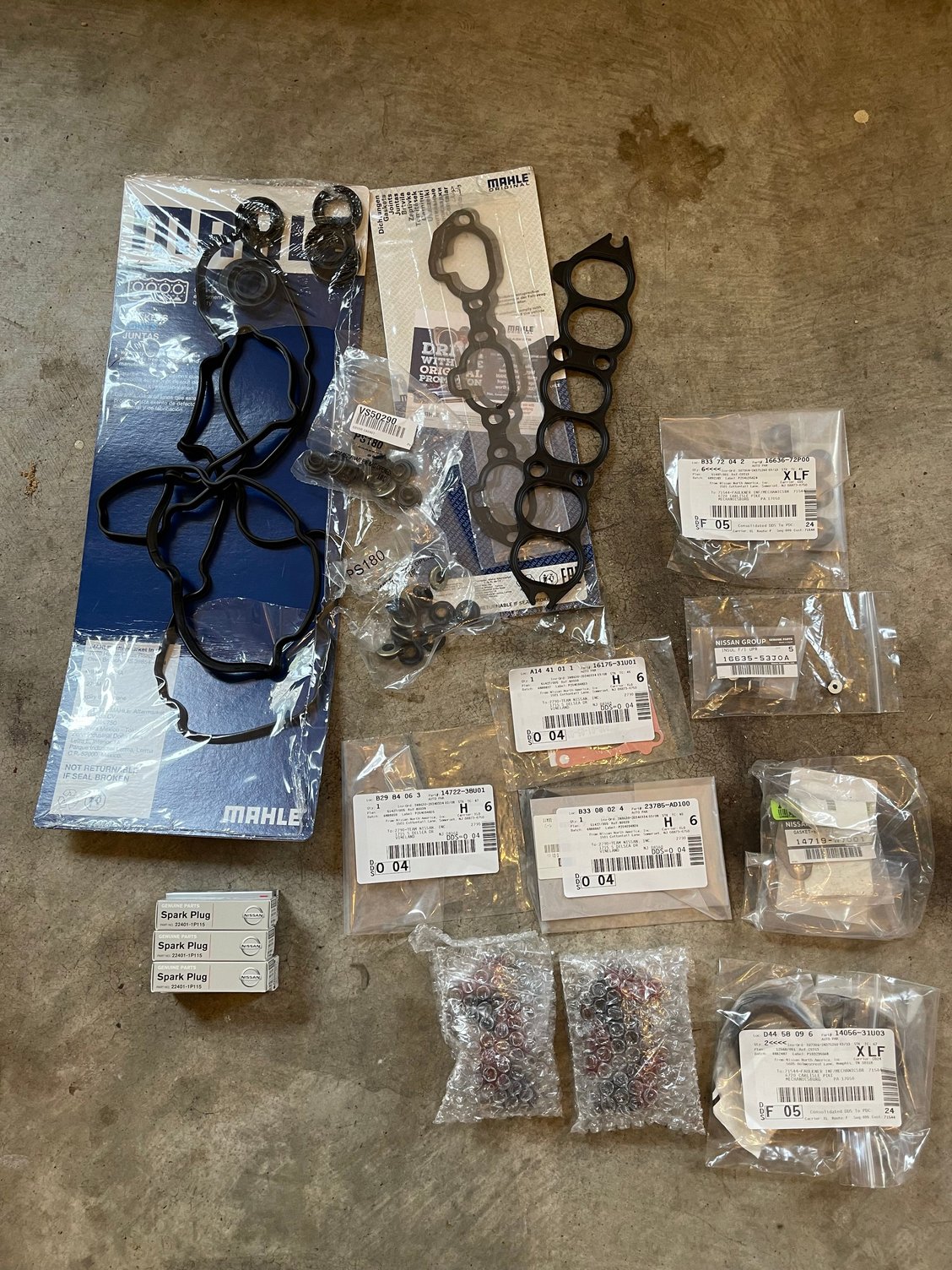

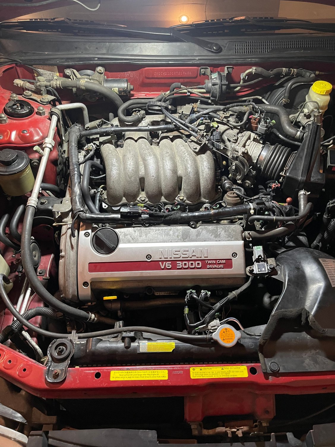

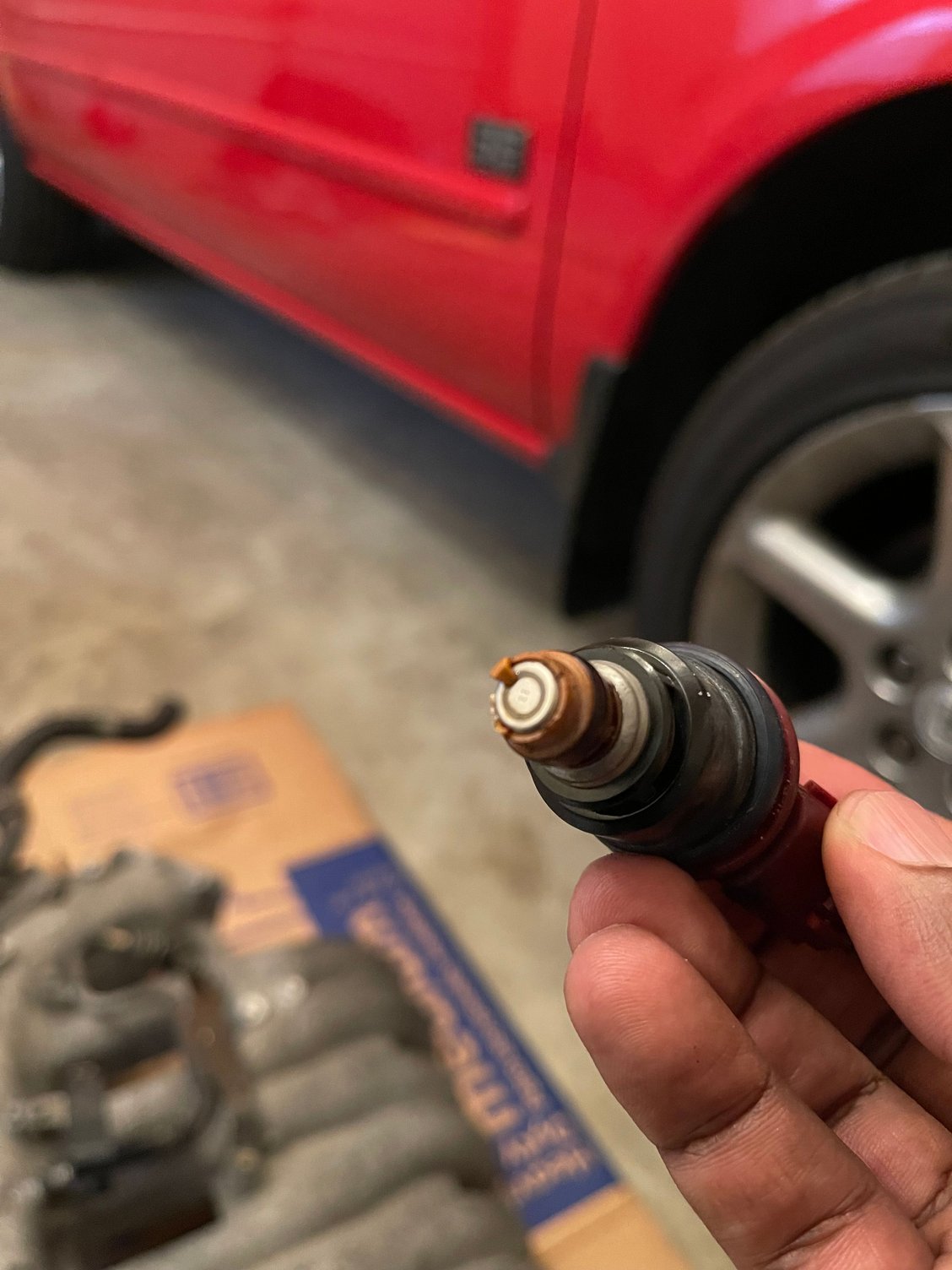

A few months ago my 99 maxima developed a misfire once the engine was at operating temperature. No check engine light, and no codes were stored. The coils were working properly and the spark plugs were in normal shape. Then I started to get hard/long cranking starts at random. The car would normally start on two cranks.
So I changed the easy stuff first, fuel pressure regulator and the fuel filter. Still had the same symptoms. Still, no check engine light. At this point I decided to wait until the problem was consistent. Finally I got a code for a random misfire. I pulled the spark plugs once again and that's when I found plug #3 soaked in fuel.
I knew now that I had at least one bad injector. When I pulled all the injectors, I found that injectors 1,2,3,5 were all bad.
• I replaced the injectors with rebuilt OEM from Motorman.
• Installed new spark plugs
• Replaced the rear valve cover gasket
• Cleaned the IACV and the throttle body
• Cleaned the EGR door handle
• Replaced a rubber fuel line
• Replaced the U shaped coolant hose behind the intake plenum
• Replaced the rubber insulators under the fuel rail.
• Replaced the rubber vacuum hose that connects to the front and rear valve cover
Once everything was put back together, the car started right up in two cranks.
3 more injectors looked like this one.

Quick update:
I drove the Maxima and it sounds great. No more random misfire, or long cranking starts. It idles quietly and smoothly now. Hooked up the OBD scanner and everything was clear.

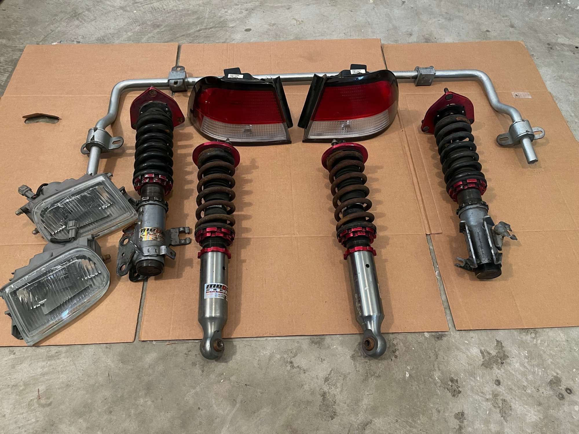

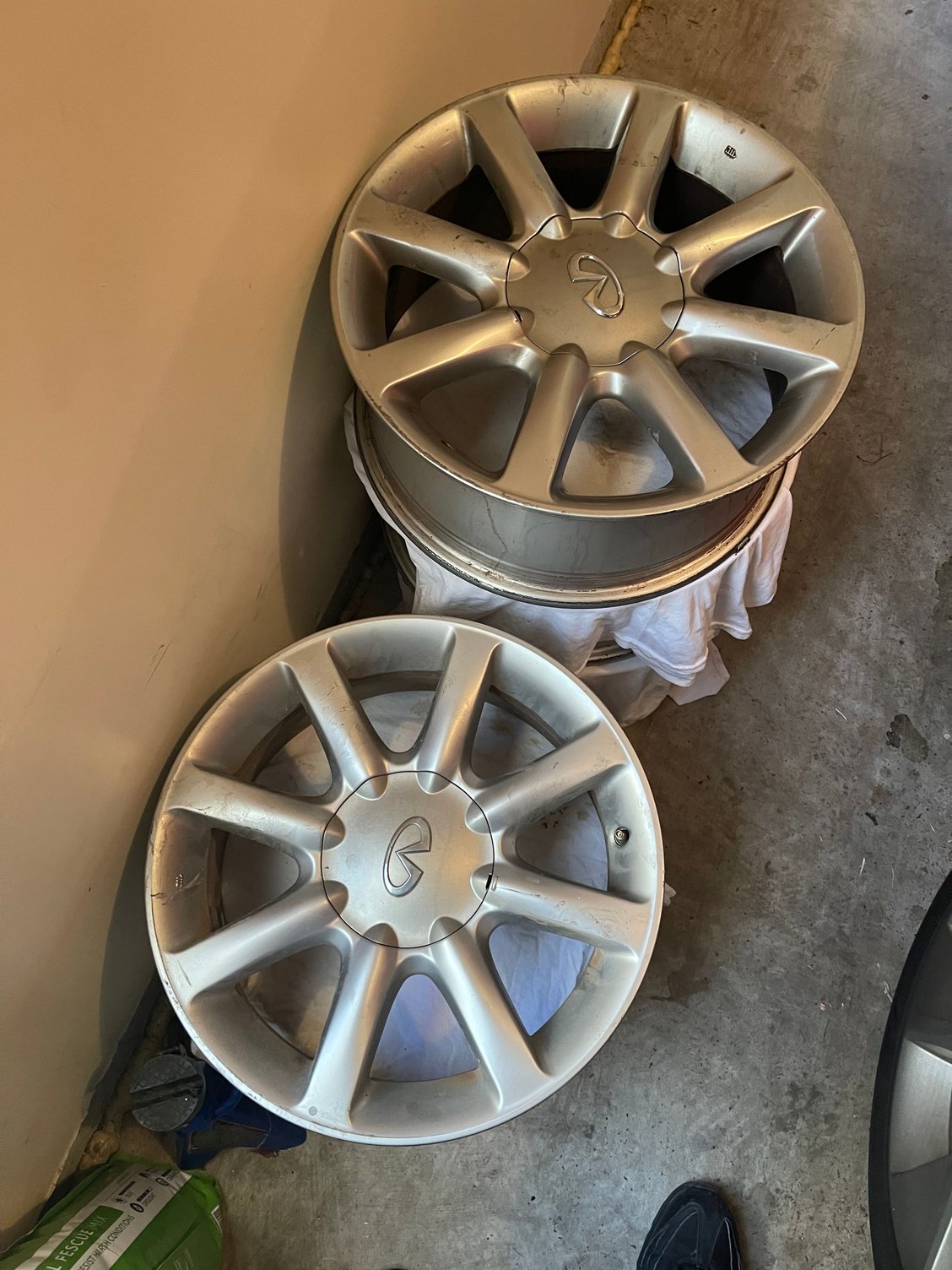

Also, I picked up some parts from a Maxima that was at a junkyard. I might use them on my Maxima. The fog lights are for a 95-96 Maxima which I’ll post for sale. I also picked up a set of 2002 i35 sport wheels for my i30t. It had a full size spare in the trunk which I also bought. As for the i30t, it got a wash and went back under the car cover.
Rear sway bar, Megan racing coilovers, red/clear taillights. 95-96 fog lights.
2002 i35 sport wheels with a full size spare.
