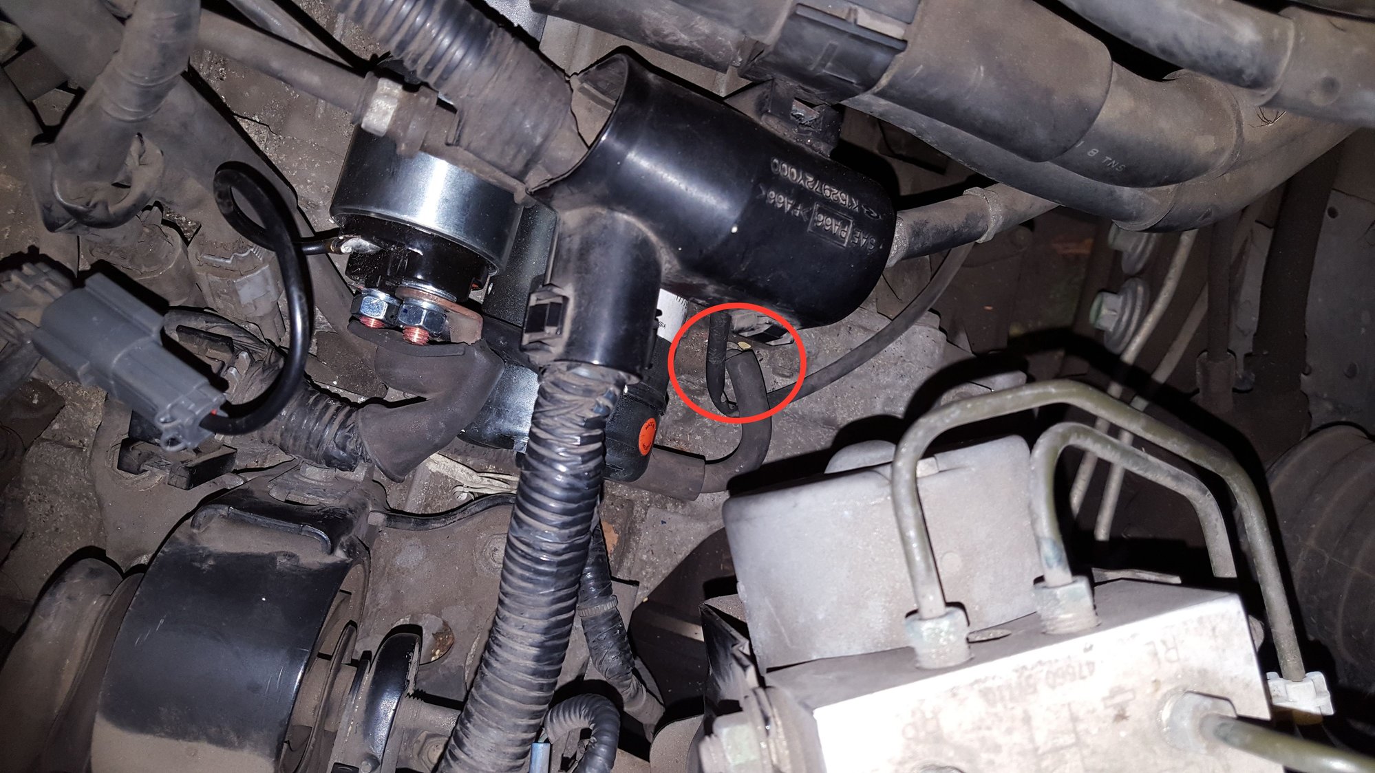

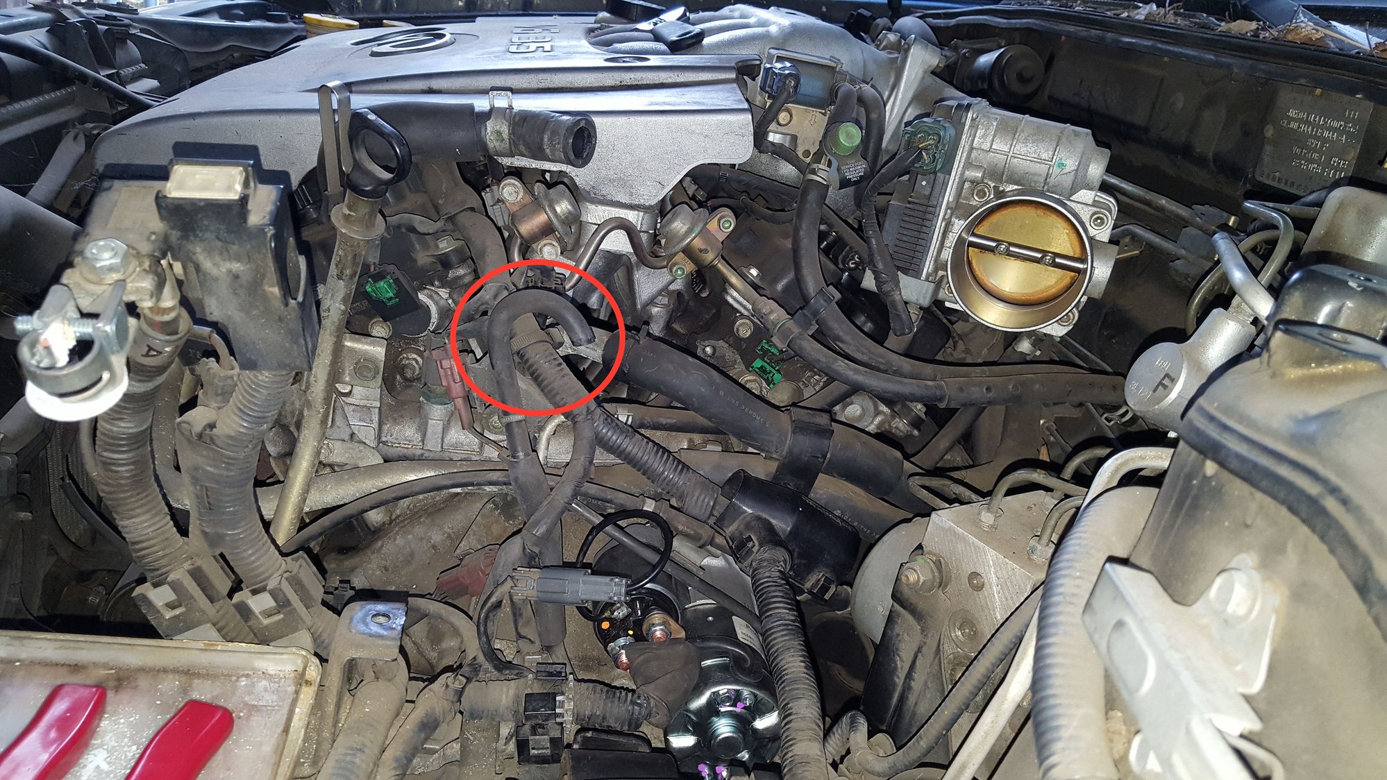

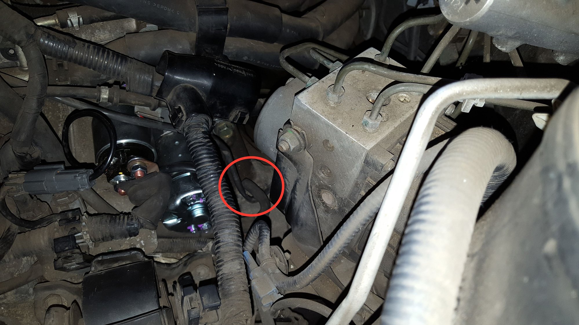

Finished up replacing my starter and somehow I've now got 2 disconnected hoses even though I only purposefully removed 1. Any idea where this is supposed to connect? I think it might be transmission related.
Hose in question:
Other end:

From http://www.nissanforums.com/b14-95-9...-breather.html, it seems to be a breathing tube for the tranny. Other photos seem to confirm this.
