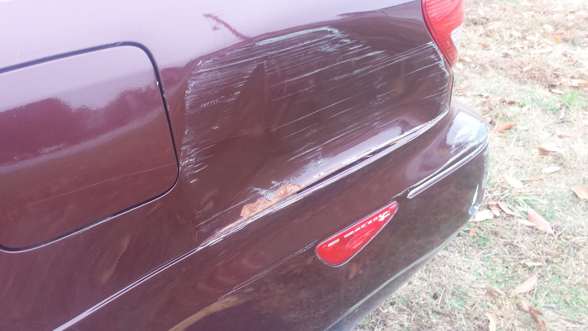

Dent in the quarter panel:
Worth fixing or don't worry about it?
Old Oct 31, 2018 | 12:46 PM
maximaxi's Avatar
Joined: Mar 2010
Posts: 371
That dent is nothing to worry about
If you can rub off the white streaks, you wouldn't even know the dent is even there in the first place

Unfortunately there's also that surface rust spot there that needs to be treated. But you're right if it's more than a few hundred bucks I won't worry about it.

The white streaks don't come off, they are marks in the paint. Also that rusted area is starting to bother me.
I found a guy on craigslist a couple days ago who does body work out of his own garage, it's a legit business and he does repair estimates, works with insurance companies etc he just doesn't have the overhead so his prices are lower. I asked him for an estimate to get this repaired and got a quote of $750. (That does not include the bumper just the quarter panel damage.) I am seriously starting to think I need to get this done sooner than later and that seems like a decent price IMO although that additional $750 drives the total cost of the car up to $2350-- a price point I'm not nearly as happy with.
If it wasn't for being able to fix the AC by just swapping the relay I definitely wouldn't even be considering it, but considering that easy repair it might be worth throwing the money toward the dent to make sure that rust doesn't spread.
In other news, the front bumper is missing the three supports inside the air intake area (in front of the lower part of the radiator) -- they were broken off so I'm also a bit concerned about debris flying in there and putting a hole in the radiator. That can be fixed by just getting a new bumper of course- but I can't find one on car-part.com in the burgundy color anywhere close to me. Closest one I found is about 5 hours away. I also wonder if just getting another rear bumper would be the better way to go as well- the marks on the bumper are worse than what I first thought, someone has bondoed this bumper (yeah they bondoed a plastic bumper) and then painted over it- some of it came off literally in chips when I took it to the car wash today.

Got a pretty decent quote of $850 to fix both the rear quarter panel and the bumper on the car- talking to the body guy we noticed this quarter panel has been repainted before- lots of question marks about what happened with this car before I got it. probably going to go ahead and get it done next week.
