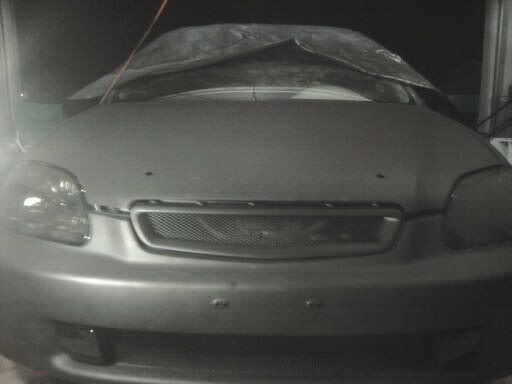

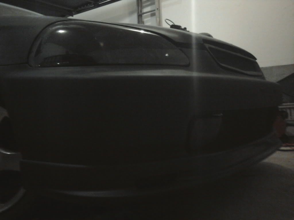

I'm bored, and figured i'd post up what i've been working on the last few years.
Engine:
D1678
FJT custom length eagle rods
Vitara 75.5mm pistons
King bearings
Port/polished head, intake/exhaust manifold, turbo
Greddy td04h turbo kit
Hondata S300
GM 3bar map sensor
AEM wideband
E-85 powered
Bosch EV14 750cc injectors
walbro 255
LSD motorsports clutch ~300lb-ft capable
MAC boost solenoid (Boost by gear)
Mandrel bent 2.5'' exhaust
Suspension:
Swift springs
Tokico blues
Skunk2 front camber kit
Ebay rear camber kit (never buy one, bushing are already shot)
