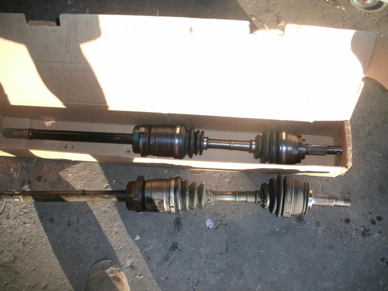

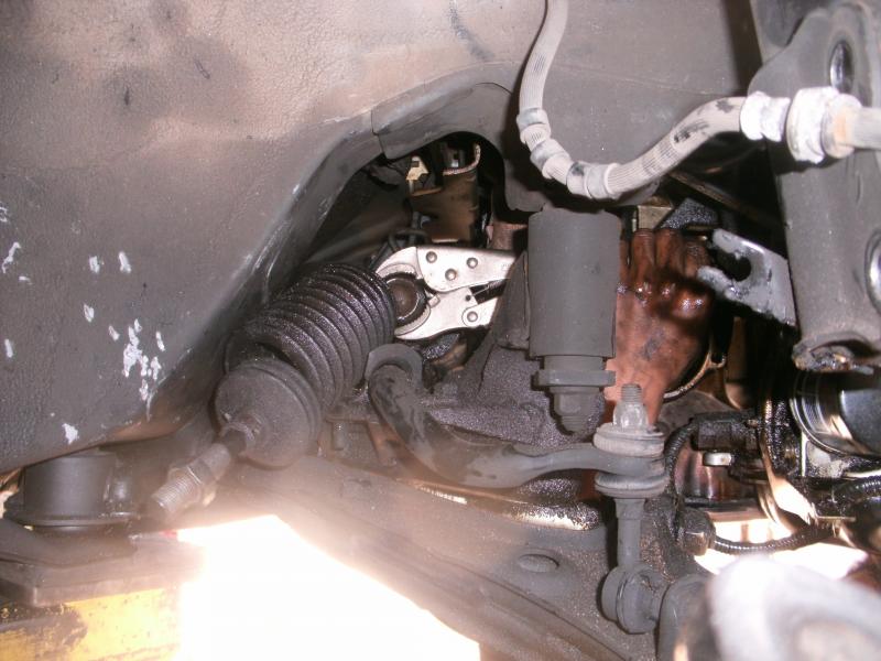

Well I changed the r/h axle and also the inner and outer tie rod as it had serious play in it. All codes cleared after I changed #2 coil pack from junk yard for $14.00,axle-rebuilt for $36.00 and I think I payed the same for the whole tie rod. The inner tie rod was a pita to change where as the axle was easy. Also replaced arm rest. Those are hard to find in a jy in good shape. In fact it took 3 trips to find one. Here is a few pics. To make things clear I had fixed the other codes with the speedo cleaning and just had the misfire which the coil pack fixed. The car runs great now. Never could have done it without these AWESOME forums. Best $500.00 car I every bought. I also fixed a number of other things that where cheap to do with jy parts like ignition,power mirror,8 way power seat switch,2 shorts and a few other things. EVERYTHING works. Cig lighter was the last thing which I did tonight. Thanks to everyone reading my long posts but I'm really into this car and these forums helped make that happen.

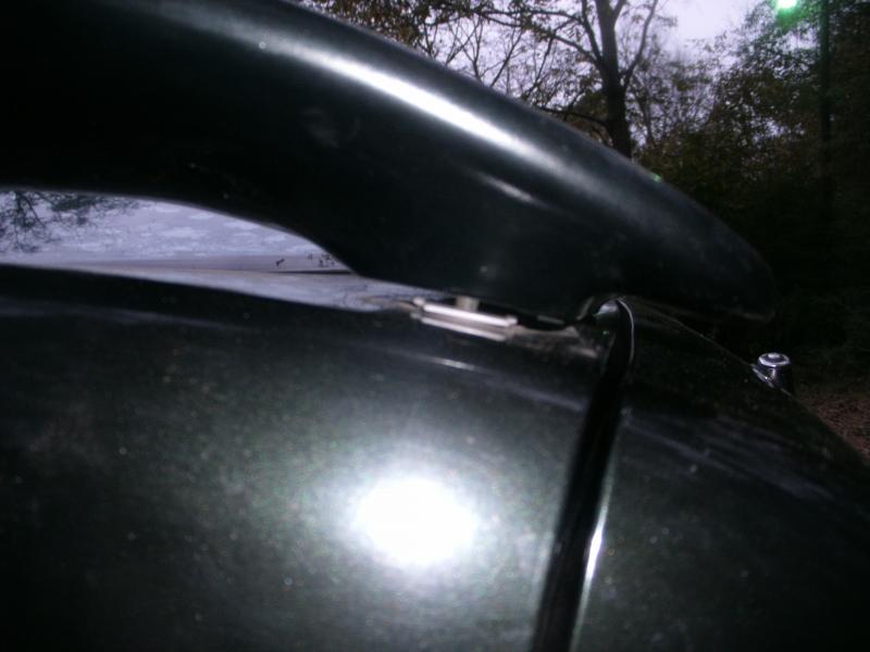

Well I popped the trunk and lifted the trunk by the wing and it snapped off. I guess it was barely hanging on. I looked in the trunk and saw that someone had screwed it on with some dry wall screws in some small holes in the trunk. Went to junk yard but couldn't find a green one like I was able to do with the d/s mirror. So just for fun I stopped at the dealer down the street to see how much a new one would cost.I'm trying to stop laughing so I can type this, so I ask for the price and the dudes laughing and gave me the number which was $643.00 before tax.
Well I took a couple self tapping screws and some epoxy and got it back on and it ain't going nowhere now, small gap on right side but you need to be right up on it to see it. I'm going to borrow a screw gun to get it flush. I will post a picture in this post later tonight.
