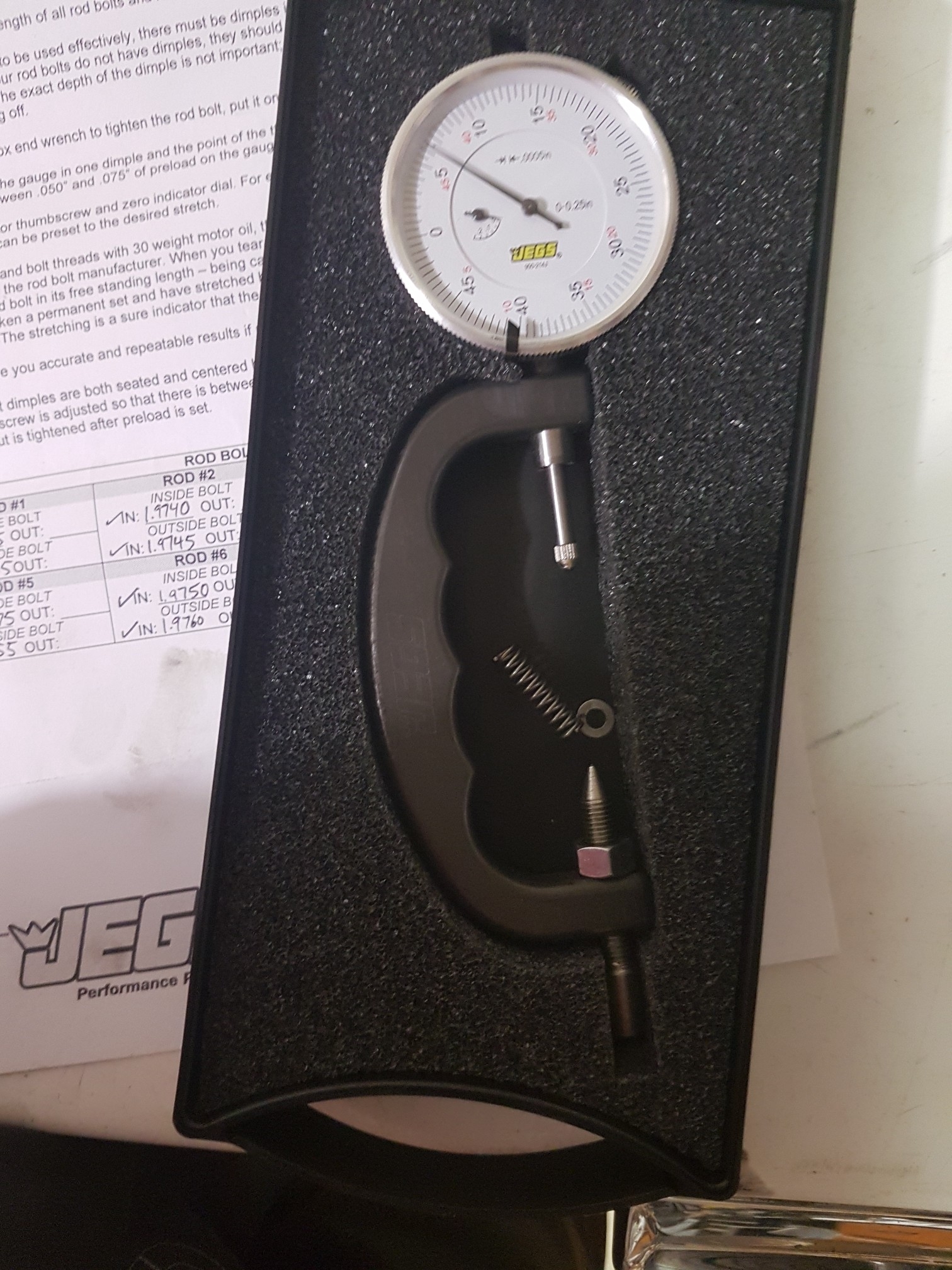

This was my first experience torquing rod bolts with a stretch gauge. I bought the Jeg's unit because ARP's is very expensive. I found it nearly impossible to use in a non-vertical position, the weight of the stretch gauge was too much for the spring in the dial to support. I read on a forum somewhere that this could be remedied with a washer and a spring as pictured. I simply unthreaded the contact point, installed the spring and the washer, and put the contact point back in place. It was SOLID!! I was able to remove the gauge, torque, reinstall gauge and it was very repeatable.
When I couldn't get a box end in I used my torque wrench with the gauge off. I found that the alternative torque method with my uncalibrated torque wrench added about .003" additional preload over the recommended .0065" to the rod bolts so I was very glad to have not cheaped out and actually bought a stretch gauge.
Last edited by freezer; Jun 14, 2017 at 01:13 PM. Reason: Add info on torquing rod bolts
That's great! Looks like it is coming along. Yeah, the stretch guage definitely seems like a good idea. Since you are doing the HR swap, did you see Nisformances latest thread?
