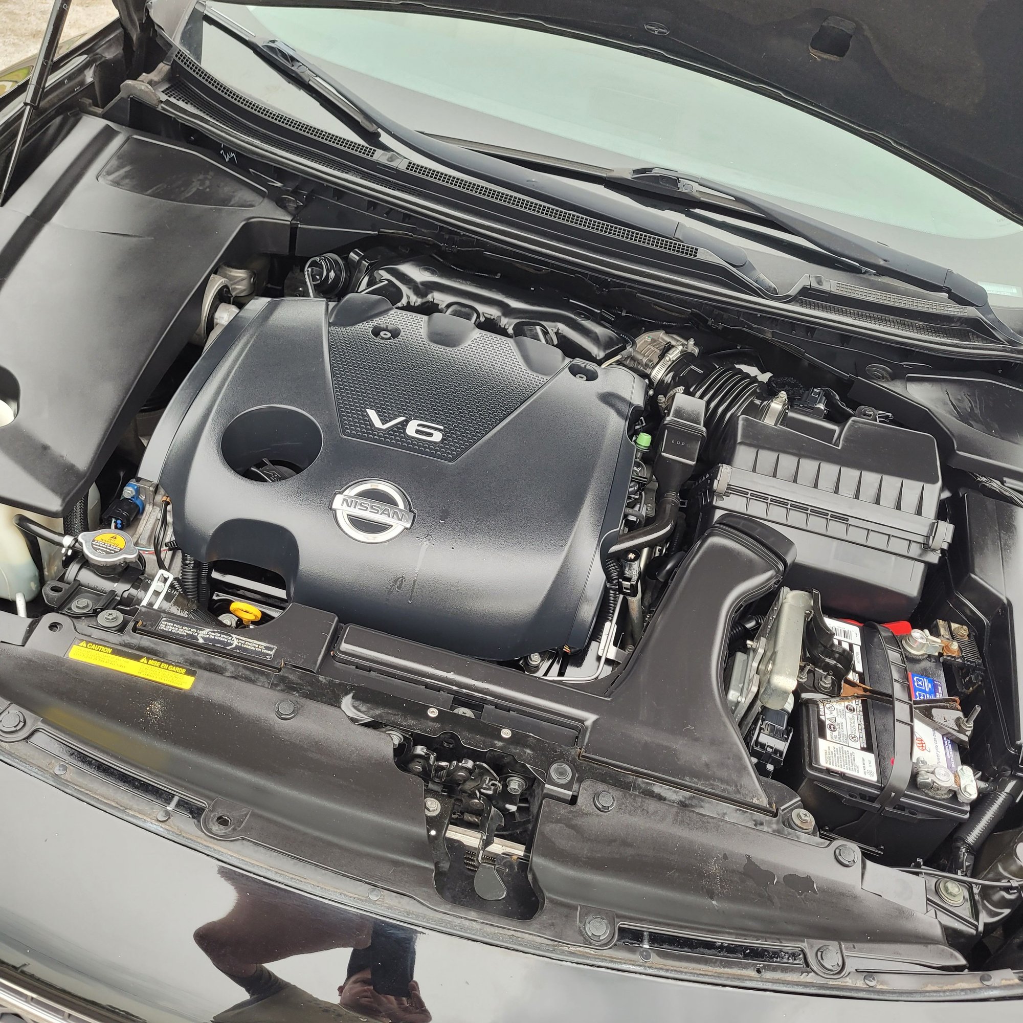

Hey all! Just bought another max after a full bolt on infin g20. Black 2010 sv with penut butter leather with 87,000 miles. Im new to the forum, at least in last 13 years. gonna drain and fill cvt with filter, change plugs and oil. Is 10w30 amsoil ok for florida or should i stay 5w30. Also what do you think about amsoil cvt? Thanks
