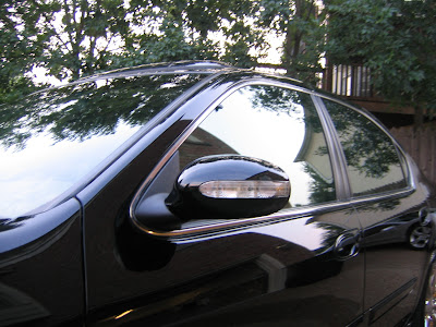

I only put them on like yesterday. Finished up most of the wiring today.
The folding function is AWESOME. I used the new switch and original wiring harness but ran a couple wires from each mirror to the new switch to get the folding function working. I also wired up the puddle lamps today, to the "room lamp" fuse in the fuse box. Unfortunately that fuse is "hot" all the time so the puddle lamps never went out. I then tried wiring them to the door (pin) switch behind the B pillar but didn't have success there either. Needless to say, I'll wire those in later after a little more research (and help from others). I basically want them to come on whenever the dome light comes on. (Yes, I could wire them to the door lamps but then they'd only come on when the door opens; I want them to come on when the door opens and also when the keyless entry is used). So, if anyone has any good ideas on where to tap the power going to the dome light, let me know.
I also wired in the turn signals today. That wasn't that difficult. The hardest part was getting the driver's side corner bulb out of the back of the headlamp because there's virtually no space to get your hand back behind it.
The physical installation of the mirrors is a piece of cake. It's the wiring that takes the time. And running the wires from the doors into the car takes most of that time. Fortunately I already had speaker wires run in there for my components so it was a little bit easier.
I hope to have pics soon. And videos! The LED turn signal is awesome. They use superflux LEDs for the puddle lamps and the turn signals so the brightness is pretty nice. The only thing I dislike is that the mirror glass is different than the OEM mirrors. Yes, it is tinted blue (which is nice) but the blind spot edges of the mirror are a little disorienting to use, particularly since I'm so accustomed to regular mirrors. I think they'll be great, however, once I get used to them.

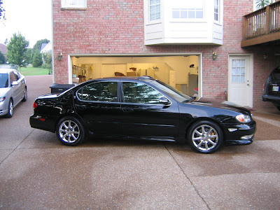

Well here are a couple teaser pics:
