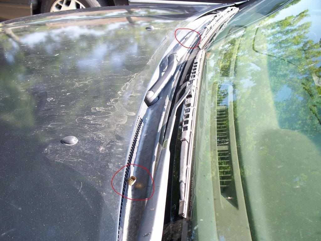

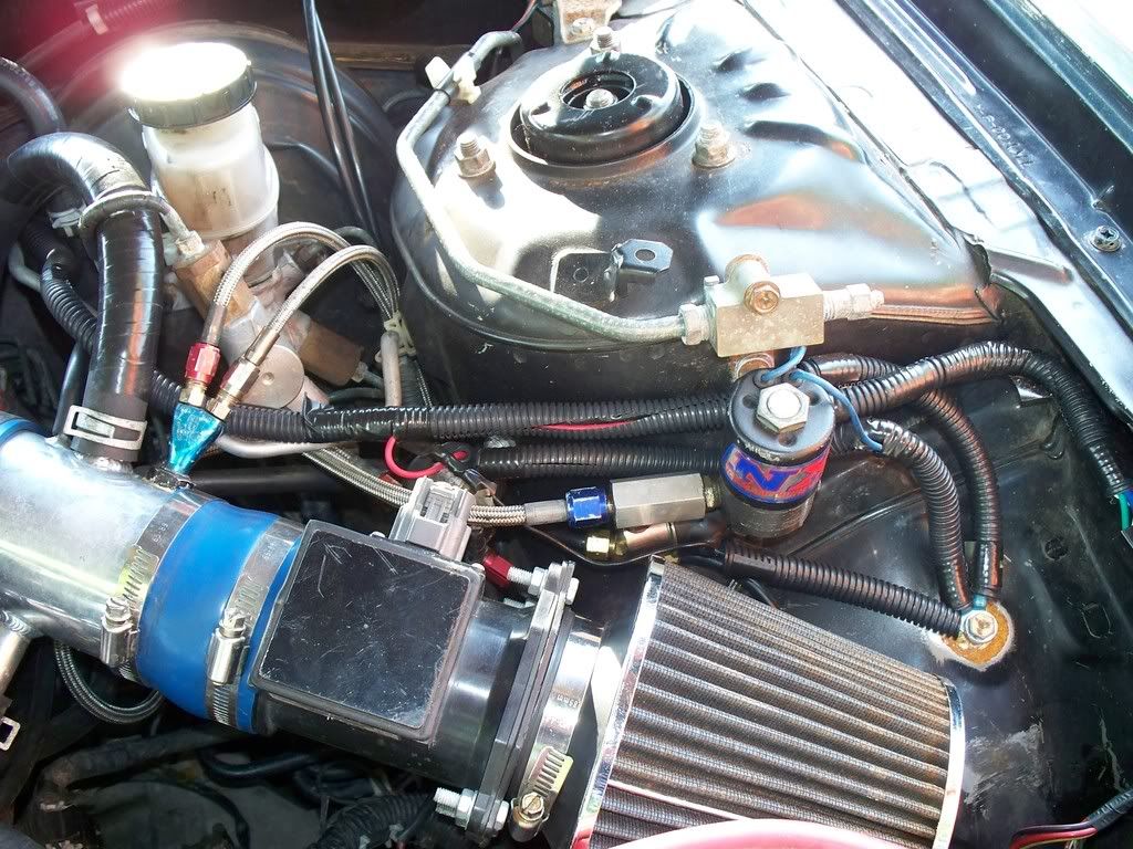

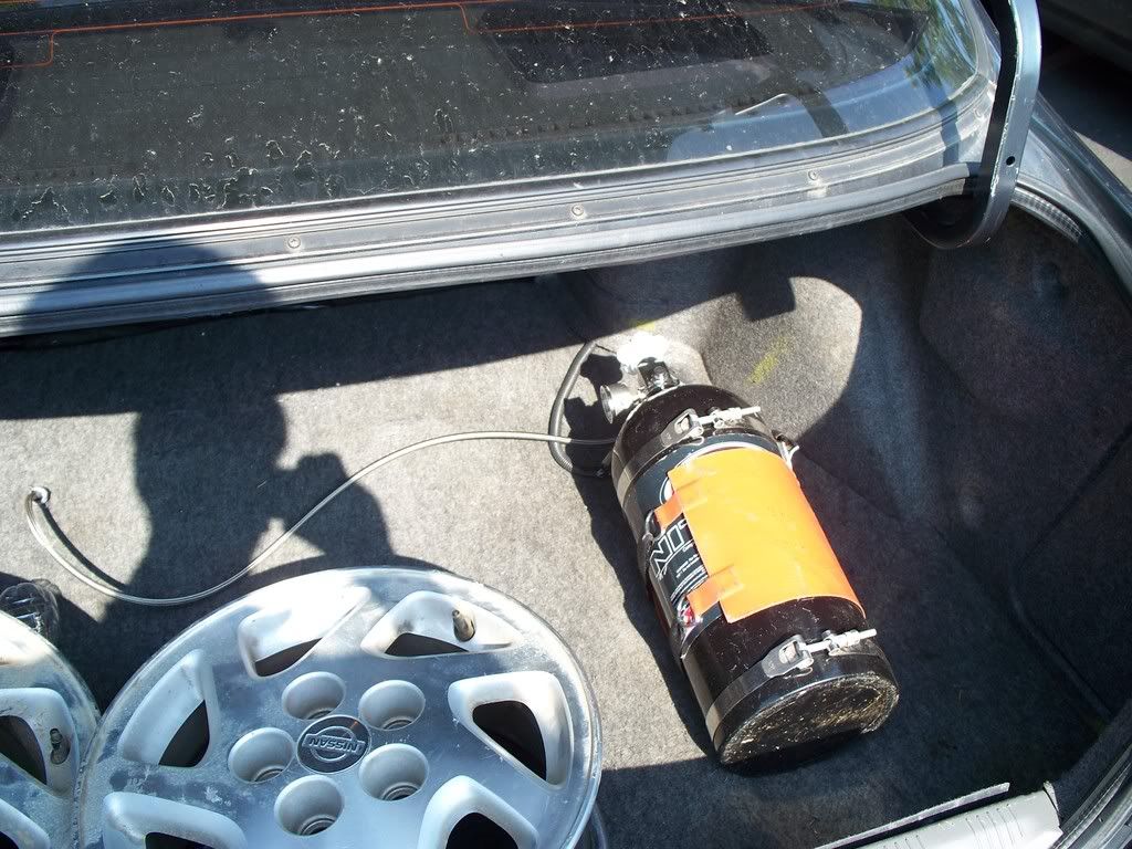

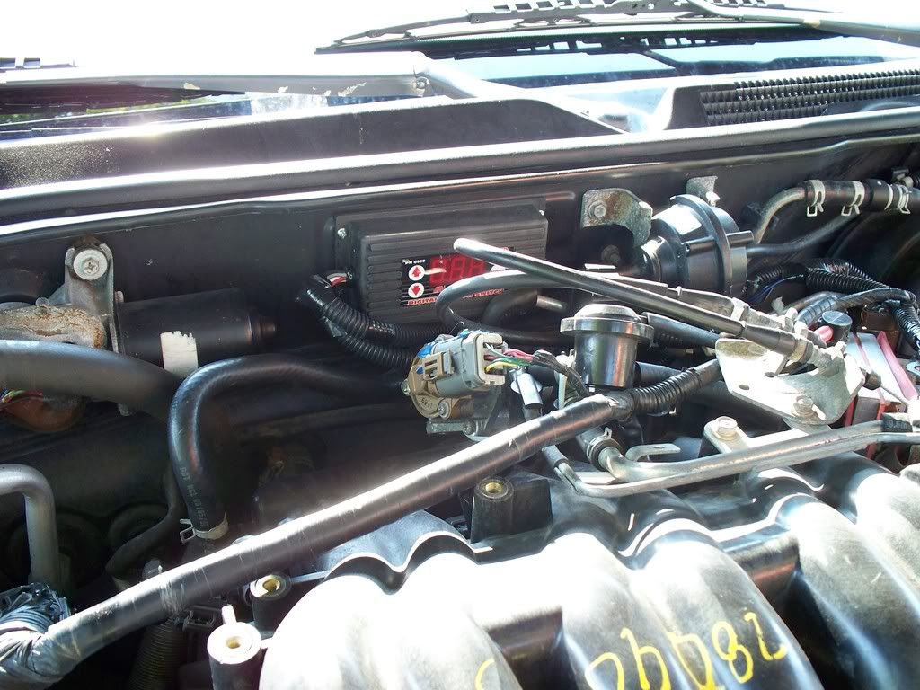

hey guys. i just wanted to share how i set up my nitrous. i also did an 00vi swap at the same time. well here it is...
ignore the broken plastic piece...a friend broke it and i just haven't found one yet..any one have one for sale? haha.
circled the dual purge...its kinda hard to see.

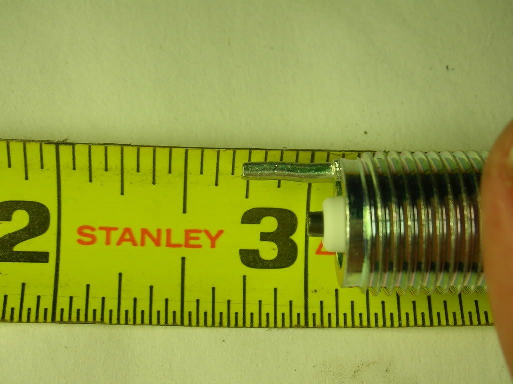

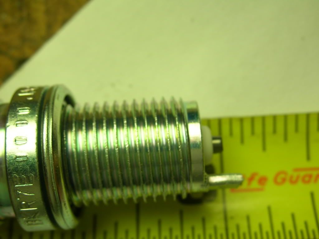

btw... tonight i pulled my spark plugs to check them out. the last time i sprayed nitrous was one week ago. my plugs have a greenish tint to them. i searched and couldn't get an answer...so i was wondering what is the color you want your plugs to be after spraying nitrous? what would each color mean as in green or blue....thanks!
Wow - you really did this right. In-line nitrous filter, MSD 8969 window switch, great electrical install - common grounds and all - and dual-purge! more guts than I've got... that will scare the ricers and street racers away.
Is this a dry kit? I didn't see a fuel solenoid, so if so, you should keep a pressure gauge on the fuel. Lean is not good. The colored glaze on your plugs' ground straps is the extra heat from nitrous melting the usual crud on your plugs into a form of glass - an expensive version of a pottery kiln... When your ground straps melt off, you have bigger problems - use race gas.

thanks grey! it was actually a fun install. doing it this way takes quite a few hours more than the "two hours" to install....but i like it. i will get pictures of the dual purge the next time i fill the bottle. its pretty cool...i made them to spray almost like a V .
i have a wet kit. yeah i didn't use race gas. i used premium. but next time i go i'll use it. 110 or something? i'm guessing a greenish color is ok though? i'm still searching for nitrous color read spark plugs...so as long as i don't go lean its all good!
i'm loving the nitrous! without the slicks i beat a couple SRT-4's at the track...now with the slicks and clutch they'll have no chance...and that was with a 50 shot!
edit: grey... the fuel solenoid is directly behind the MAF connecter. if you look closely you will see it...kinda hidden a little though!

OK - I see something there... I think. Yes, that is a nice install - I'm still trying to decide where to put my third pair of solenoids.

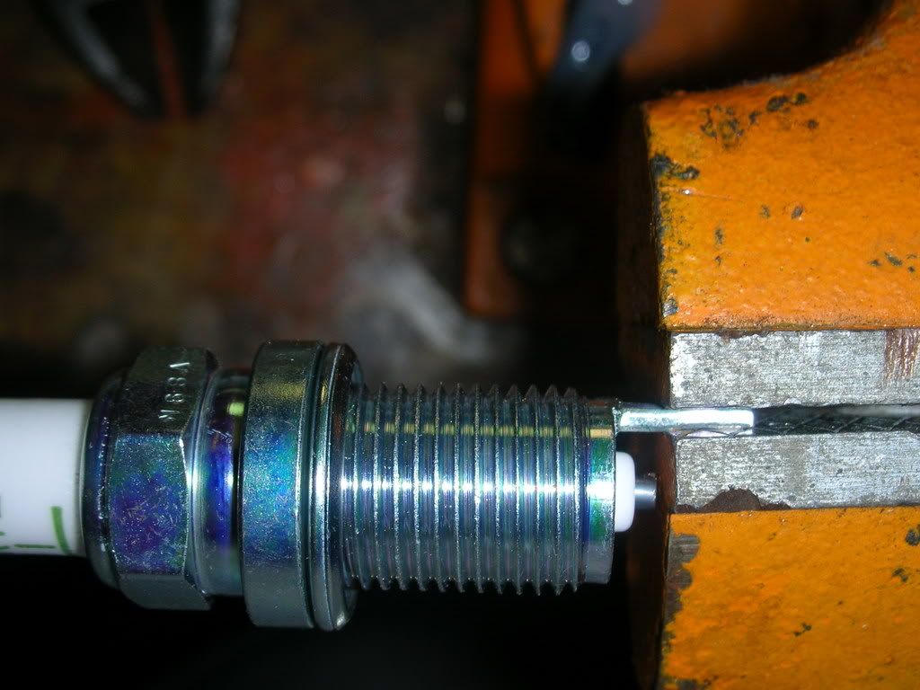

About plugs - watch the ends of the ground straps - don't worry about the green stuff. The tips on the grounds will start to turn black when they get really hot. At that point, you should straighten the ground straps, cut them off about 1/8 inch higher than the center electrode and bend it over towards the center - side-gap the plugs this way - you will have less metal glowing in the combustion chamber and less chance of preignition or detonation. Copper plugs are cheap.
There's nothing like a good solid hit of nitrous and sticky slicks to pull with. With the 00VI, I bet your top-end pull is a beast.
Most tracks have Sunoco 104 ( blue stuff) - go there with low fuel in the tank and buy 5 gallons at the track and dump that in - it ain't cheap, though. They may also have Sunoco 100 - not as good, but much better than street fuels. I'm pretty sure nothing Sunoco makes ever came from oil. Of course if they don't have any, have Plan B to get some more gas.

grey...should i do the cut ground strap with a 75 shot? and ohhhh yes....upper rpm pull is crazy! haha....i couldn't believe how hard it pulled with the 50 shot! i can't wait to use a 75 shot! ...

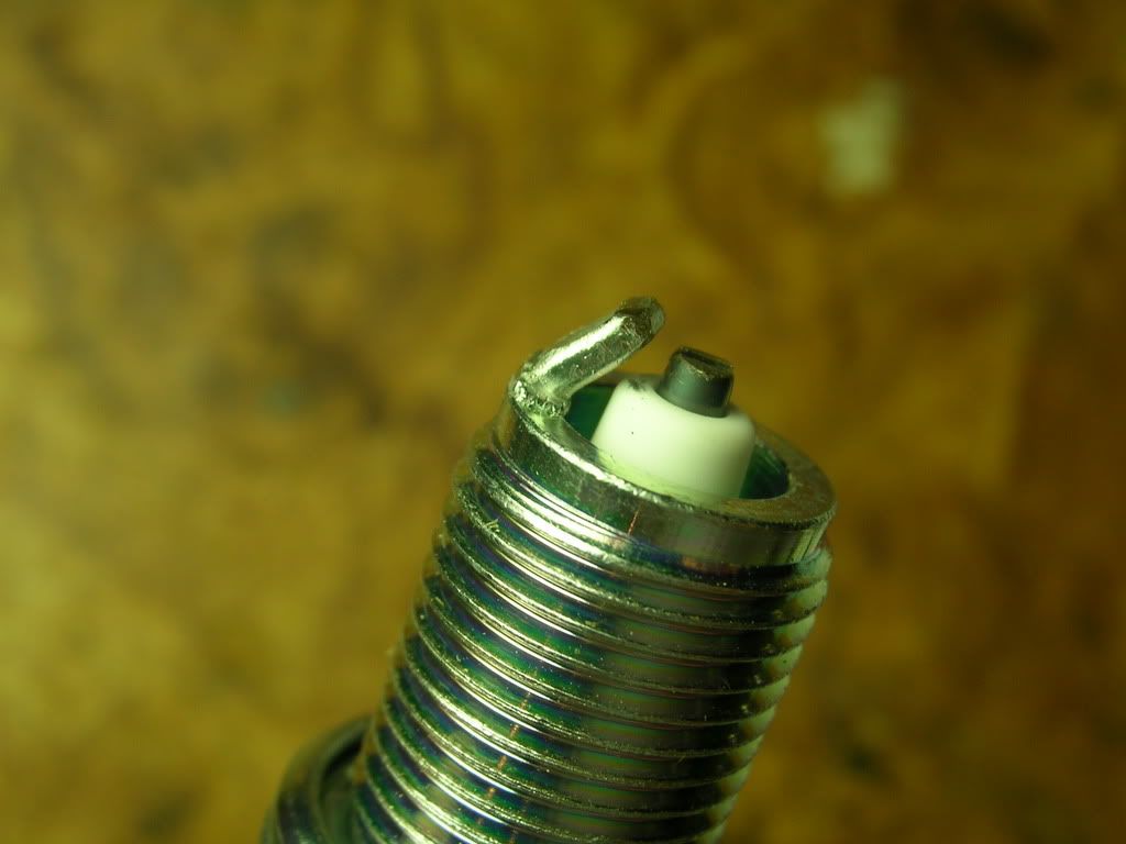

Just watch your plugs - if you see any damage to the tip of the ground strap, then cut them back. The problem is caused by the amount of metal sticking into the combustion chamber while spraying - the metal gets very hot and can glow from the extra heat, creating a glow plug inside each cylinder, causing preignition and possible engine damage. Cutting the ground strap back reduces the risk - and at 75-shot, probably not a problem for you. Everything you do to make more power makes the combustion chamber hotter, so you need to do what you can to reduce the heating.
I have melted all sorts of plugs, and even have an Iridium center-electrode plug that got so hot that the ground strap was completely blown away and the center electrode bent from the heat - and iridium melts somewhere around 6000* F ! Watch your plugs.
And have fun out there.

daaanngg! thanks crazy dude. yeah i'll definatly be watching the plugs. i figure when i go to the track again i'll try to check the plugs after each run just to make sure everything is in good order.
i haven't been able to check on this...but i'm guessing side gapped plugs really wouldn't hurt N/A performance right? same spark just less metal correct?
I've used side-gapped plugs for three years now - have some in the 3.5 now - and never noticed a bit of difference. Starts, drives just like stock. They won't last 40,000 miles without re-gapping them, but that's a small price to pay.
Something else - when spraying above a 50-shot, it's a good idea to gap your plugs down to .035 - at 150-shot gap to .030. At higher RPMs when spraying, you can have random misfires going on and you just go slower when that happens. This is due to the higher combustion pressures - makes it harder to make a spark, so you close the gap to make up for it.

ok i will try the side gap plug this weekend. just cut 1/8th inch above the electrode then bend it over?
yeah right now i've got one step colder plugs gapped to .035....i'm not as cool as you grey! i don't think i'll get near 150 shot....yet

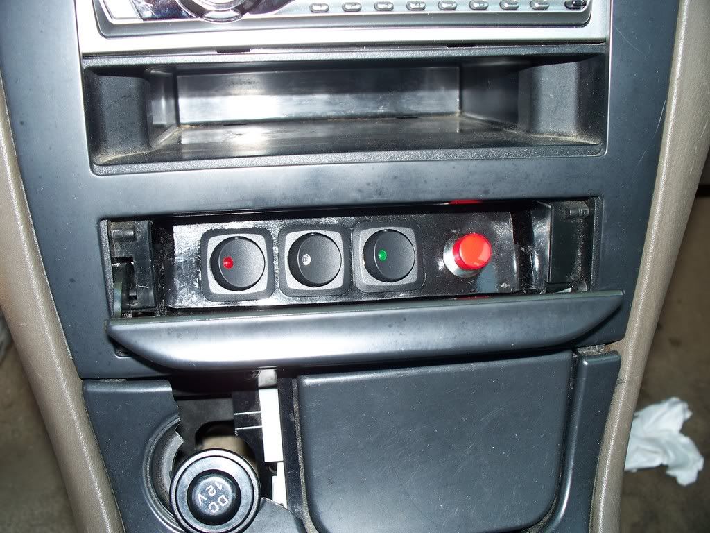

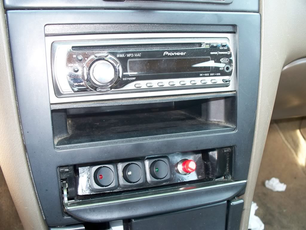

NICEEEEE INSTALL!! can u post what each button does on your panel. also, your running a WOT switch correct?
Old Jul 24, 2008 | 10:11 AM
one_fast_max's Avatar
Joined: Sep 2007
Posts: 535
From: Canton, MS

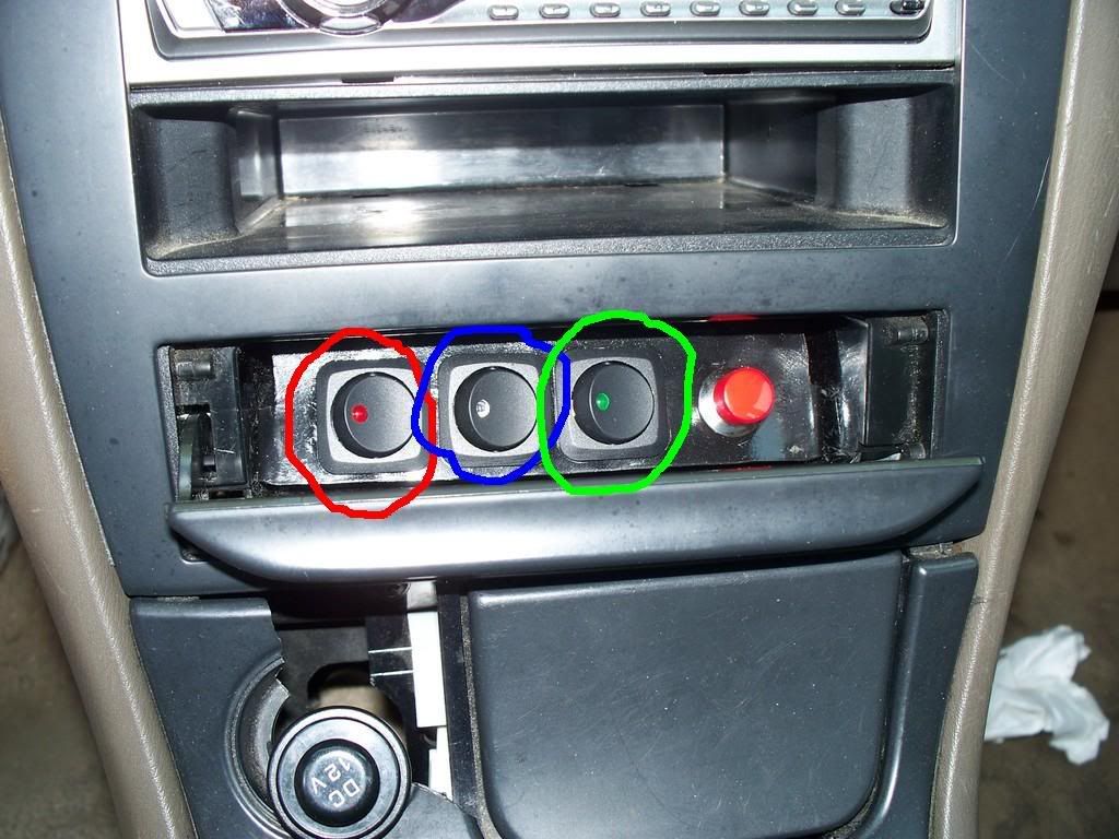

Thanks happy4444. yeah i'm using a WOT switch. i will try to get a picture of it soon. i had this nitrous ready to go on my old USIM but the i had some issues so i did an 00vi install. so then i had to make a new bracket for the 00vi. i'll try to get a pic soon.
yeah i wanted to use this tray for my switches just for stealth. i thought it turned out pretty decent....only thing is that there are 11 wires crammed in this tray so its a little tight. but i labeled them so if there's an issue it should be too bad. i actually made the bracket to hold the switches out of the metal casing of a broken 5 disc dvd player. i just drew out my pattern and cut it out with a dremel.
i circled the switches the color that why are then they light up. i need to adjust the blue one or something because at night at the track it shines REALLY bright right in my eyes! haha....so i have to turn everything on then close the lid....
1.the red one is for the heater.
2.the blue one is for the nitrous activation.
3.the green one is to send power to the push button purge switch. i didn't have to use it but i wanted to push more buttons haha.
