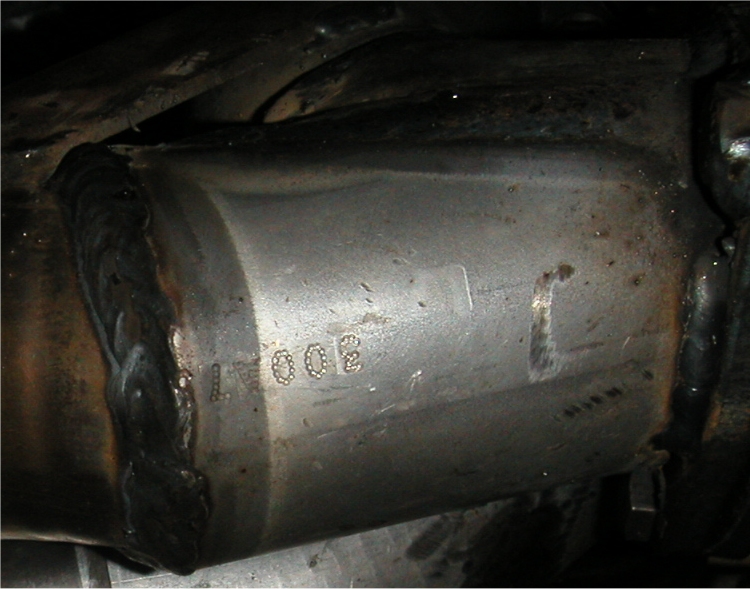

Wow Dixit, it's even better than the first time you showed me those pics. Such artistry as we discussed.

I mean its not only the point that it was a poorworkman ship job, but its kind of embarassing knowing that Im a person that buys quality things and everything on my car is quality installed and taken care of and looks like it represents who I am in that I put alot of work/effort into this car. Then I get turbo experts that look at this kit and think wtf is this? They ridicule me and make me feel like an idiot for even buying this kit. Im not saying thats anyone problems, its oviously my fault there. And then I also wonder why the gains suck, well its pretty evident why they suck then you got boost leaks, exhausts leaks from welds, and pipes are that jammed into others and created turbulence issues/air flow issues.

Right. Also the issue to me is not even the welds in that they were nastly looking. I actually at this point even though im a perfectionist wouldnt care if the weld bead was like a 1/2" thick bead and looked like jbweld put on it. As long as it held and worked, at this point I dont care. But the fact is it did NOT hold, more than 75% of them leaked because of poor workmanship, not costmetic/showmanship, WORKmanship.
Also the fact that people think all this R&D work was put into it, again take a look at the 3rd picture and tell me what R&D work was put in there? The person and probably HAL actually stuck a small 2" piece of 2.5" piping and jammed it into the mandrel bend, and since it didnt match, they cut slits into the bend, bent the slots, and then welded that down, and also it leaked. If anything Im going to showcase this piece cause to me, its artwork. Even I couldnt do that type of weld. Shiet... my 15yr experienced welder doesnt even know how to do that.

I still can't believe some of those pics in Dixit's photo album. I could make a better turbo kit with PVC and a hot glue gun.

I dont understand how you guys keep defending Hal when just by looking at the pictures of those welds, I would grab those pipes and smash Hal over the head with them. So he ONLY paid $4500 ? Damn, so little ? Do you guys have that kind of money to burn ? If I charged you guys 4500 bucks for a turbo kit, what would you expect ? THe POS that Dixit got ? I know he is a friend of yours... but his work is shady, at the least. I wouldnt spend 5 minutes defending this POS. He will get his at somepoint, since Dixit is not the only Org member he has screwed. It just bothers me that gusy I know personally, would defend a scumbag like this......

Had to replace every silicone couple due to the fact you hand cut everyone and left jagged cuts, and strangs hanging. Another small thing except cost me $200 in couplers. Used my PlaceRacing Midpipe cause I guess you wanted to cut a corner by not having to make an extra pipe to replace that pipe. Another cost there. Melted my O2 sensor plug harness cause instead of putting the O2 bung higher on the feed pipe for the front header you put it lower and then when the o2 sensor wouldnt reach you just took it off the holder and let it hang there with a wiretie. Well guess what, the back of the o2 plug harness is melted. http://bigdogjonx.com:81/fullpics/tu...n/Dsc00865.jpg This is now useless and have to buy a new sensor, plug, harness. What about my fairly mint condition Cattman Ypipe you hacked up and still dont admit to hacking it or even taking responsibility for hacking a pipe that I couldve sold for $300 at the time. That pipe useless. The ceramic coating I had to get on the feed pipe after I fixed it, why did I have to ceramic coat it? Why should you be responsible for that? Well since you took out my two stock Puller fans and replaced it with one POS fan as bags described, I constantly pushed H level temperatures. Had to pull over at times to let it cool down, had to roll down the windows and blast the heat all the other times in 90+degree weather. I put the 2nd fan in, and still same issue, why? Cause you ran the Feed pipe 1/2" from the radiator. The pipe gets so hot that it heat soaks the radiator to the point where the fans cant do shiet to help it. Had no choice but to ceramic coat it to solve the issue. And yes you sent me the exhaust wrap when you forgot to put it on, and yes I put that all over my feed pipe, and it did nothing for my overheating/hot temp issues.
All those costs occured to me because of YOUR NEGLIGENCE. Theres no denying that. No gray area, its Black and White in this case. Whos having to incur the costs? ME, same goes for bags.
