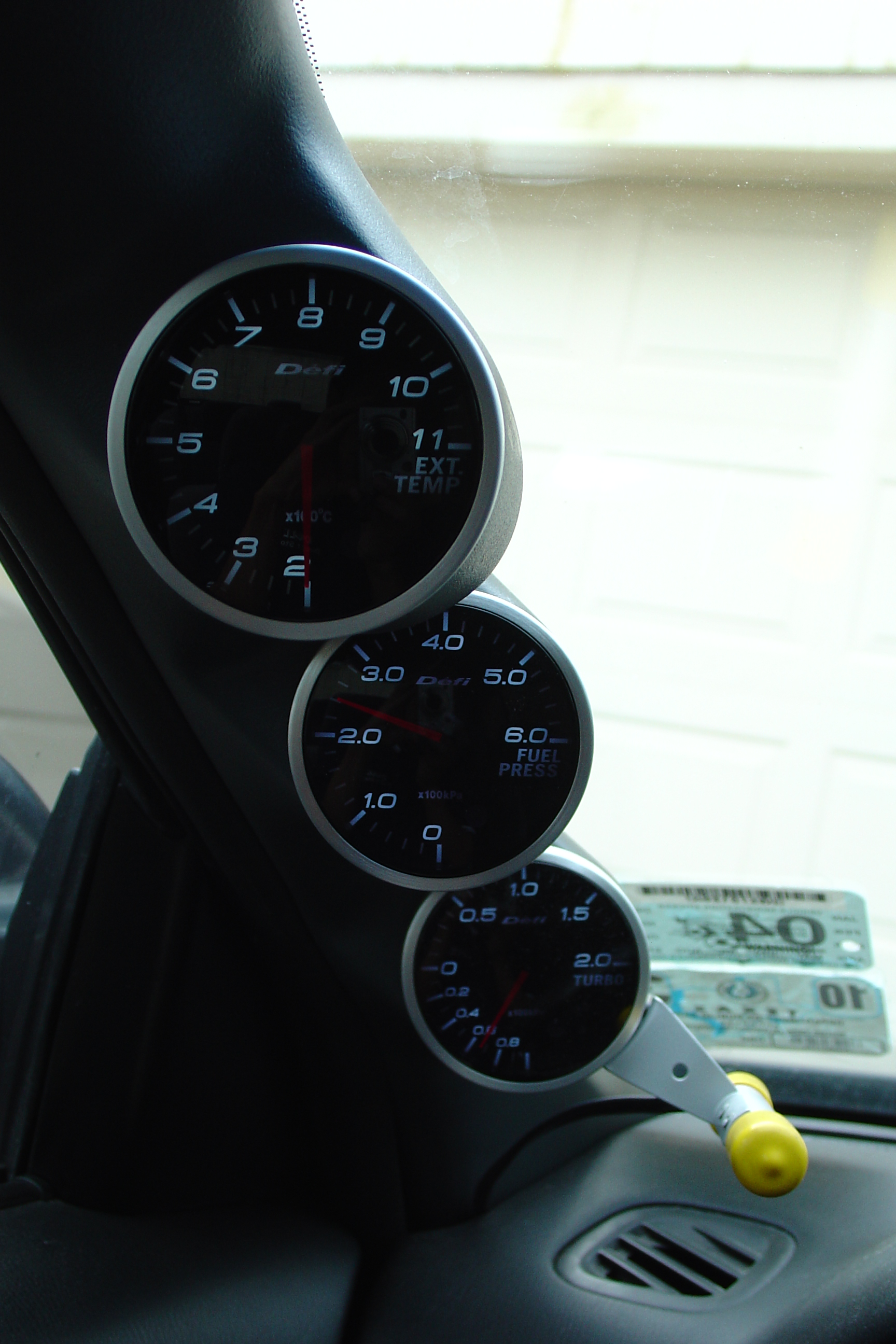

Hey Thomas, did you ever get any pictures of your gauge pod mounted? I am dying to see how it looks.

Old Nov 1, 2003 | 01:52 PM
sx7r's Avatar
iTrader: (15)
Joined: Aug 2000
Posts: 1,998
From: TX
big pic

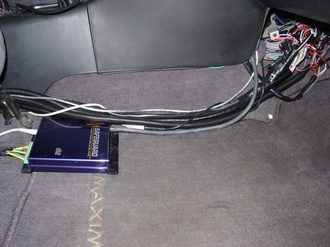

Posts: 1,998
From: TX
Originally Posted by JAY25
I believe he has a J&S. If he says stock everything, then his on stock internals.
bingo
think i have enough wires?
Old Nov 1, 2003 | 07:52 PM
JAY25's Avatar
iTrader: (38)
Posts: 6,451
From: Near Archer High School, Ga
Originally Posted by sx7r
bingo
Looks like Boscos floor mats when he had his maxima
Old Nov 1, 2003 | 07:54 PM
sx7r's Avatar
iTrader: (15)
Joined: Aug 2000
Posts: 1,998
From: TX
oddly enough, that's his old J&S
Old Nov 1, 2003 | 08:08 PM
BigDogJonx's Avatar
Joined: Mar 2001
Posts: 7,128
Thomas,
Thats a zoo of wires there......
Question, Since you got the eManage, what harnesses you using? I know you are using the MAF, Injectors, what else? Also does the injection harness work for our cars? if so, why not use that instead of the J&S?
Do you leave the J&S there or tuck it under the seat? Also why didnt you pull all the wires through the console and then under the seat? Is there not enough room in the console? Sorry if you think im critisizing your setup.
Dixit

sx7r's Avatar
iTrader: (15)
Joined: Aug 2000
Posts: 1,998
From: TX
Originally Posted by BigDogJonx
Thomas,
Dixit
i haven't been able to get the ignition control to work with the J&S. they work by themselves, but i can't have them both wired at the same time for some reason. Greddy has new firmware out that may fix the porblem so I'll try that. Until then, i'm running the J&S cuz i know that works.
the J&S is supposed to be under the seat. it's unbelievable how much stuff i have under my center console. the wires would probably fit, but i'd have to reorganize and rewire many electronics. i hate wiring. i'll fix it later.
