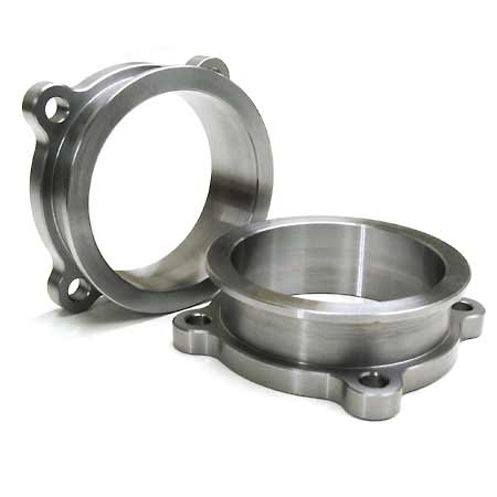

Here's the 3" V-band turbine adapter:
http://www.atpturbo.com/Merchant2/me...egory_Code=BCS

I guess it depends. The first pic w/ the v-band looks easier as it's tapered to the shape of the pipe. So cut hole, mount and weld.
The other ones are just flat. You would have to cut the pipe to fit that flat flange. With a saw, it would be a pain. Might be okay with a 4" cut off wheel. With a plasma cutter, everything is easy.
