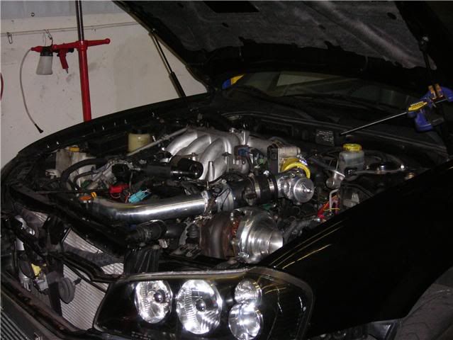

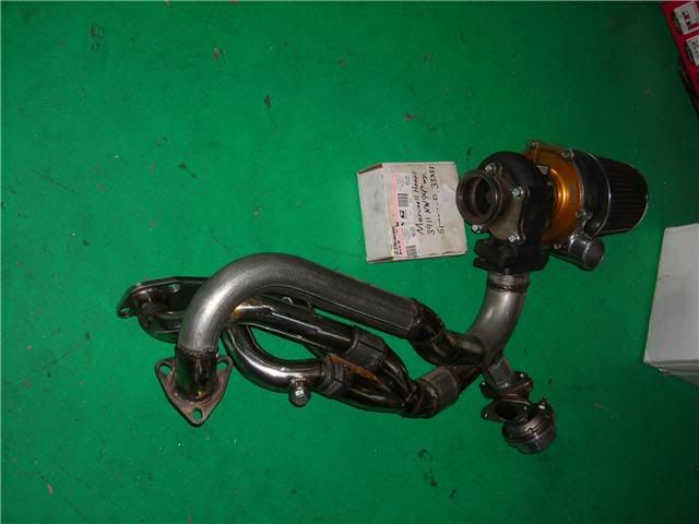

I started collecting and waiting for the right time to put everything together. the list as followed:
Turbonetics T3/T4 .63ar
Turbonetics evolution with 5lbs spring
BMPC intercooler 28x7x3
2.5 Custom mandrel bend piping
walbro 255
AEM FIC for tuning
obx headers cut and fabricated
glowshift boost gauge
cx raxing oil cooler
aeromotive fpr
custom fuel rail with -6 an fitting
fuel return upgrade
2.5 intercooler piping
coming soon:
deatschworks 440 injectors and dyno

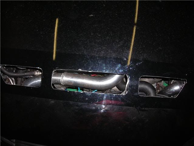

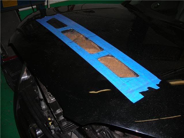

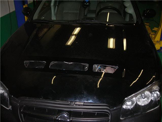

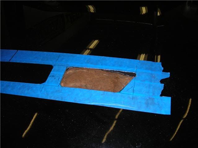

Looking good man, hope to see some vids soon. Question though, are you installing vents in the hood or just leaving those holes open? Is there bracing to hold up the turbo or is it just going to be held up by the pipes?
Old May 6, 2009 | 06:53 PM
stillpimpin's Avatar
Posts: 100
From: sunrise
I put mesh grill and door lining i'll put a final pic of the vents 2morrow, and no brace for turbo its safely secured by the feed and down pipe.

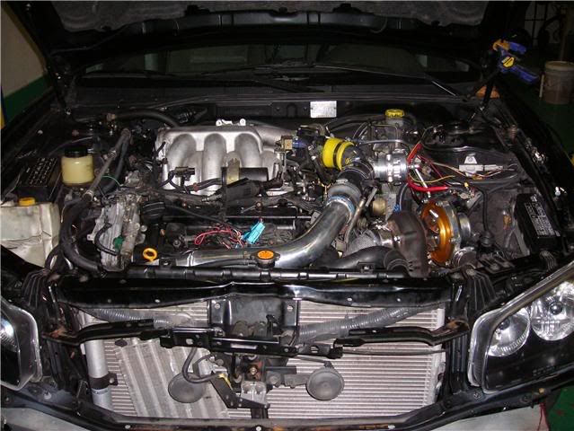

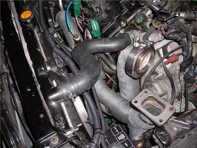

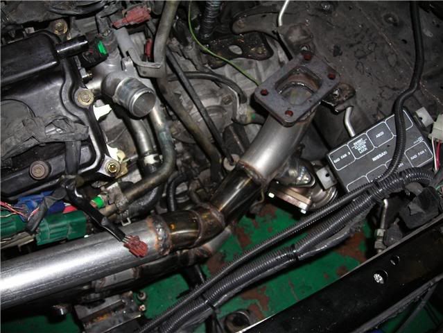

any pics of the piping from the rear header into the feed pipe? And the front mount was modified?
Also your bov is in the wrong location. It needs to be before the maf
Old May 7, 2009 | 09:38 AM
Posts: 100
From: sunrise
the rear header is just the OBX back header and and if you look at the front header it connects goining to the turbo, yes i did have to cut about an inch and a half of the bumper support for the intercooler, I have'nt had any problems with the location of the bov. with the FIC it works just fine.

looks good, is the exhaust 2.5"? if so, why didnt you go 3"?

it was more money and I didnt have it at the time but will upgrade as soon as I get a chance

I heard you cry and moan about my cousin VR4s hood ?

LMAO... Yea it looks good do u mind if I promote them, you kno hood vents

that is a very compact looking setup. so the wastegate is dumping right into the exhaust, are all you turbo guys doing that? or are some people dumping to the atmosphere
some dump in the atmosphere but the cops tend to ask a lot of question about sound and smoke so I didnt want the hassle so we recirculated it back into the exhaust, some cops act like a$$hole( even though im tryin to be one) when they dont know what is under the car.
