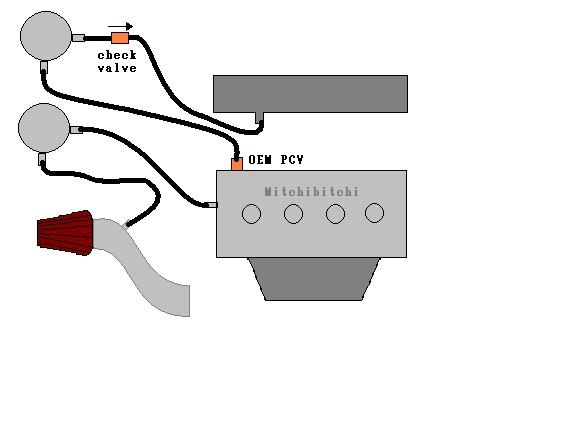

As for my blow-by issues, I found this diagram online regarding boosted applications. My setup currently is like I said I just have the stock PCV hooked up with a catch-can inline and a brake booster check valve in there to keep from pressurizing the catch can or crank case. My setup right now is exactly like the 4 cylinder example below minus the extra catch can routed back to pre-turbo. At this point I'm thinking of just adding the extra catch can like the example below. Thoughts?

That setup will not work on a blow through maf setup, if your pull through then the front needs to be connected before the turbo

Oh, duh, the valve cover breather would need to see metered air. That's why you say it wouldn't work for me since I'm blow-through, correct?
Well in that case then I don't have any good options really other than just running to a vented catch can for the valve cover breather
just let the front vc vent and put a check between the pvc and intake or remove the pvc and let the front and rear vent to a oil breather
That's exactly how it's setup currently (except I have a catch-can inline)
Unfortunately at this point it looks like the rings or something must be bad
