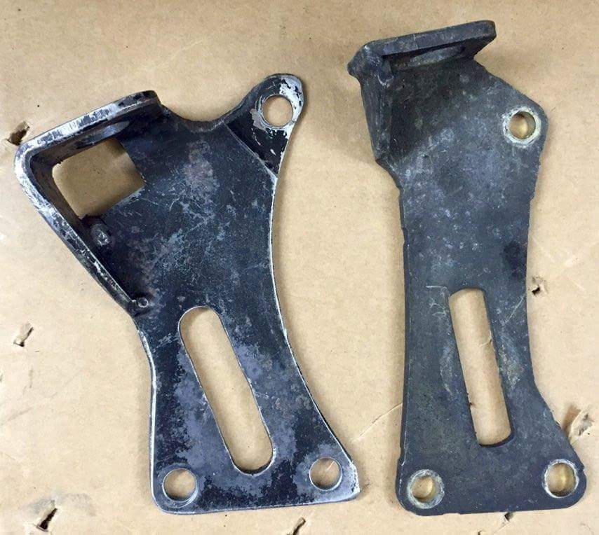

As most already know the Stillen S/C kit is no longer produced and so are the misc parts to install.
Im looking for a V2 tensioner bracket and pulley for a V2 S/C Kit. Its like looking for a needle in a hay stack.
So I'm hoping I can maybe modify the OEM tensioner but I need a pic of the Stillen tensioner bracket to get a idea of how it would look.
Only pics I found online was from the actual V2 S/C installation instructions but it was installed on the motor.
If anyone has a V2 kit not installed and could snap a few pics of the bracket itself with out the adjust rod, washer, spacer and pulley that would be awesome.
Thanks
OEM Tensioner Bracket
V2 Plate, V2 Tensioner Bracket and Custom metal pulleys.
Pic from original Stillen V2 install instructions.

I was able to find this pic which is exactly what I need.
I went to the jy to grab a stock tensioner bracket to compare and see if i can come up with something if all other options fail.
Old Jun 1, 2017 | 05:12 PM
vingodine's Avatar
Joined: Feb 2015
Posts: 53
From: California
And a side by side pic i found of the modified (left), and OEM unmodified (right)
