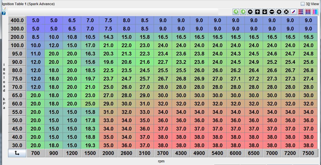

Hi,
I am running my boosted VQ35de on a MS3Pro. About to do some tuning, and wanted to make sure my target AFR table was correct. Also hoping for some advice on ignition and cam timing (obviously 0.0 is not right!) table.
Current tables attached.
Thanks!

Way late on this one, cant you pull the base values from nisprog/romraider base maps?
