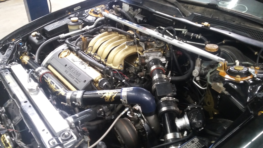

Where I left off my last thread was the car was all put together and life was good.
My engine is completely happy and pretty, my new turbo was spooling and making life wonderful... life generally is good...
and then... I got an idea.
(Disclaimer, I actually was given the idea, I don't claim to be a master mechanic, or even a particularly good one, my skill set lies in the detailing and customizing of engine bays, interiors and so on, not advanced engine set up)
Here are some pics just for a point of reference.

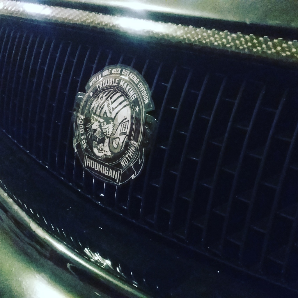

I also added all the carbon fiber stuff chris cruz sent me. Easy peasy with some body mounting tape from 3m
thats the cf grille, but instead of a nissan badge i slapped a hoonigan sticker on it, because I wanted to and I like it.
