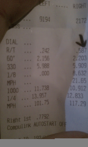

So as I mentioned on my dyno thread, i was giving up completely on the car, but I was inspired to go to the track anyway, even with the misfire I have. For those that know my setup, I depend on the nitrous for the 60', however I did not take the nitrous thinking that I wouldnt pass inspection (since I didnt have a fitting for the blowdown tube), turns out they didnt even pop the hood . So the runs were only turbo.
The first run sucked big time, I launched from idle and it was about a 13.4 at 114, 2.3 60'
The next run I brake torqued a bit and got 13.0 at 116 2.24 60'
Then the best run was a 12.8 at 117mph, and still 2.2 60'
So I made big improvements between runs, was tuning a bit the very 1st run was very rich, low 10s and some 9s. Leaned it out, probably raised boost a click or two. Max boost was 16psi, first gear the highest boost i saw was 3psi towards redline
Conclusion, this big ol turbine housing is killing me with the lag, next time I go and spray the whole 1st gear, also the misfire is hurting me real bad, in this video you can hear it misses down the whole track:
http://www.youtube.com/watch?v=AHo_SqNi6ek (listen to the exhaust note how it hicups crap load of times till the end)

Because I have spent months doing things to see if the misfire goes away and nothing helps. Only thing left to do is change ECU, Crank and cam sensors.

Neal: yeah man I was expecting to beat my PB but was also wanting some low 12s maybe an 11, not happening with this lag and no nitrous.
t6378tp, ajcool2: You guys kept busting my ***** about going to the track so there you go lol. Yea a few people told me it was quick but not a whole lot of attention, it was mostly domestics and fast ones too(so they dont care about a slow import lol), but I did have better trap speed than most mustangs out there, some guys were doing 11s with my same trap speed more or less, its all about the launch and first 8th that makes a big difference, after that my car is hawling.
Stillen Maxima: Alvaro mentioned you had a similar issue, right now I just swapped out the crank pos sensor (the one at the crank pulley) with another I had, also reduced the gap from .030 to .035 and still misses. Gotta find another sensor to swap for the one at the tranny(signal plate), then the cam pos sensor. If that dont work, then change ECU, if that dont work then im done.

My slicks are mounted on 15" sawblades which weigh about 17lb or so (the SE rims are my daily, notice on the vid the fronts are not SE rims), I like the 24.5" because it dosnt put me too low to the ground, my car is low and charge pipe will rub (i used to scrape it on 22" slicks), another reason I like these slick size is because it allows me to cross the finish line in 3rd gear, I really dislike having to shift into 4th. I think the 24.5 are fine for my setup, I also run with an unlocked auto so gearing is slightly shorter.
Well the problem with the turbo is the turbine housing (18cm^2 which is about 1.00A/R i think), it came with it so thats what I stayed with, for $250 you cant beat it, im not going to spend $600+ on finding the perfect size turbo.
Iv checked every wire and cant find anything, ran new grounds, done everything, coils are new and have swapped with two other sets i have, going to swap crank sensors as last try.
Without nitrous or a higher stall converter theres no way im going to spool the turbo, not even if i lean it out. Actually the AFR in 1st gear is already pretty lean and still got nothing, I was successful with nitrous with the turbo 3.0L, I was doing 8.6sec 1/8th with 100hp less than what I have now, and that was only with a small 35shot spraying upto 3500 rpm. Right now without the nitrous im doing the same 8.6sec so with the nitrous I should easily get into the high 7, and mid 11s in the 1/4.
