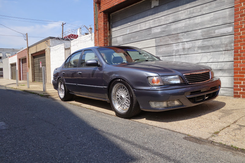

Here's my ride height. I do run taller tires (225/50/18)
My question to you guys is.. have axle vibes done the same for others at the track?
Any other ideas?
