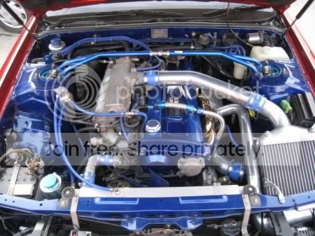

Old Mar 30, 2011 | 09:52 AM
  #63
LeX's Avatar
LeX
Nissan by Nature
iTrader: (14)
Joined: Apr 2002
Posts: 4,181
From: ATL
Originally Posted by Chevsica
I am surprised nobody asked.
How about some pics of that engine installed?
Old Mar 30, 2011 | 06:01 PM
  #64
Chevsica's Avatar
Joined: Mar 2011
From: Perkins, Ok
Great job on the install! Looks like it belongs there!!
