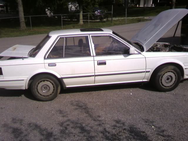

this is my project car. no rust i have found, only 1 dent from someone sitting on hood. worth the $150 i thinkName:  maxima640x480.jpg

Wow...that actually looks like a pretty clean body. How's the interior?

Interior leaves something to be desired. The previous owner left the door open while out of town for a week and their dog ate the door panels and rear seat. I plan on custom interior though so it no big deal.

Well weather permitting the engine may be out tomorrow. Then i'm doing a tear down to see what the condition of such a high mileage motor is. Has anyone ever torn down a vg30 with close to 400,000 on it?

Ok engine almost out but i'm having a problem with the torque converter. There are only 3 bolts holding it to the flexplate, right? I ask because the converter is trying to come out with the engine and thas is an obvious problem. Anyone who has an idea to what's causing this please feel free to post away
Old Aug 18, 2012 | 03:31 PM
maximo018's Avatar
Joined: Jan 2007
Posts: 2,260
From: Houston/Missouri City
You'll have to spin the converter until each bolt (one by one) lines up at the bottom for you to unbolt them. Once thats done it should be free. Oh and usually its bolted to the flywheel instead of the flexplate cuz it spins.
