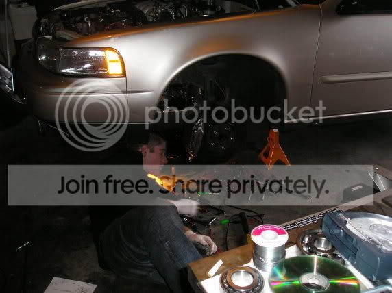

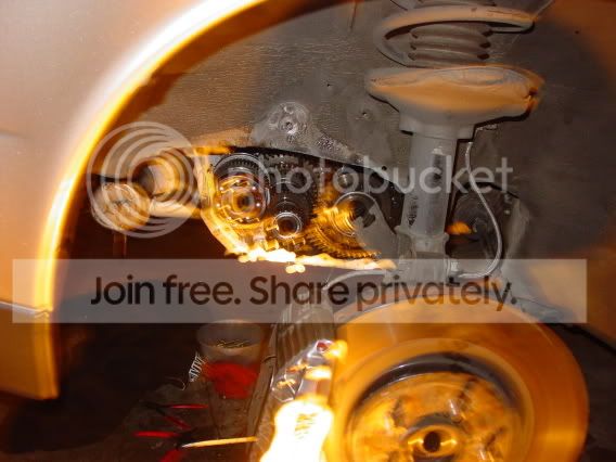

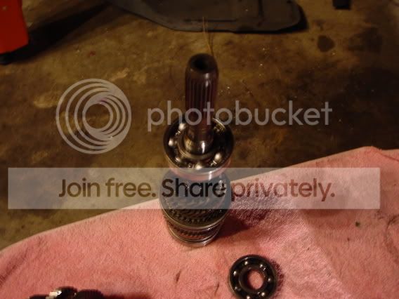

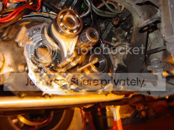

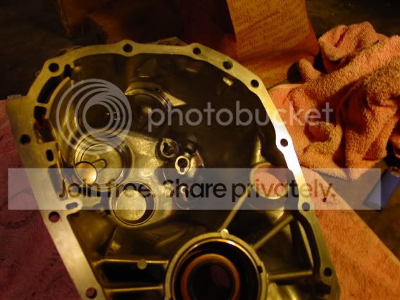

I have a few pics but they kinda suck because the lighting in my garage wasn't very good and I wasn't too familiar with the camera.
This is when I did my tranny. It was a few days after I rebuilt the other one... (It took me a whole day because I cleaned the tranny casing inside and out)

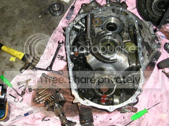

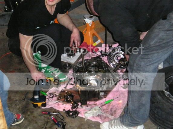

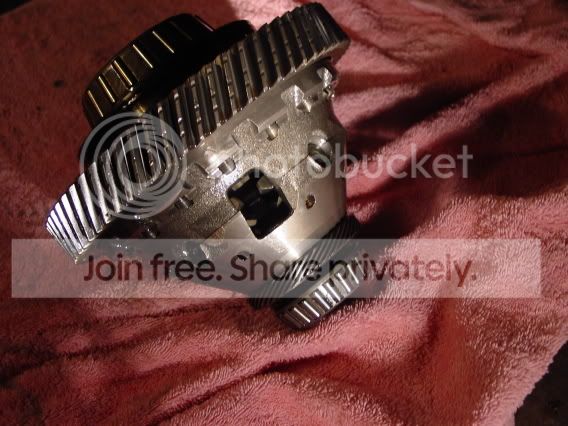

Here's the one that a firend and I rebuilt while it was out of the car....It was my first time taking it apart....My friend did most of the work....He left out the the check ball pin (it sits in the 3rd-4th shift rod) when he put it back together. The car drove fine for about a week and then it got stuck in two gears at once (reverse and 2nd) while it was parked. I had to take it apart two other times (while it was on the car) to figure out what was wrong. I finally fixed it by making my own check ball pin and it works great now...

ouch, my back hurts just looking at those last 2. i tried to work on mine while it was on the floor but within a minute decided it was worth it to clean off the workbench looks like a somewhat of a pain without a lift (laying on the ground), but i guess it's easier than struggling to get all the engine to tranny bolts! especially with the rh axle installed which makes a few of them a lot trickier. good to see the final drive can sit in place vertically like that. nice shortcut and pics there..

First of all you don't need to heat up any of the bearings to remove them. Second, I would only replace the front input shaft bearing, the others should be fine, just inspect them.
You can buy a 12 ton press at harbor freight for about $60-$80 and do the whole job yourself. You'll probably want some pick (hook) tools, some punches, some snap ring pliers, and you'll need some magnet tools. Just follow the FSM and don't be scared. BTW I'm only 20 yrs old and I didn't have any experience with this type of stuff either.
The last picture was very unorganized because it was the first time I took it apart. The next tranny job (on the gold car, Jeffy's old car) went much smoother and was much more organized. I even installed the input shaft, main shaft and the VLSD (differential) all by myself (while the bell housing was on the car). All of them have to fit perfectly because I didn't even remove th passenger side axle.
I don't remember the name of the website that selles the rebuild kits (I think it's like drivetrains.com or something like that). Send subs1000w a pm, he'll know the name of the website.
