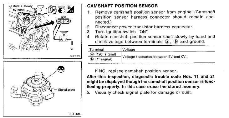

Camshaft position sensor can be tested:

yeah . sensor is good.. at the price of the coils it looks like id do better by replacing th complete engine. a place not far from me has one for less than double the price of the coils. but other than the coils what else could be causing the engine to shake. fuel pressure regulator fuel pump. cia. i dont know. i seems as though it has to struggle to idle but when it gets there its fine. go wot and when its released it will drop low (200rpm) and regain or die. might shake might not. give gas gradually and it will shake everytime. whole engine

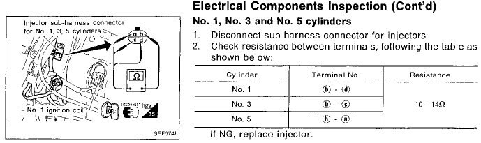

Old Jun 30, 2007 | 07:24 PM

You've checked the injectors then?

havnt had a chance to get the meter to them. car is still running rich and smoke is now a light white. i did have the harness unplugged and that made a big difference. now when i give it gas and it goes back 2 idle it drops low(300-500) then returns. sometimes it begins to search. keeps going up and down
