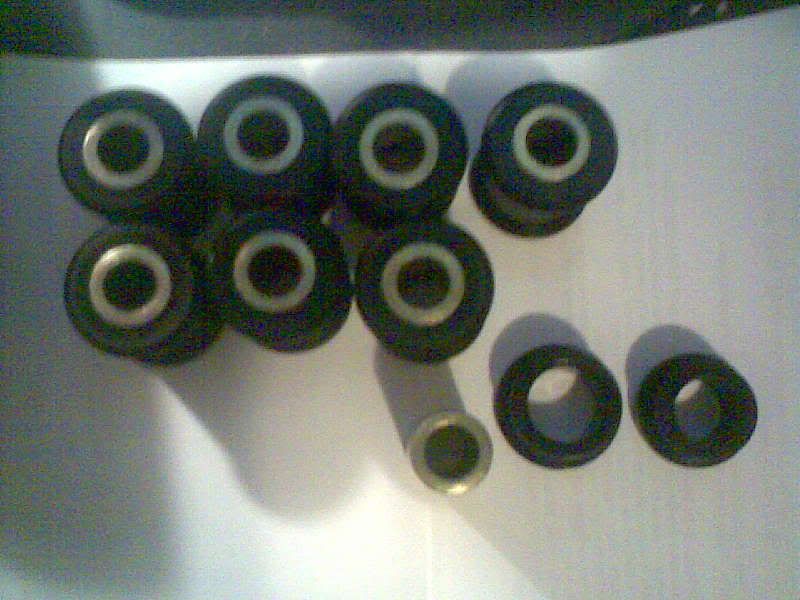

So I got my bushings today and got all excited that I was gonna do em this weekend but guess what, please tell me its not a mistake and this is ok. One of the bushings is smaller than all 15. heres a pic.

[IMG]http://i24.photobucket.com/albums/c42/ColombianMax/ES.jpg[IMG]
It is a mistake,and it's not ok...contact them..

nope.. they fooked you man. they should all be the same size.
.... and there's no washers in there either.. shoulda been washers. ES likes to forget them on a regular basis.

404 error: washers not found...go to the hardware store and spend $.37 or whatever on some washers...it's a safety issue and I'm surprised someone hasn't tried to sue ES over it at some point or another...I was mid-way through a shrinking-radius turn at about 80mph when one of my bushings decided to "step up" over the ledge on the parallel link. It resulted in snap-oversteer and it was all I could do to keep the car in control with the suspension loaded like that...Needless to say I added washers to the setup the next day...I think I even posted a thread about it...

I will be making a call later during the day to demand the right bushing AND the washers. I'm not gonna go spend damn .37 cents when they shoud've been included

John,i have an extra poly bushing from my kit,i'lll be glad to throw it in an envelope for you..
Then you can just stop by the hardware store and pick up some washers..

Ok, so I got everything done. wire brushed on grinding wheel, sandblasted, rust-o-leomed links and 'crossmember' aka subframe. Paint came out ok cuz the weather didnt help cold + rain
Bushings did definately make ride more solid feeling like as in new car solid. Quieter and less clunky in the rear.
Thanks for the idea Wayne!!

Alright guys, after noticing such improvement with poly bushings I've been looking around for others to replace but havent found much.
Dont know if this has been known or not but for other fellow noobs, I just did a bit of research and found out through Courtesypart.com that:
3rd gen front swaybar to frame bushing part number is: 54613
4th gen front swaybar to frame bushing part number isL 54613
ES's part number for frontswaybar to frame bushing part number is 7.5118 which I believe will fit our cars
On Energysuspension.com there's no listing for 3rd gens whatsoever but they're the same.
Let me know if this is already something known I was unaware of...
