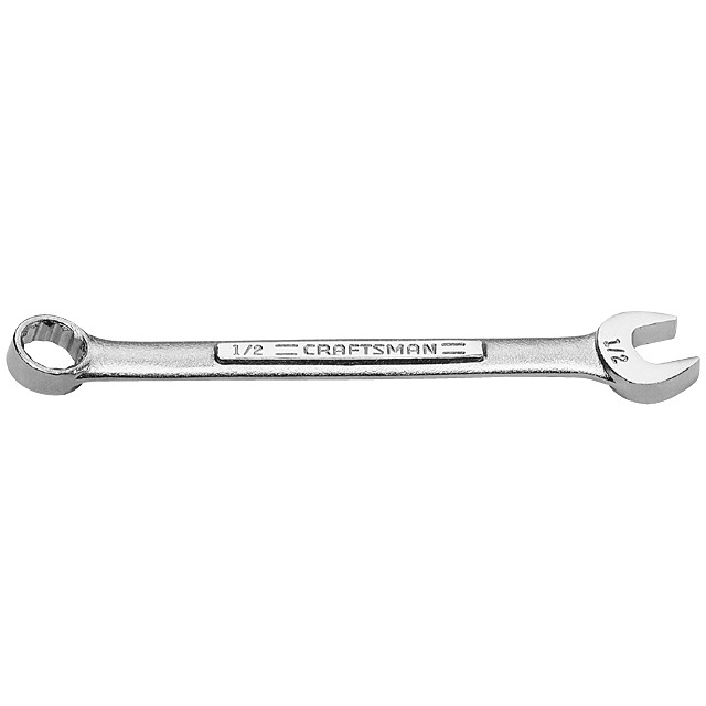

dog bone = box?

Originally Posted by benstoked
dog bone = box?

Sorry, I meant a COMBINATION WRENCH. A lot of my buddys calls these dog bones.
You want a combination because you'll find the open end is easier to use when the bolt/nut is really close to the upper spring seat.

lol, I had always heard of them being called box wrenches.
i heard dogbone, and saw what wayne posted.
anywho, I agree with that. use a combination rench
