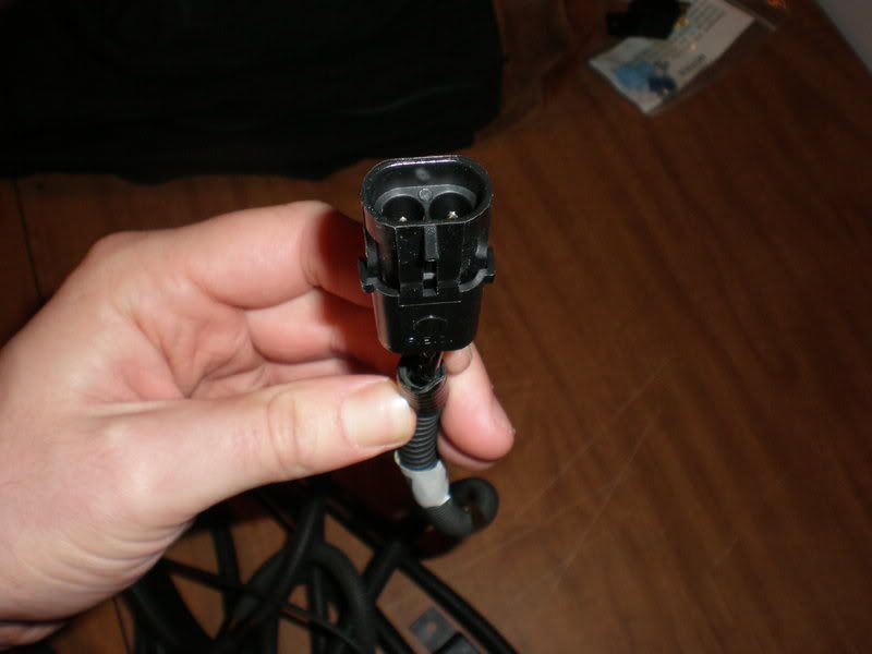

Here's the lamp (obviously there's 2 of them):
The lamps plug into these (2) connectors on the wiring harness:

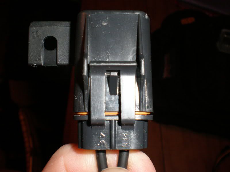

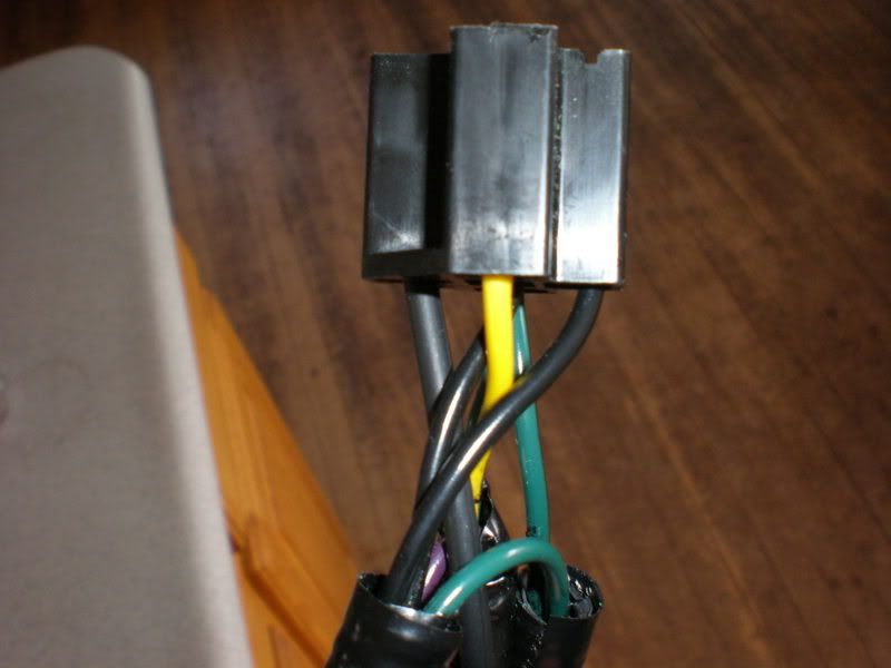

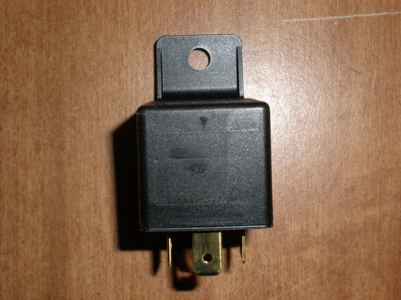

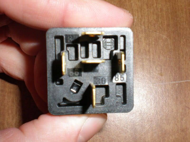

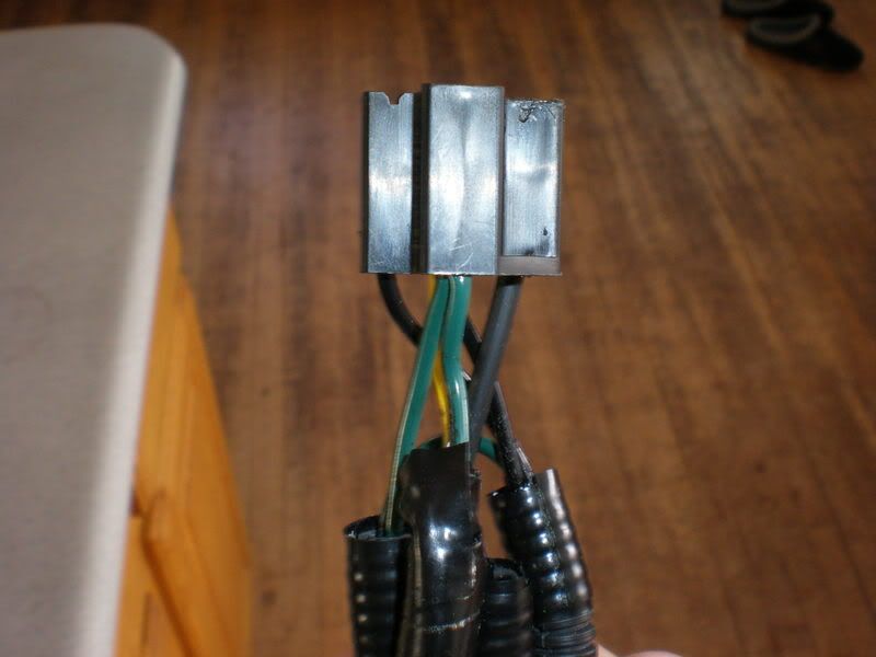

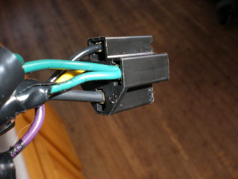

Then there's this plug and this relay that plugs into it:

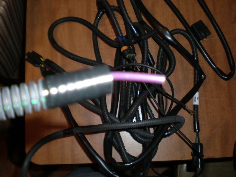

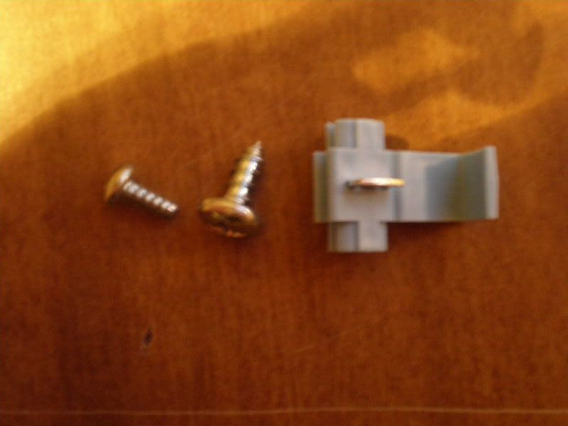

Then we've got this connector which must be to attach this purple wire to something, but what?

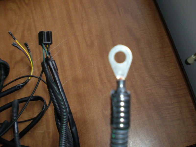

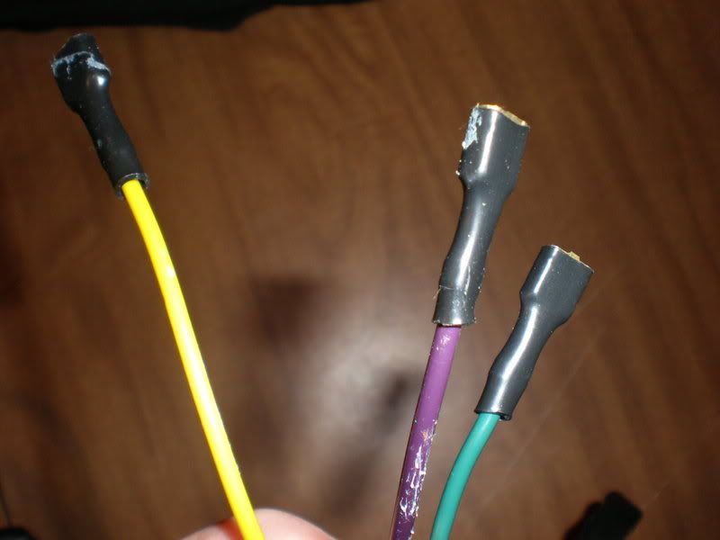

Then there's these 3 wires with connectors on the end:

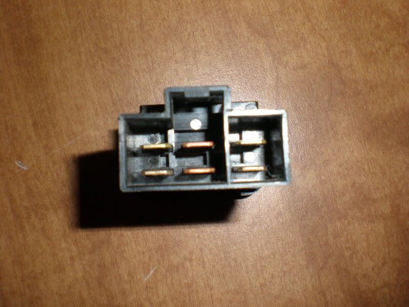

Which (possibly?) should be connected to the back of the dash switch:

Then there's a blue relay I'm missing from the fuse box in the engine bay:
So I guess there's 2 relays involved in this setup (both pictured)...BTW, if you have an extra blue relay, I need it!

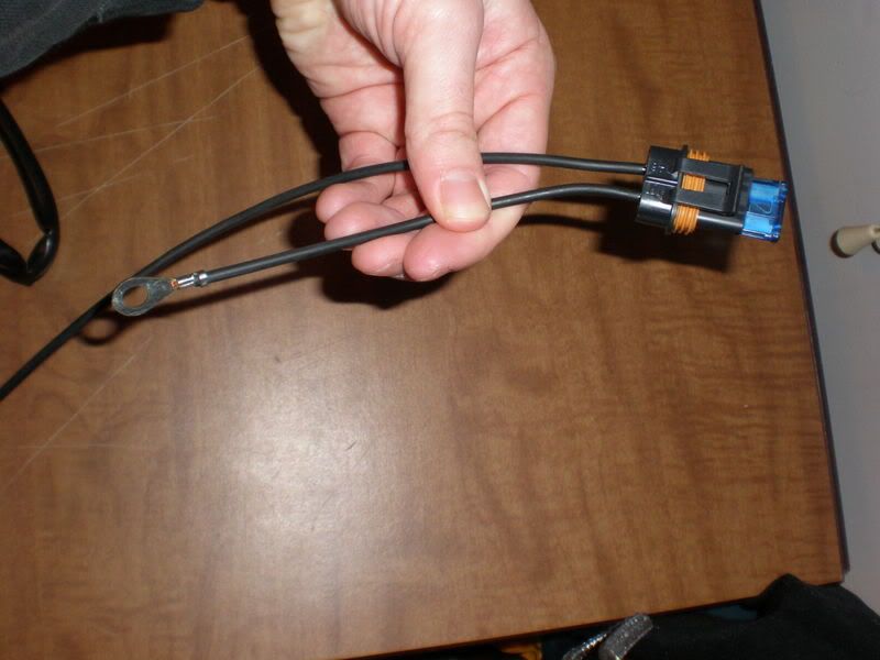

Oh, and there's also this, which I'm assuming gets connected to the positive battery terminal for power:
So if you can tell me where to connect those wires to or have any other knowledge or insight, let's here it!

okay, you say the car has no wiring for it. did the fog switch come off your car, or did you get it seperate?.
second, the fuse with the "ground," usually, (from what ive seen) the positive is fused, but could be wrong.
is this supposed to be half Q and A, half write up?
edit: can you post a picture of the wiring from the relay? or at least colors for the terminals?

can somebody post a pin out of the fog switch?
edit: never mind, its in the fsm

id still like to see the relay wiring, accompanied by the relay as it would be installed.
then i think i can write it out.
my concern is the green wire going to the switch. if i can figger it out, i think i got it.
edit:also the color of the terminal in the last picture.

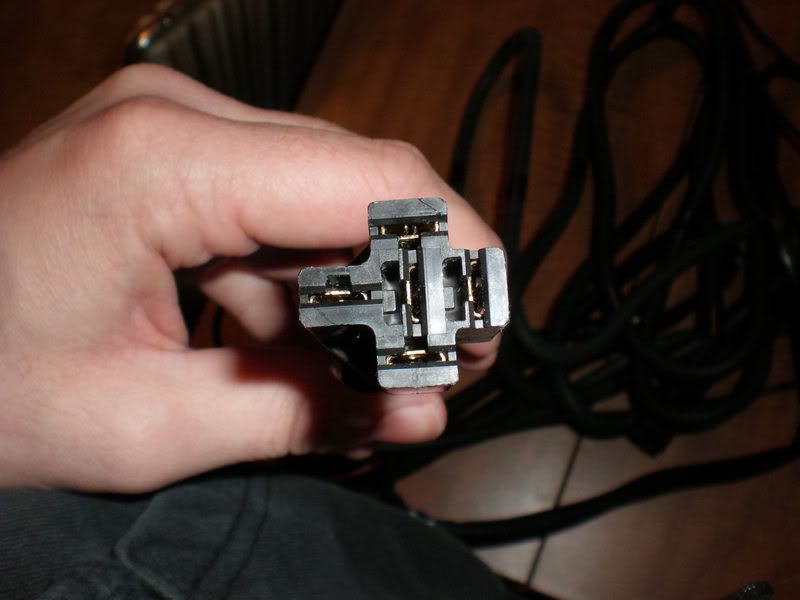

Pics of harness:
And the terminal pictured in the previous post has 2 green wires goin into it.

based on what i can tell, the green to the switch doesn't do anything, as shown:/. it could be used to light the switch, but i dont know...
im gonna throw this on here, see if its right.
as a suggestion, "wire" it up using a good battery first to check my connections.
1.) run wiring to appropriate locations, with
. a.) the switch wiring to the switch location,
. b.) the light wiring to the appropriate lamp locations,
. c.) the battery terminal to the battery (do not connect, yet),
. d.) the ground terminal to an appropriate grounding location.
2.) install the fog switch into dash. the stock location on my '91 se is the spot closest to the door.
3.) connect the switch with the following wires.(ignore colors from pic...)
. a.) green to 6
. b.) yellow to pin 2
. c.) purple to pin 1
4.) install the relay into the harness and secure into a suitable location.
5.) connect the single purple to a location such as the main radio power for power when on (acc) or (run), or to the running lamp wiring, so the lights come on with the running lights.
6.) install lamps into proper locations, and connect them.
7.) connect the battery cable and test.
please post results.

I'm thinking the black relay on the wiring harness takes the place of the blue one in the fuse box...What do you think?
