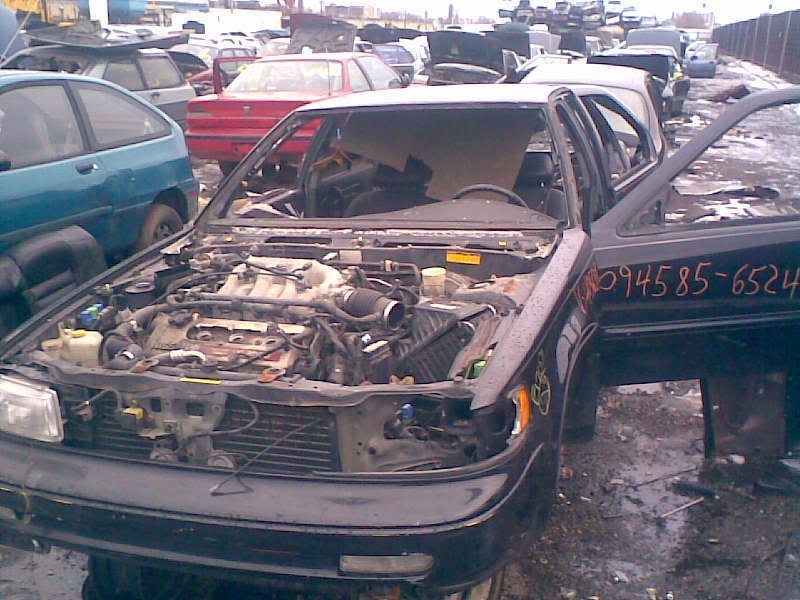

Yea that pic should go in your Pwnaful VE thread shouldn't it!? SHOULDN'T IT?
I saw that VE when it first came into the JY, before anyone picked anything from it in the "closed to the public" section and man it was beautiful inside and out, wasnt crashed either...no rust BLACK on BLACK real shame it ended the way it is now...I wanted those sexy door panes with leather inserts but some **** ripped em apart for the blose
I hear you on that one man. There have been many times when I would go out part-hunting for my old 92 GXE to find many other 92s abused in the same fashion; parts that you want/need are always screwed up by other inconsiderate slobs who go in with whatever tool they can and beat the part they want out of the frame...damn shame it is...
