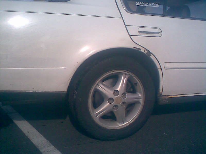

Alright so I have 2 pics I took with my cell here they are...before and after
Pardon the rust and body damage, it should be gone soon (yay)
BEFORE (notice how much gap between rotor and inside of rim)
AFTER (notice how smaller that gap got )
