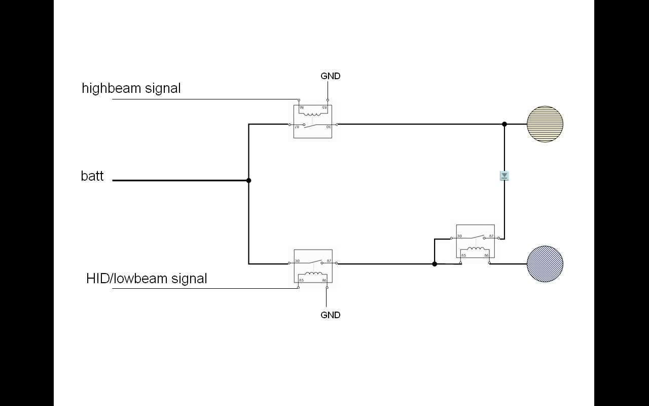

Just recently i have seached the org to find out how to get the lo-beam to stay on with the hi-beam and there are two methods that can be done here Either a Diode (IN5404) , Or a relay setup.
this is what i came up with. is your idea simpler?
one of these days i'll modify the picture to show left and right. I would move a few things around (like the relay/diode combo would be behind the other 2 relays and the other 2 relays would have 2 poles instead of 1)
