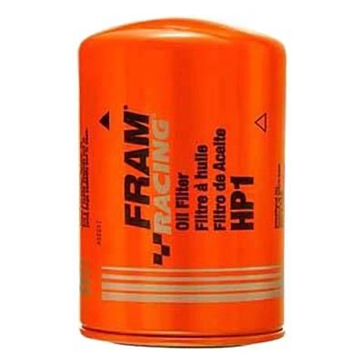

i'll take pics of my set up when i get home tonight.
here's the basic set up...
this is hooked up from the tranny cooler lines.
it's a oil filter adapter with t-stat. when the atf is cold it will just filter and not flow any fluid to the cooler. once the oil (ATF in this case) warms up the fluid will start taking a run to the cooler after the filter and then goes back into the tranny. the cooler is a B&M stack plate cooler. the stack plate will allow fluid to go into part of the cooler when it's cold and when the fluid warms up it will then flow into the rest of the cooler. i used a pretty big cooler since i have the t-stat so no more over cooling. all of the plumbing are running AN lines and some hard alum lines.
i'm using Fram racing or the K&N filter on it. it's a 1qt filter to help with cooling and filtering.
the first time the filter goes on you'll need to change the filter within 1000 miles and the filter is going to be real heavy. after a few filter changes you can swap filters every 5000 to 6000 depends on how rough are you on the tranny.
when my tranny finally worn out the rebuilder noted that the fluid was perfectly clean but the age of the tranny it was just worn out...but he did say the fluid was really good....so good that he never seen it so clean.

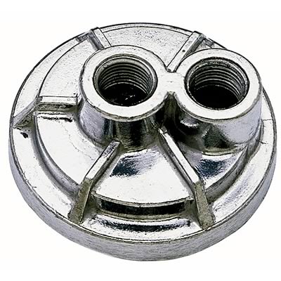

That sandwich adapter is for a engine oil filter base not a transmission, it actually fits between the oil filter and the engine block (that's why it's call a sandwich adapter). This is what you need either the Standard kit (10678) or the deluxe kit (10677) from Perma -Cool (www.perma-cool.com)

ok i looked at my set up again...you're right...
you need to set up a remote filter head...then sandwich the mocal oil adapter on it. once that's done you spin your oil filter on the sandwich adapter and you should be good.

Take this...(two ports comes from/to your tranny)
throw this under it....(two ports comes from/to your tranny cooler)
cooler ---->
then spin the filter on it....
add hoses and line fittings.
