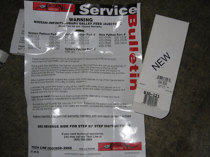

I tried python / venom injectors for my '89 Max GXE and found two of the six they delivered were total crap, basically pissing fuel and not shutting off.
If you go with them, be sure to test them before installing them and plan exchanging the faulty ones.
Here were the ones I bought:
Part number 630-121
If anyone wants to buy them (there are four good ones, maybe five at the most IIRC) let me know and I'll make you a deal.
I managed to get good used original injectors up and running as good as new, by scrapeing the layer of corrosion off the copper electrical terminals. (bringing their color from a dull brown to a shiney bight copper color.)
