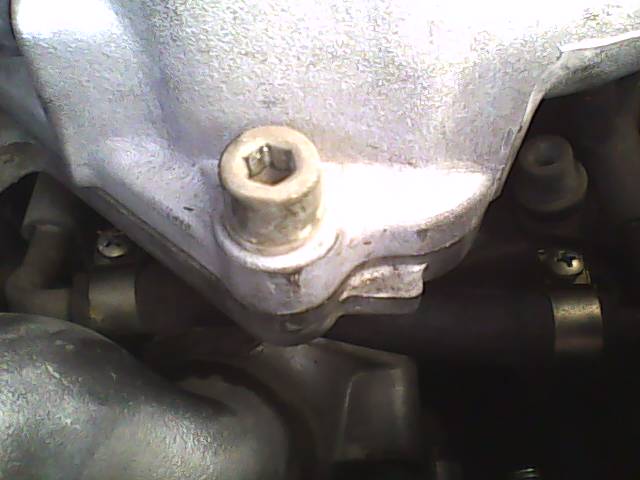

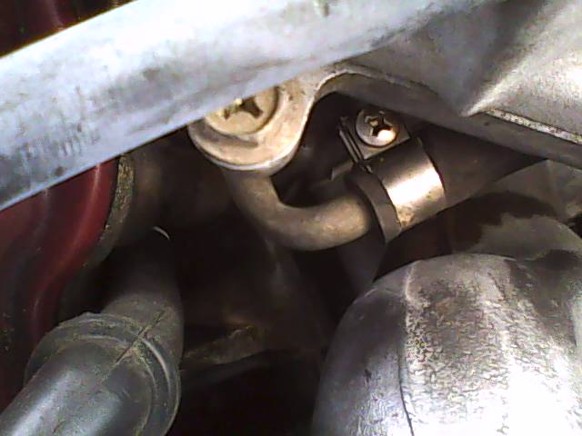

Ok, During my lunch time I work a little bit on my car and I noticed a strong smell of gas, so I start moving the rear injectors line one by one and all of them as I moved one by one it change the idle of the car, I can hear the engine lowering rpm's as I moved the plug of each injector.... then... voila..
I spot a leak of gas on a very small hose that connects front rail with rear, I know it's only one rail but close to the dristribuitor, (next to the temp sensor) there is a small hose which is leaking, I did not remove the hose because I need to drive home, one I get there I'll remove and see if that's the only problem, I hope autozone sell this kind of hose...
I took a couple of phone picts ...

do a power balance test. while it's idling it should be shaking like that.. pull one wire at a time to see if the idle changes or not, then put it back. do all 6 like that, and see which one makes NO difference. whichever one made no difference is the dead one.

The main question would be... If I have a gas leak, could that be the reason I got the CEL? I'm thinkinh there's not enough fuel to one of the injectors and then ECU assume injectors not working properly, am I right?
How the hell do I remove that hose?, it's sooooo tight, should I be concerned about something on this fuel hose? like pressure or anything? Thanks!

to get to that hose you have to remove the UIM. depressurize the fuel system first, by starting the car a few times with the fuel pump fuse removed. (same thing you'd do if you were replacing the fuel filter, etc). then with the manifold removed you can access the rubber hoses on the rail.
and no, the CEL can't be caused by that fuel leak. we have a mechanical fuel pressure regulator AFTER all the injectors (fuel comes in, passes by all 6 injectors under pressure, then the excess goes past the FPR and back to the tank). dead injector is dead
