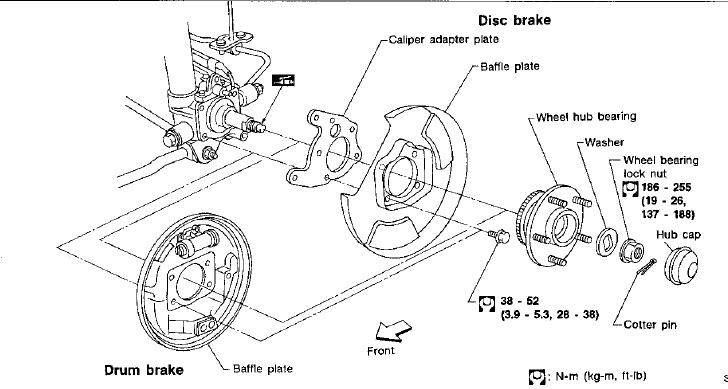

no offense but you have literally ZERO idea what the suspension on this car looks like if you're asking that kind of question.
in this first pic.. you see the bottom of the strut/spindle assembly, with the hub removed. the difference between drum and disc struts is JUST the bolt pattern for the 4 bolt holes that hold the caliper adapter plate or drum adapter plate. the "hub" (the thing your wheel bolts onto) is the same regardless what type of brakes you have.. only difference being it has the notched ring on it for ABS.
this pic shows the whole spring/strut setup. as you can see there's nothing to "swap"
haha
yeah... your right. ive never really looked at that.. but hey.. thats why im on here gettin schooled..
those pics rele help.
so one last question then.
to lower the car, you want new struts and spring. right? okay
so according to that picture the rear strut is one piece with the hub assembly.
how would u get a new strut in there?

there's a huge nut at the top that holds the strut in. factory struts actually just have the strut guts directly inside the tube. all replacement rear struts are a sealed drop-in cartridge.
if you want the car lower, get drop springs (eibachs are the best in terms of not totally ruining your suspension geometry) and stiffer struts (tokico or koni)
