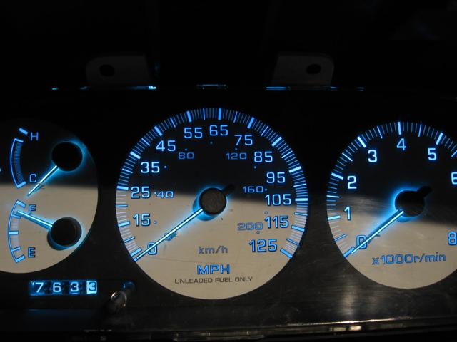

Are you swapping the 125mph for the 145mph cluster? Just wondering I wanted to see what it would be like to have the white in the day and the black in the night. Even though I like the green color of my GXE at night. Jus wanna try something different.

Ohh wow That looks great I will grab one from the Junk yard this week.
yea.. that's just a shadow cast by the overhang of the dash btw. i had one of the map lights by the mirror turned on, otherwise it was darkish outside. but that shows what it looks like in the day vs night (except that during the day the numbers will probably be totally black)
yes it does because he swapped out the dull stock bulbs with L.E.D.'s
