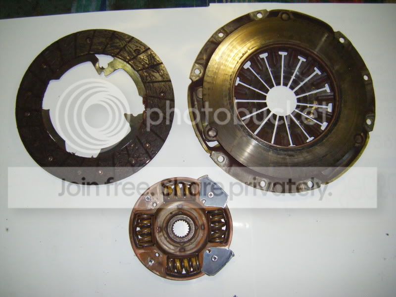

I think what I am going to do is replace the ISB in my original transmission, then start new with a new clutch and install that. I can figure out what's wrong with the current one. It was starting to whine pretty loud in 1st gear.
I did a google search for "ACT clutch failure" and I have seen several images like this:
(This is NOT mine and I have no idea if this is what happened, but it seems possible)
Damn! I hope mine never does this.

Had mine break on three of the for sides of the center were the clutch center meets the outter end of the clutch disc. Also one of the springs popped sideways.
