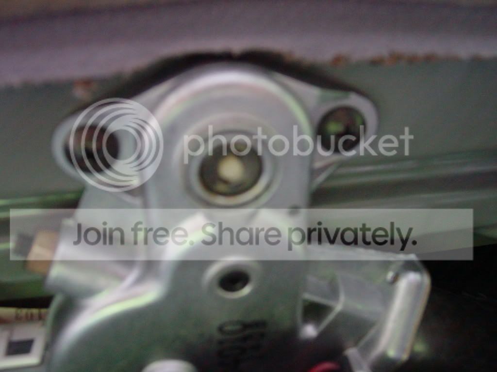

Here's what I've got under the map light assembly.
By nickdoof at 2011-05-23
annnd
Old May 23, 2011 | 09:19 PM

just went outside to look at mine again...im stumped?
only thing i can guess is maybe its not a factory sunroof? otherwise i dont know why you wouldnt have that piece
annnd
I'm just wondering, how do you operate the sunroof before? I have a 93 SE and I'm not sure if the sunroof console will be different from yours. The motor should be near the switch.

It has to be a none true Se because all SE's came with the motor right there where the maplight is at. Question for you with the sunroof problem. Is your motor a dual over head cam engine or single over head cam. here infact ill post a pic of what a DOHC motor looks like just so we can clarify if its SE and there for been altered from the factory sunroof motor.
This is a 1992-1994 nissan maxima SE engine if you truely have a SE.

Wheres the power button that opens sunroof(factory button is on map light fixture). If you follow the button wiring you should find the motor for your sunroof. From this picture it looks like somebody just moved the motor somehow, in the picture it looks like a factory headliner with the sunroof sliding cover but it's hard to see real good in pic.

I have an SE. I have been working on cars for awhile, and if you look at my profile albums you can see my mods/engine.
My headliner sags in the rear, and if I peak back there I can see what appears to be the motor just above the passenger's seats.
My switch is located just to the left of the map light assembly. Everything about the sunroof appears to be stock. If it was an after market it was done very well. Maybe it was installed at the dealer?
As far as I know my Max has all the options, leather ect.
when you say to the left of the assembly do you mean its a seperate piece?
the stock sunroof controls are INBETWEEN the two map lights in the maplight assembly...if yours are indeed to the left of this whole assembly then I dont know...does look like a stock headliner in the pictures especially the map light assembly cutout
maybe someone stole your sunroof motor and thats why it stopped working in the first place
