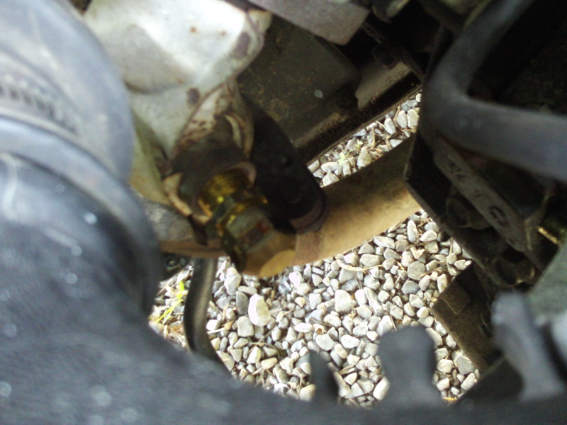

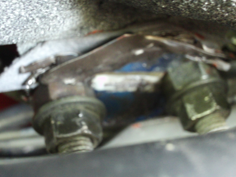

Originally Posted by GRNMAXDMON
Can you post pics. We dont have emissions here either.
JB weld 5-6 layers of aluminum can cut outs, then fit a gasket to the back and add a bit of gasket maker behind it all and tighten it down. ACE hardware has the fittings for the exhaust manifold. I can't remember the sizes though.

Holy crap that is butchered!
What I did was take an extra cam end cap - good, thick, strong, and flat - use the EGR valve to mark my lines on the cam plate. Line up the bolt holes when you do this. I know one hole lines up, been a while so perhaps two of them do. Then take a grinder and cut along the line. Use a file or the grinder to smooth out angled cuts. Use a bit of black silicone gasket maker and two shorter bolts....the end. This is what I did on my turbo.
I can make some of these if anyone wants. Not NWP quality or anything, but clean and doesn't attract attention, just does its job eliminating the EGR.
Only other things I can think to remove is already mentioned - battery, cruise control, and stock airbox.

Hmm, didn't think to use the cam end caps. That'll definitely be something to change out with in the future. This was way cheap and effective.

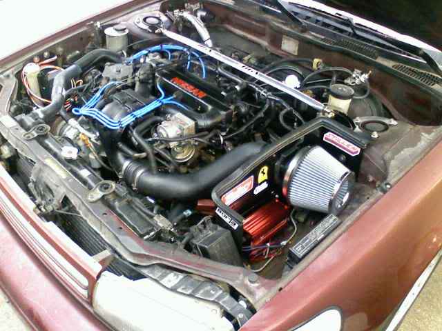

Here's mine:

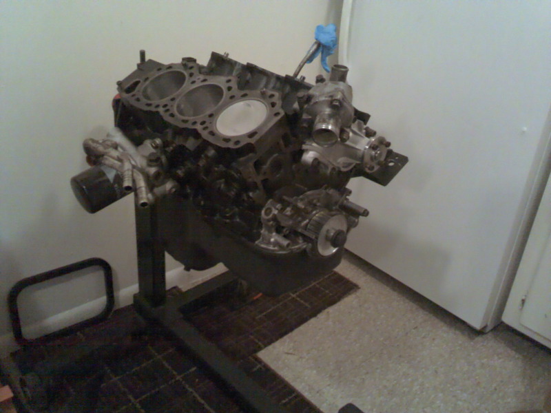

Once upon a time this powered a 3rd gen.
