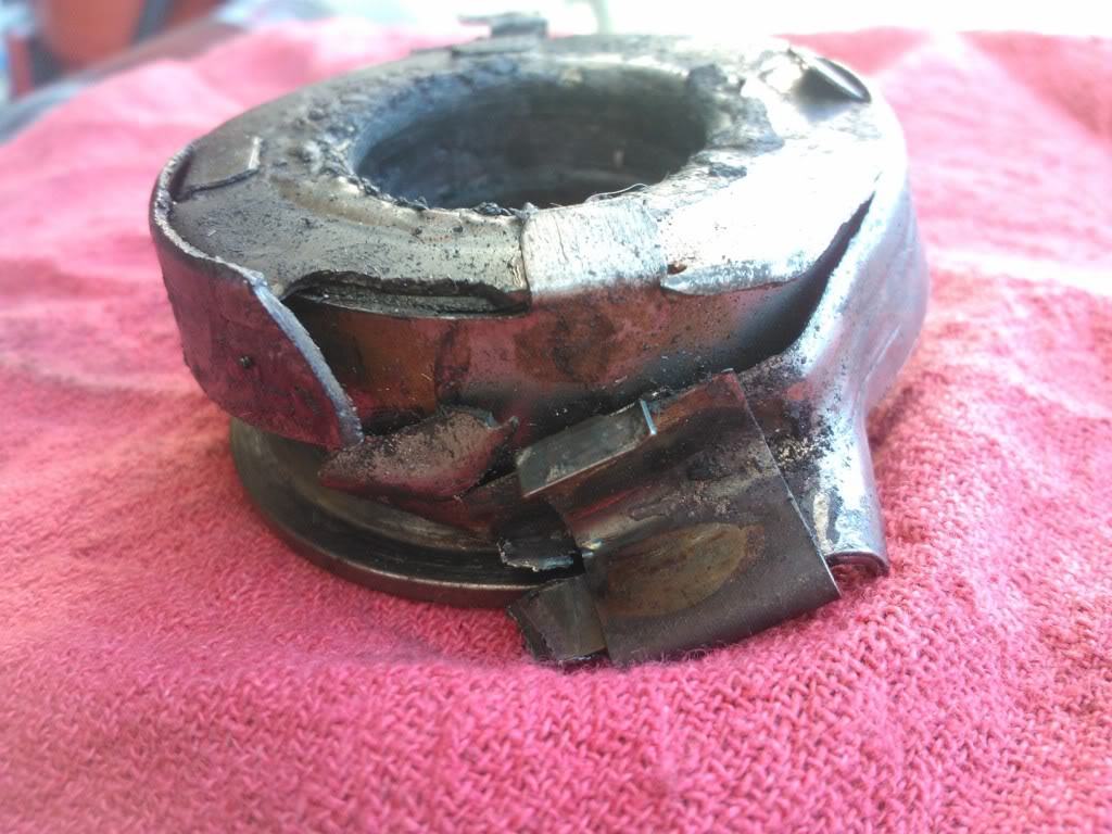

BTW, this is what mine looks like when my clutch failed.

mine looked nothing like that it was just loud so i changed it and now i have to change it again.

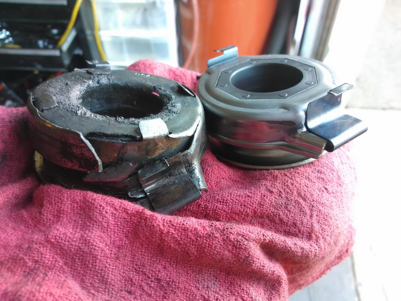

where did you get your clutch kit at? Is it Used? If you put it in right, it shouldn't make noise. Did you DIY?
Here is my new one next to the old one.

My lovely Max had been down for over two years, the clutch went out, left it parked in front of the house the whole time. Brought a used Fidanza flywheel from "Cliff Clavin" and a clutch kit, finally start messing with it two weeks ago, took out the tranny and found out the TOB broke, replace the clutch and replace some steering parts, got an alignment, have new tires to put on next week, will start driving it again really soon.
