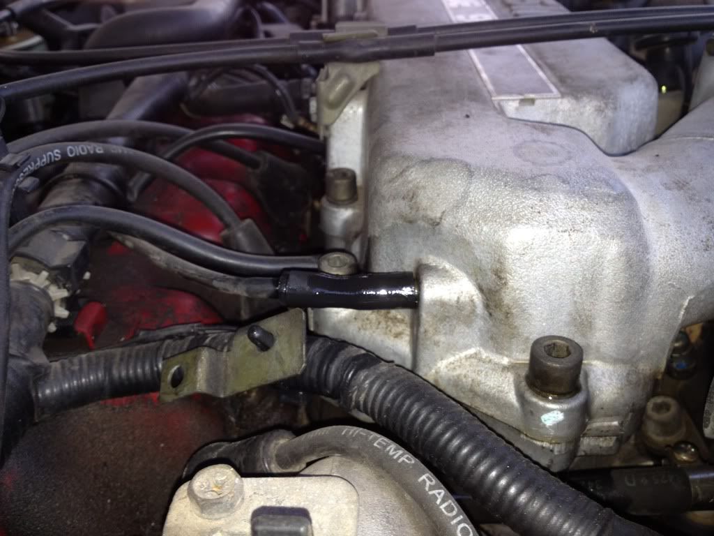

Can anyone identify this part for me, so I can order a new one? It's the hose in the picture that is all wet (with fuel).

Also, I need to know where I can order a new ECU control relay (green one next to the fusible links in the engine compartment, and 30A alternator fusible link (green one).
Thanks in advance!
Thanks in advance!
That hose goes to the heater control valve located on the firewall. But are you sure it is acutally soaked in fuel? If so, you gotta replace the fuel hose on the rail below the pictured hose before it ignites. You can even see that hose is wet with fuel on the bottom right corner of the pic.
EDIT: Did you soak it in fuel so that you can find a vacuum leak? In that case, it's just a regular vacuum hose that you can easily get at a parts store.
