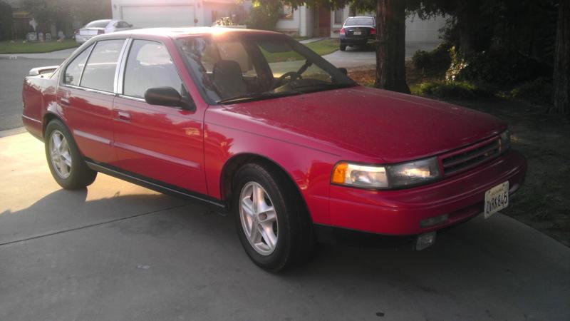

Old Oct 19, 2012 | 08:09 PM
mythic540's Avatar
Joined: Oct 2012
Posts: 128
From: Visalia, CA
Here's some pics, I tried my master key and no luck, it turns but the trunk doesn't budge, tried everything but taking out the backseat, im guessing that's the only solution. Do the trannys on this year have any known issues? Mine seems to be on the stiff side, no slips or grinds but it feels a bit rough when shifting.....

here they are whoops
Attached Thumbnails new to the board and the world of maxima-imag0006.jpg   new to the board and the world of maxima-imag0007.jpg

Take out the back seat and you will have to probably pull the wire on it to get it to open.
Nice pics. Looks like an older version of my car -- even the same wheels. You need to drop it a little, though. Maybe take off that silver trim from the pillars, too.

The body looks good and rust free!!

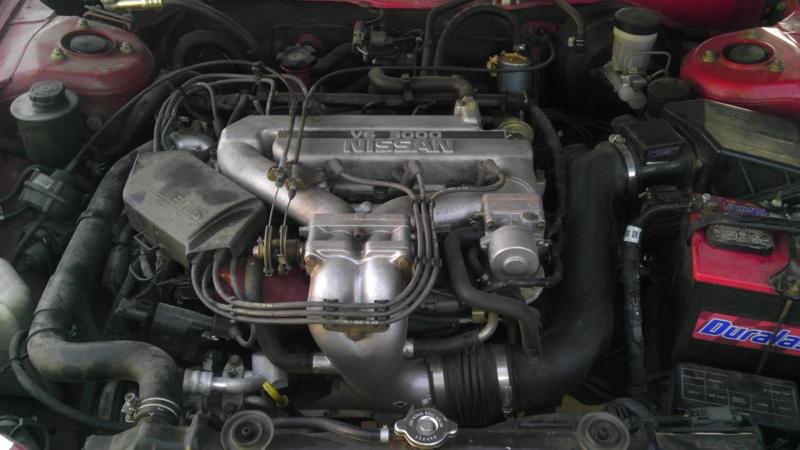

Just curious, the engine on my car isn't a ve is it? Vg was standard on 91 maximas?

From: Atlanta
Welcome aboard! Nice ride! One of the first things I would do is have your battery tested too.
This is from Wikipedia:
The Maxima was redesigned for the 1989 model year as the J30 (not to be confused with the unrelated Infiniti J30) model. Bigger dimensions made it the second Japanese sedan sold in the USA to qualify as a "mid-size" (after the Mazda 929); it was also the first Japanese car to exceed Japan's 67 in (1,701.8 mm) width restriction, making it fairly comfortable for three rear seat passengers. Surprisingly, weight actually decreased slightly from the former generation. Nissan called the new Maxima a 4-Door Sports Car and even gave it a "4DSC" window decal showing this. It now featured a 160 hp (119 kW) 3.0 L V6, with a 190 hp (142 kW) VE30DE engine standard on the SE model starting in 1992. The VG30E was an engine that had been used in the previous Maxima, as well as the first generation Nissan 300ZX. An interesting feature was the digital touch entry system on the GXE (in conjunction with the new Luxury Package), which allowed the windows to be lowered and the moon roof opened without the key in the ignition. In the United States, the VG30E engine, which featured a variable intake manifold on both automatic and manual transmission models, was used on all 1989–1994 GXE models and 1989–1991 SE models. This generation Maxima was fitted with an independent rear suspension.
Lol. Or a shorter answer ONLY 92-94 SEs came with the VE. Everything else 89-94 GXE/SE was VG. Only those 3years were the SE with a VE.

Dang I thought I was special there for a sec, I was hoping it was so I could do some mods to it after I get most of the little things fixed, but don't know anymore
