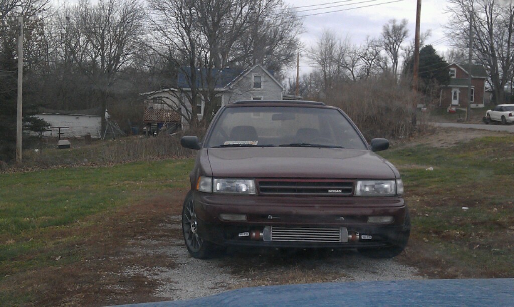

I live in Nebraska so don't drive it much during winter took for drive other day. Before tear down. Converting to top feed injectors (currently maxed my 370cc 140% duty cycle and had run an fmu) and either gutted z31 plenum or 200sx if can locate one. My current intake is pretty restrictive way may charge piping is. Only 2" inlet to throttle body. I also found a boost leak which once fixed im reading 20psi. Link is to new video.
Really dirty engine bay pics. Ignore wiring mess this was when was wiring my z32 maf.

Showing off the front mount.

It frustrates me that the VG30e sounds better when it's in a Maxima than it does in a Z31 I guess it's the intake manifold design, cuz you're already running custom exhaust setup for the turbo. I always felt like the Z had a "splattier" sound than the Maxima... given that I have one of each. My maxima sounds happy as **** even tho it's stock slow.
btw am i seeing something wrong or does your wastegate have no boost ref line attached in those pics? You said "teardown" tho so maybe you were taking stuff apart already..
Anyways I have some spare Z31 plenums here and there if you want one to gut... might be cheaper to pick one up local tho. I'm assuming you have the equipment to weld aluminum...
