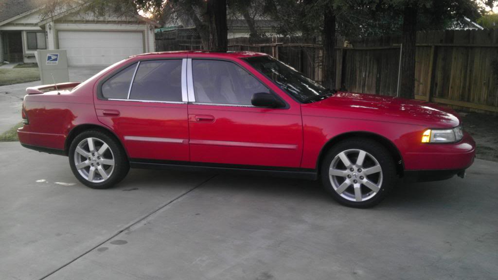

I just got these new wheels on my max, I want to lower it at least an inch but not too low either, would it be safe to just do a one inch drop and call it a day?
nice... 5.5g gle wheels. to answer your question you can read the posts above...
Clean Max, lose all the Chrome by the Windows do it in Black will Look 1000000000000000 Times better.....
Yup after a stillen lip kit, e36 conversion, a 1 inch drop and a new paintjob I should have this thing in tip top shape
