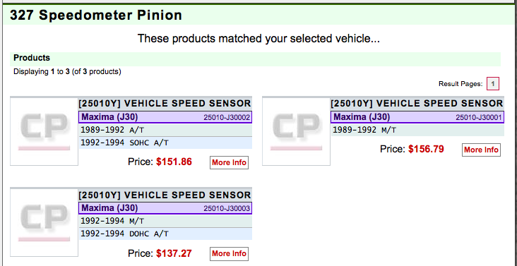

Originally Posted by woot
I have a guy with a speed sensor from a 92 ve wanting to sell. I'm guessing this is also work in my 90?
This is how they interchange. It's ambiguous for the 92 manuals.
I don't see anything at this site that tells me whether the 92 will work on the 90. Maybe I am just looking over it though?
the years are like.... right there
but one of them says 89-92 M/T, the other says 92-94 M/T, so there is techincally a possibility for overlap between them. But I believe 89-92 should really read 89-91 for M/T and A/T because that's when all 3rd gens had a VG engine and associated transmission (RS5F50A and RE4F02A). VE is RS5F50V and RE4F04V.
I assume however that the 92 will not work on a 90, since all M/T are (originally from) SE cars, therefore the 92 M/T sensor is out of a VE, and your 90 is a VG... so the gear ratios won't match.
