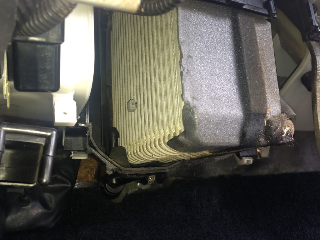

This morning I attempted to remove the lower half of the evaporator box. I was able to remove all the screws around the case except one. There is one screw totally inaccessible between the evaporator box and the firewall. Before I discovered that screw it actually looked like I'd be able to separate the evaporator box without having to remove the evaporator itself or open up the system.
I decided to just cut the lower half of the box open so that I don't have to pay any extra labor at a shop or for another evac/recharge. So I broke out the Dremel and cut it off. You can see the clip was in the super low spot as addressed in the TSB. Here's the original location:

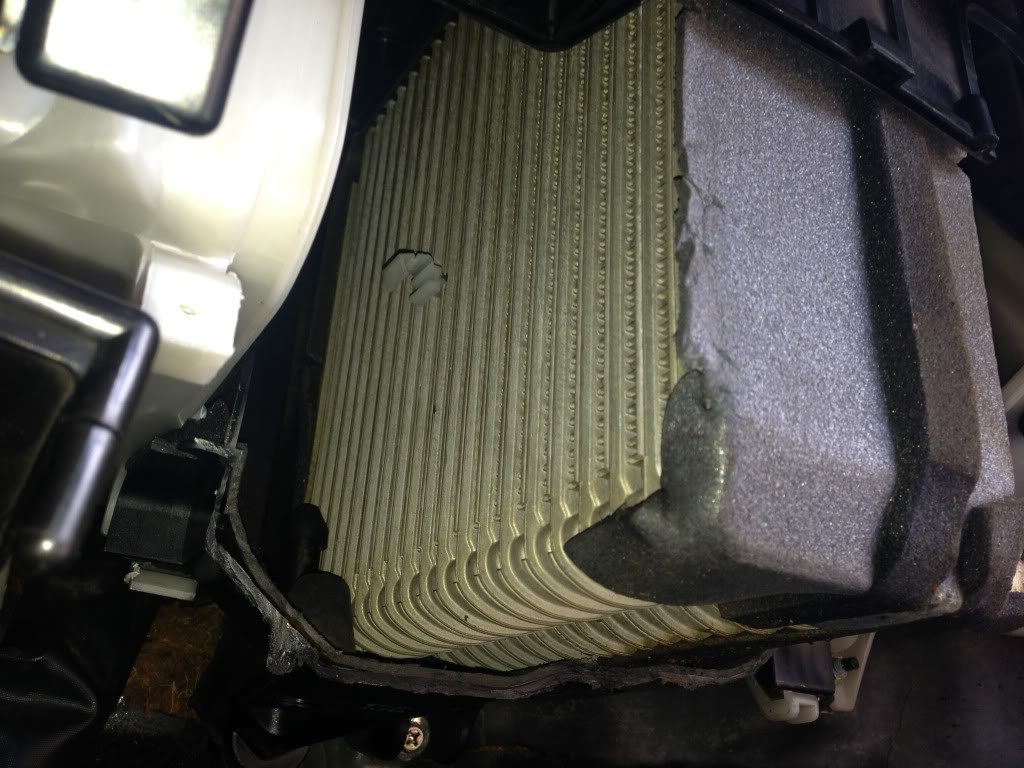

So I moved it up (just about ~2 inches) as per the TSB:

Put the box back together and used a 2 part "plastic weld" at the seam where I cut it open. Went and did some errands today, good mix of city and highway driving and all was well! Amazing a 2" difference in position can make such a difference. Thanks for posting about that, jbbons25. I certainly would have never figured that out on my own.
