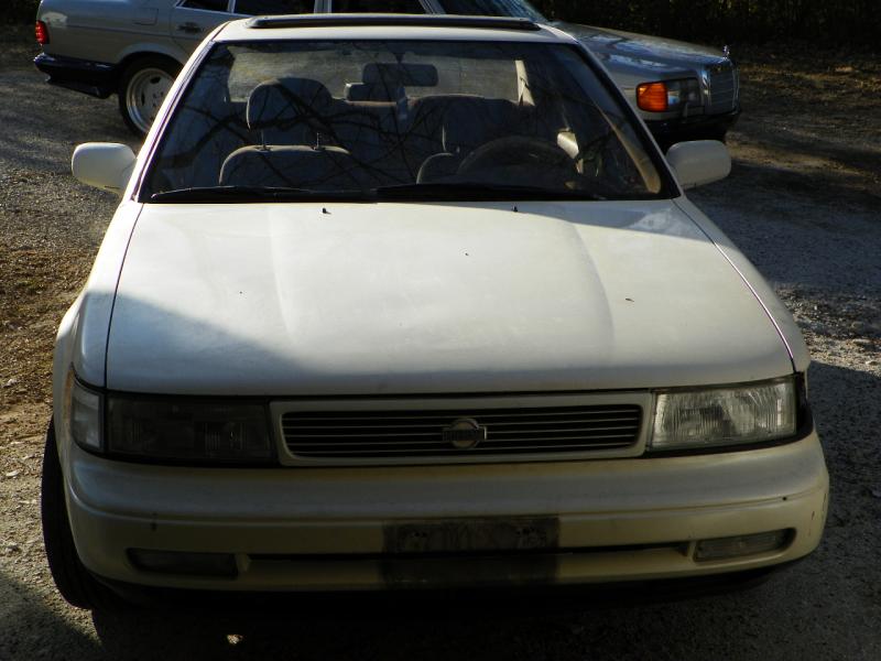

Exterior: I give this one a 7 out of 10 condition wise and that's only because the trunk lid is out of whack on the driver side, driver door sags badly due to worn upper hinge, mismatched exterior mirrors and the antenna is broken off but I have replacement mirrors and antenna ready to be installed and are relatively easy to do. Other than that there are a few dents and dings here and there and a couple of rust spots but that is expected of any car this age. The paint could really use a good claybar and wax job but in due time. It is very dirty from the voyage down here.

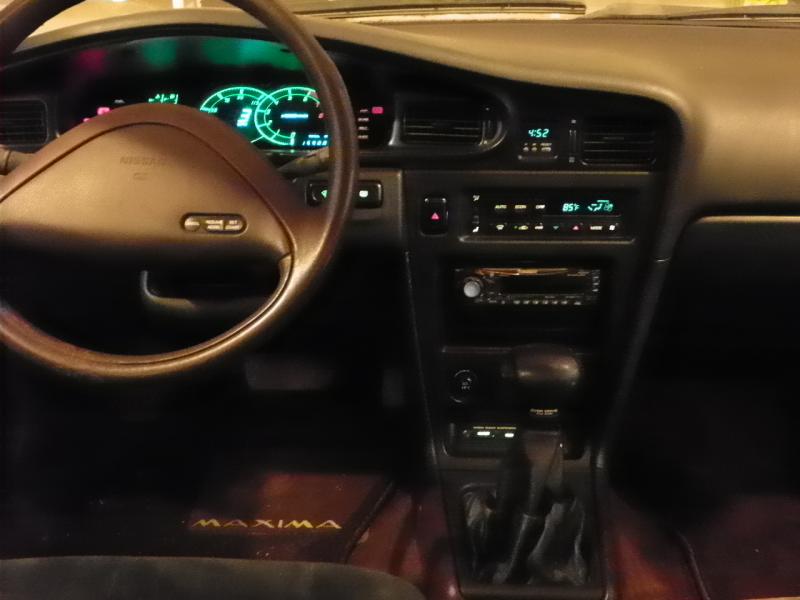

Digital dash display works flawlessly but speed sensor in trans is faulty as speedometer reads 15/23 mph while in park.

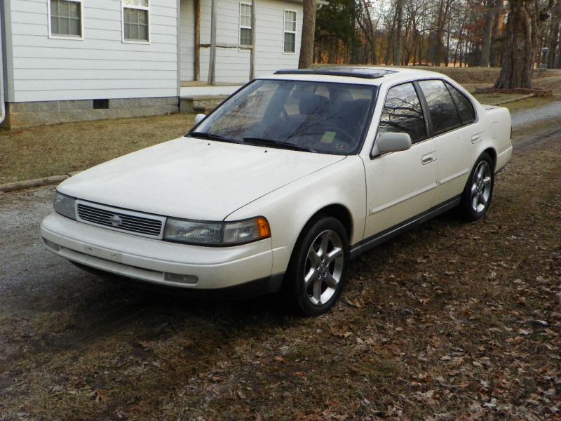

Here is how the Digimax looks right now, just off the transport truck.

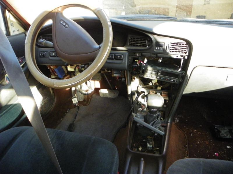

Lower dash on driver side is now completely back together and looking better. The steering wheel needs to be replaced as it is worn just about everywhere. I would like a completely different wheel all together because this half moon wheel is ugly.

The dash and console are completely together now, glad I scrounged up some extra screws and clips during my JY run.

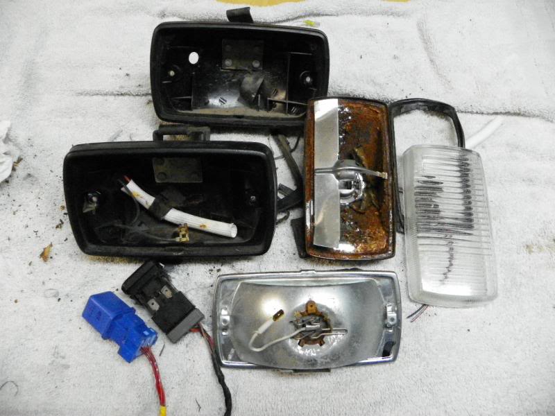

What I did accomplish was sourcing out the electrical short I had on the interior lamp circuit and eliminating that problem. That turned out to be the micro switch mounted to the ignition switch itself so I replaced it with one I had on another switch. As it turned out, looking through the service manual the warning chime, sonar suspension amplifier control unit and the automatic shift interlock are on the same circuit as the dome lamp so all is well now on that part.

Now the 15amp brake lamp circuit fuse blows as soon as you step on the pedal. I have already ruled out the brake lamp switch and both rear bulb holders. I will have to look at the service manual to see what else is on that circuit besides the cruise control witch worked fine before and go from there.
Pics here............... http://s64.photobucket.com/user/82je...tml?sort=3&o=0
I'm pretty sure your taillight fuse problem IS in the bulb holders. Thats why I only had one brake light bulb in each taillight. Wouldn't blow the fuse that way, plus you don't really need 2 bulbs in each..
I have unplugged both bulb holders in the rear and the short still exist. I unplugged the stop lamp switch and used one of my spares hanging down under the dash and it still blew the fuse.
There is a shorted component in the system*somewhere, I just have to track it down and eliminate the problem because I would rather have all of the brake lights working as they were designed too
The stop lamp circuit seems to have fixed itself for the time being, for some reason the fuse no longer pops when the brake pedal is depressed. I will look into this again when the problem reappears and I'm sure it will.
