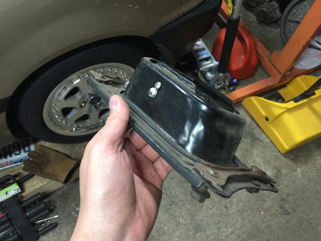

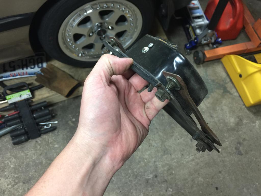

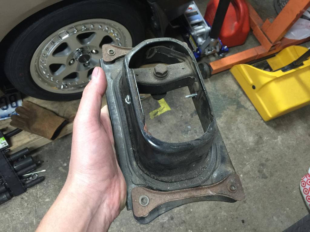

Anyway, that bushing is what holds up and supports the whole shifter and shift linkage. There should be virtually no play there. It is held in with four 10 mm bolts that you must access from underneath.
I took some pictures of my spare one so you can see how it mounts. See the two rusty colored "strips" on the front and back of my unit here with the studs and nuts? That is how it's held in. There will be little pieces of metal that will be bent over the two rusty strips for some reason, you can just bend those up and out of the way. It's really easy actually

*edit* and to be clear - the ENTIRE thing in my pictures I just posted is the "bracket holder". It all comes as one piece. You will need to-reuse those two strips that have the studs and 10 mm nuts on them though.
I see now my direct link from earlier doesn't seem to be working but it's part number 3456051E05 and is $29 from Nissanpartsasap.com. If you're ordering from somewhere else and need to find it in the Nissan browseable catalog you need to go to Power Train -> Transmission Control & Linkage -> Bracket Assy-Holder Rubber. It's 34560N in the catalog.
