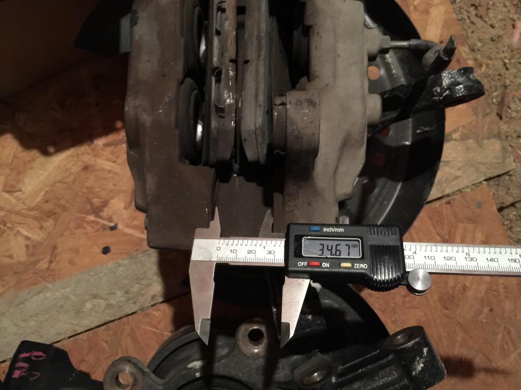

so i got my z32 calipers the other day. when i purchased them i was confident they were 30mms but as I waited for them to show up and kept looking back over the ad I'd convinced myself I messed up and got 26mms.
well when I got them I opened the box and measured it and compared to the importnut pictures and was pretty sure it was a 30mm version.
just today I pulled the other caliper out of the box and could tell a difference right away. after comparing that one to those pictures im convinced that one is a 26mm version.
my digital caliper is reading 30.2mm gap on the one, and 32.8mm gap on the other.
supposedly im looking for 34-35mm according to what im finding when researching. did anyone else have trouble determining what calipers they have? because im convinced i have one of each.
also one of my calipers says "2" next to "SUMITUMO" the other one is a "3"
Old Oct 25, 2014 | 07:02 PM
James92SE's Avatar
2 VE's are better than one!
iTrader: (31)
Joined: Sep 2000
Posts: 7,362
From: Dallas
How are you measuring? For what it's worth, this is what I get on my spare 30mm calipers.

Wait a minute. After I posted that I noticed that picture above showing ~35mm for the 30mm calipers. I went back to the attic to measure my other spare set that I snagged at the JY some months back.
This set measures ~35mm.
That means the set in my first picture is a 26mm set!
I bought those from somebody on this site years ago. I can't even remember who it was now but what an MF'er. I was clearly told at the time they were 30mm units. That bastard.

I'm using the same digital caliper as you. I measured again and its still 30.2 on the driver caliper and 32.x on the passenger side. I'm thinking these are both 26mm versions. Which sucks because they are either relatively new or rebuilt. I could put them on without having to worry aboutpainting them or anything.
I saw a picture of those spaced calipers in my searches thru the advanced braking forum. I wonder if its something I can get ahold of and install because I'd really like to use these ones.
Thanks for the pics..with the forum being a ghosttown i wouldntve known. Got them from ebay and i was ready to tell the guy he sent me a mismatched set lol.
