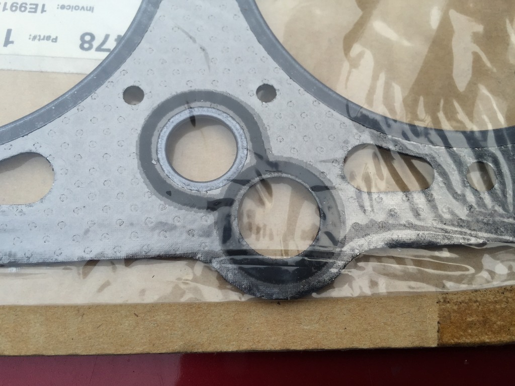

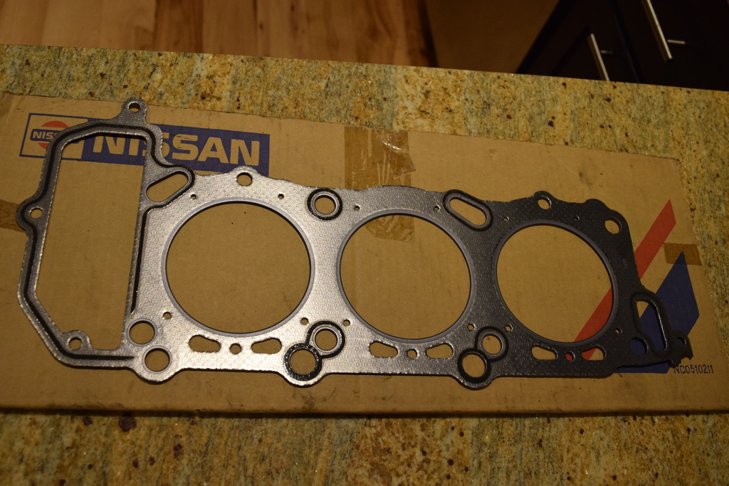

Hey all,
I'm in the process of rebuilding my VE, and come to find out that Nissan does not carry our head gaskets anymore (according to Courtesy). They had one in stock (left side) and could not locate any more. So, I was forced to look at aftermarket options for the right side.
I was (and still am) somewhat leery about using cheaper aftermarket parts for such a critical component. I found a couple on Amazon that seemed to be decent and, rather than roll the dice with one, I bought both (they were cheap enough ) thinking I will compare the two and use the best quality one. The two brands to compare are Beck/Arnley and Nippon Reinz. The Beck/Arnley was $46 and the Nippon was $17 OEM I believe ran from $40 to $60, depending on the dealership.

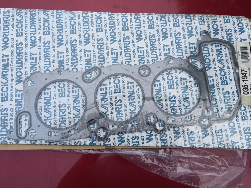

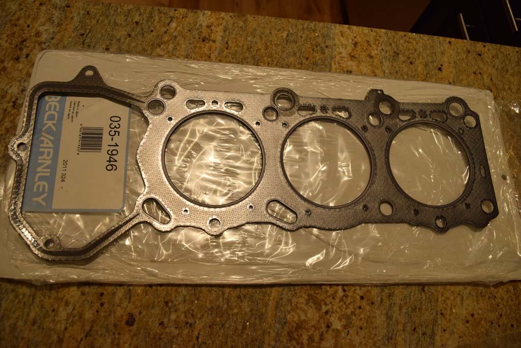

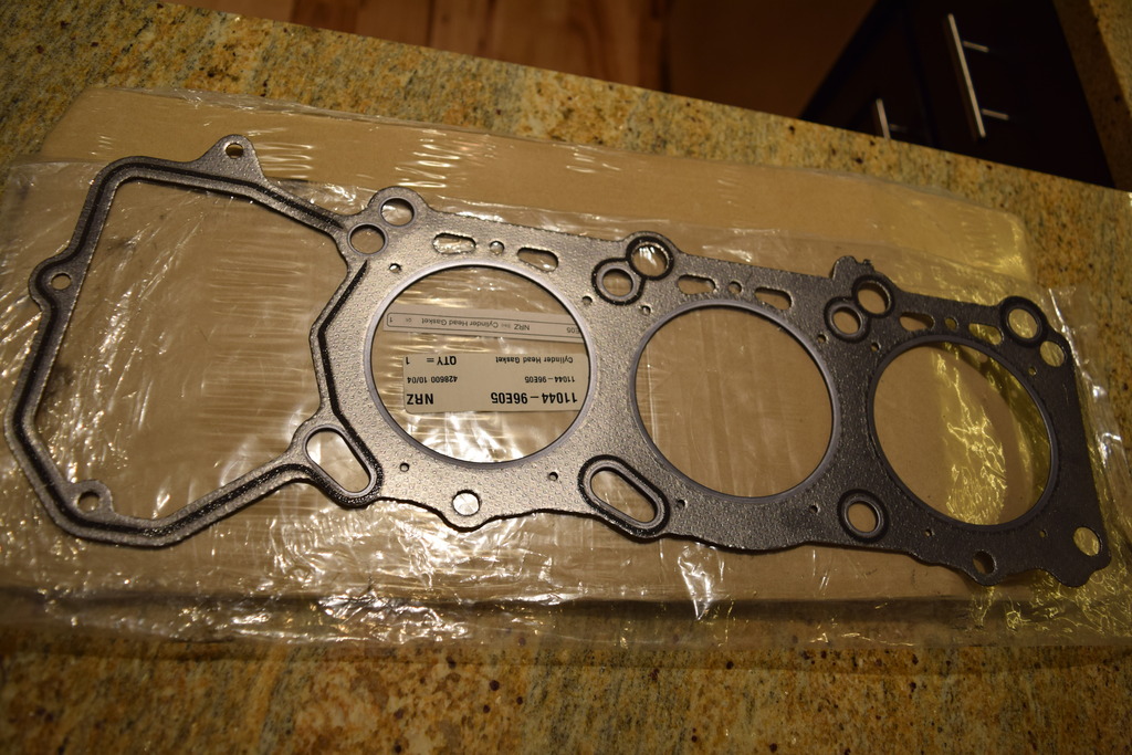

I took a few pictures of each gasket to try and compare the quality, and here are the results. This comparison is between Nissan OEM, Nippon Reinz, and Beck Arnley. In each set of photos, the OEM is on top, NR in the middle, and B/A on the bottom.
First, the overall pictures:

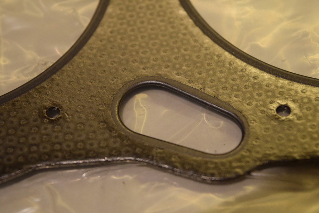

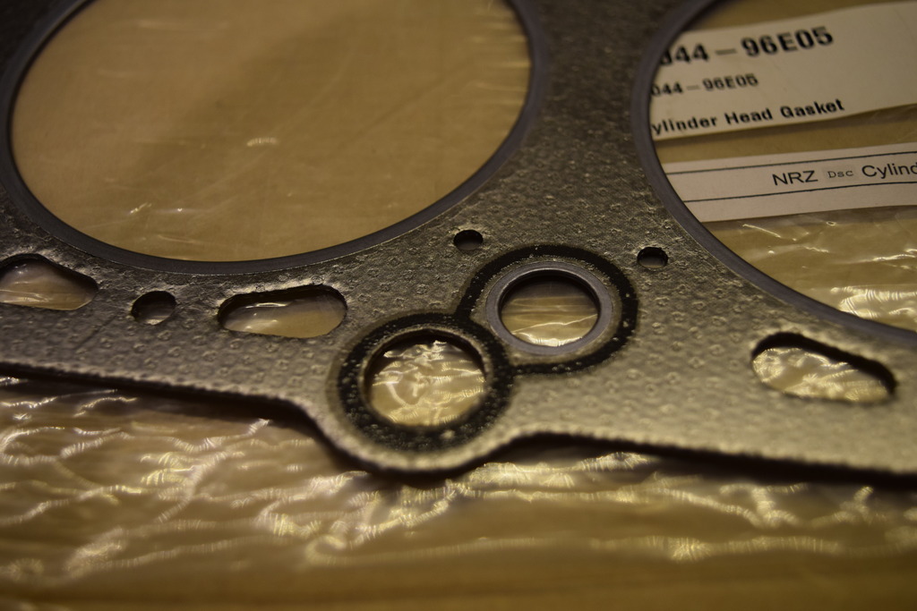

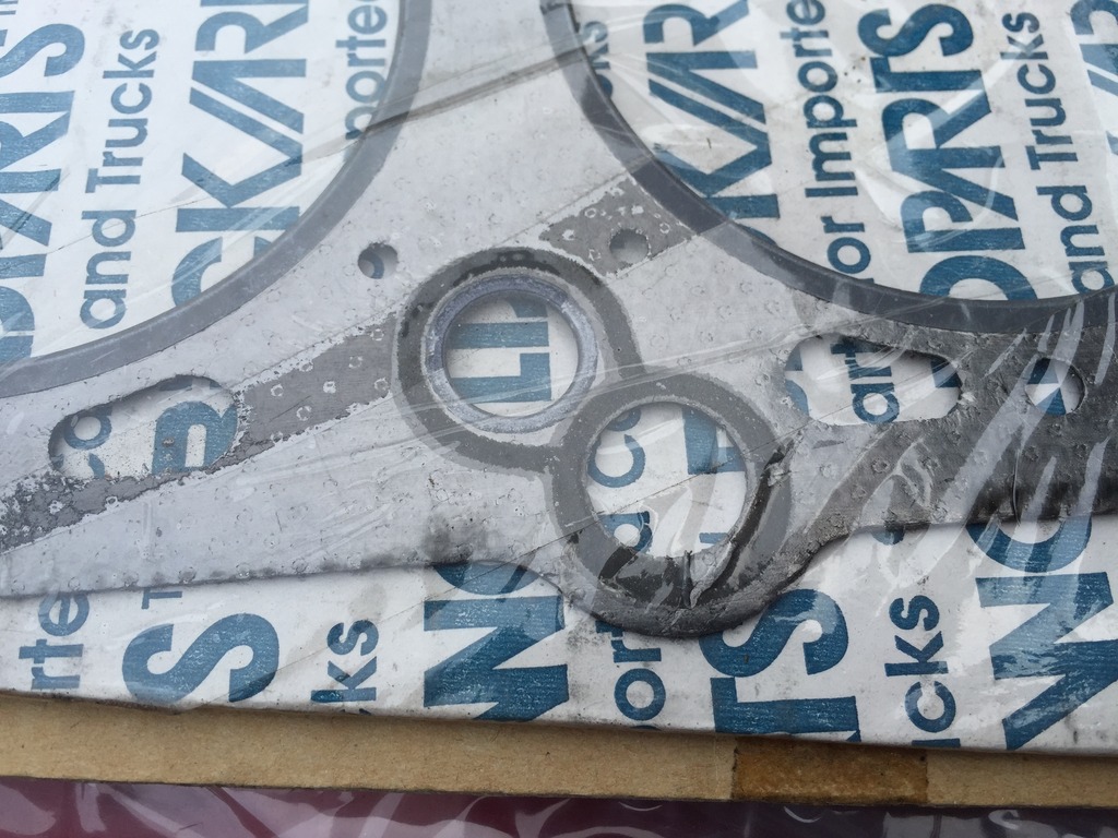

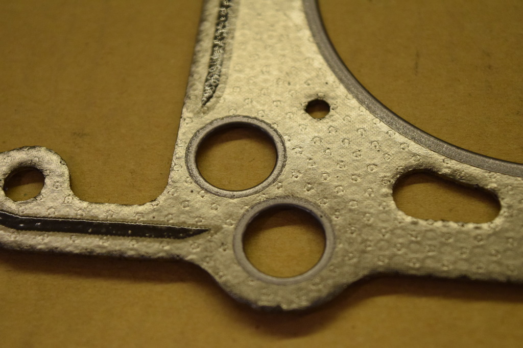

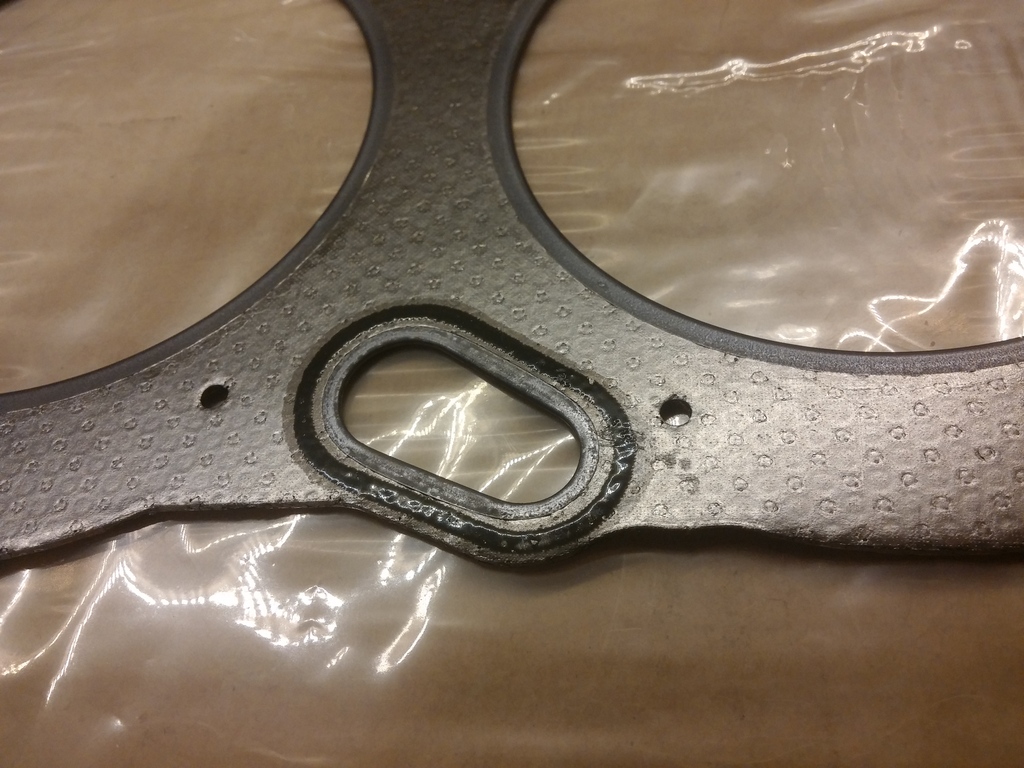

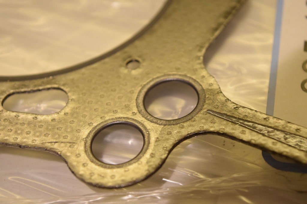

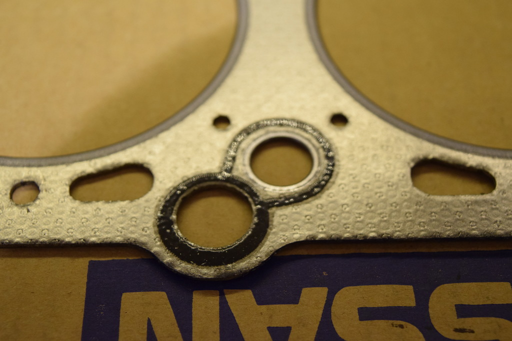

Next, close-up of some galley seals:

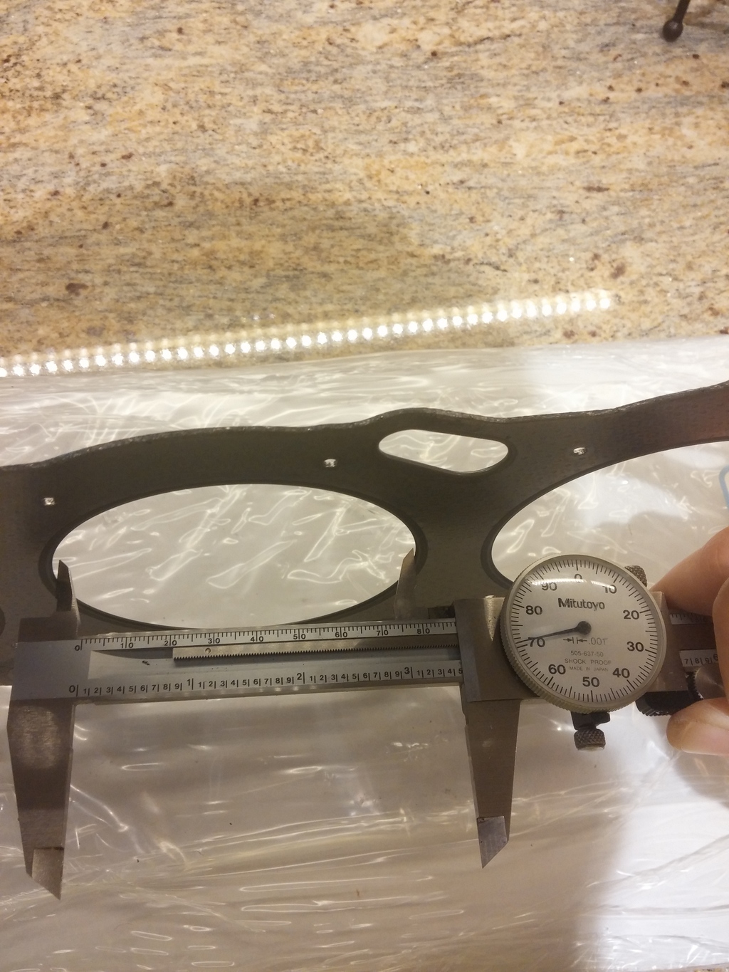

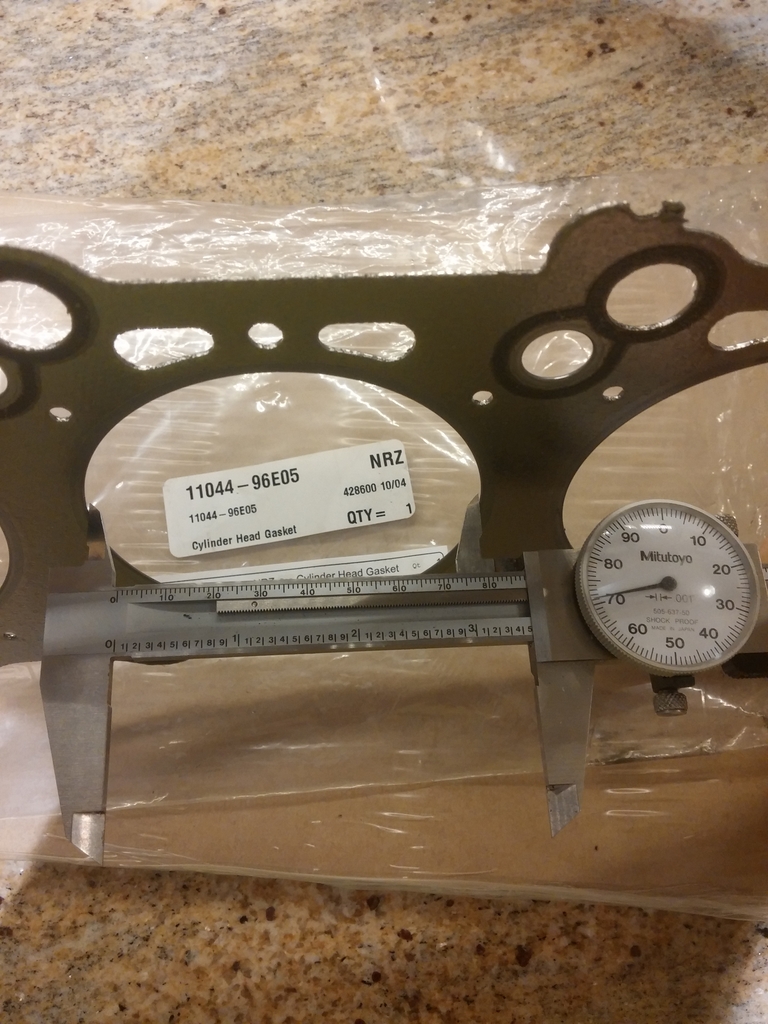

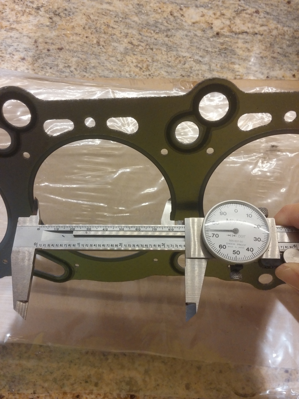

ID of cylinder bore:

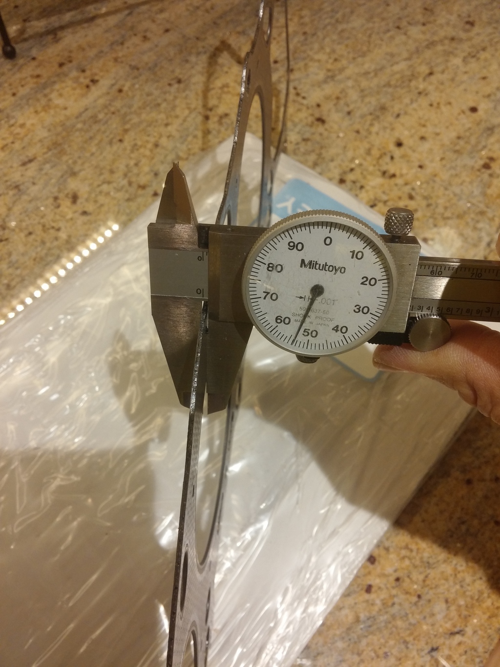

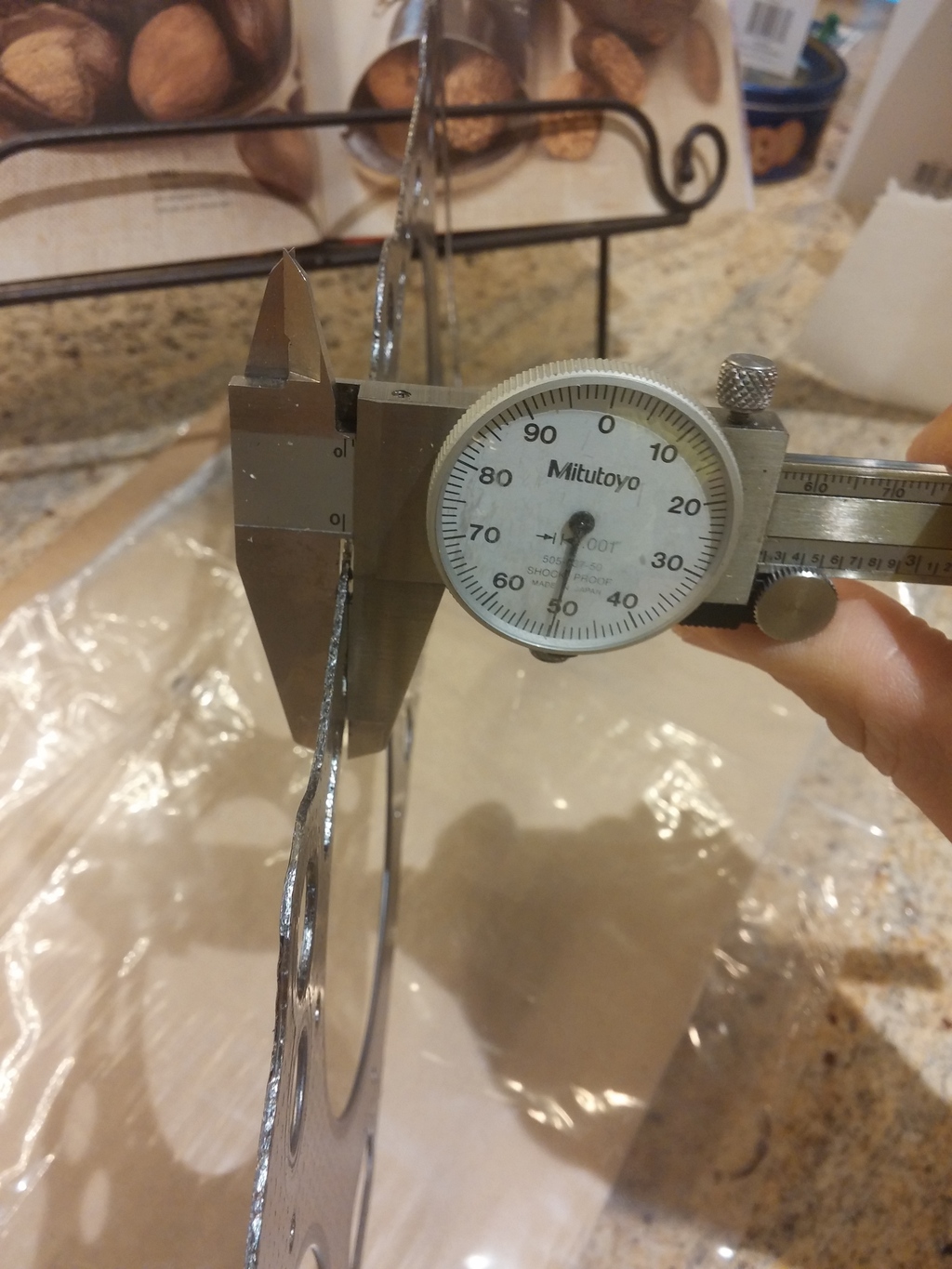

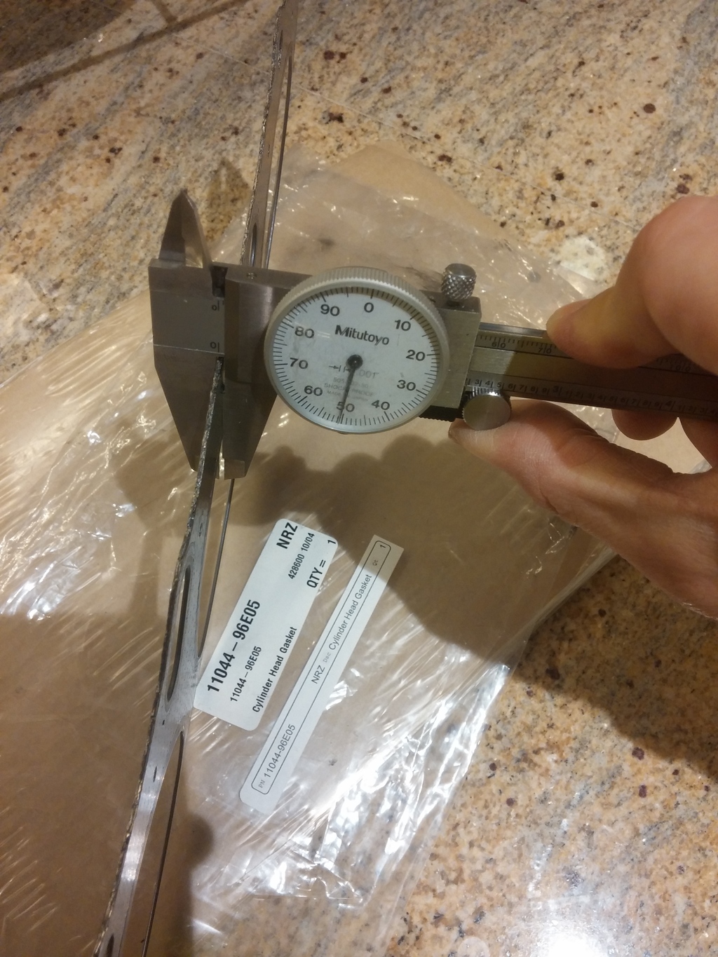

Thickness measurements:

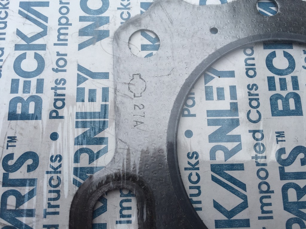

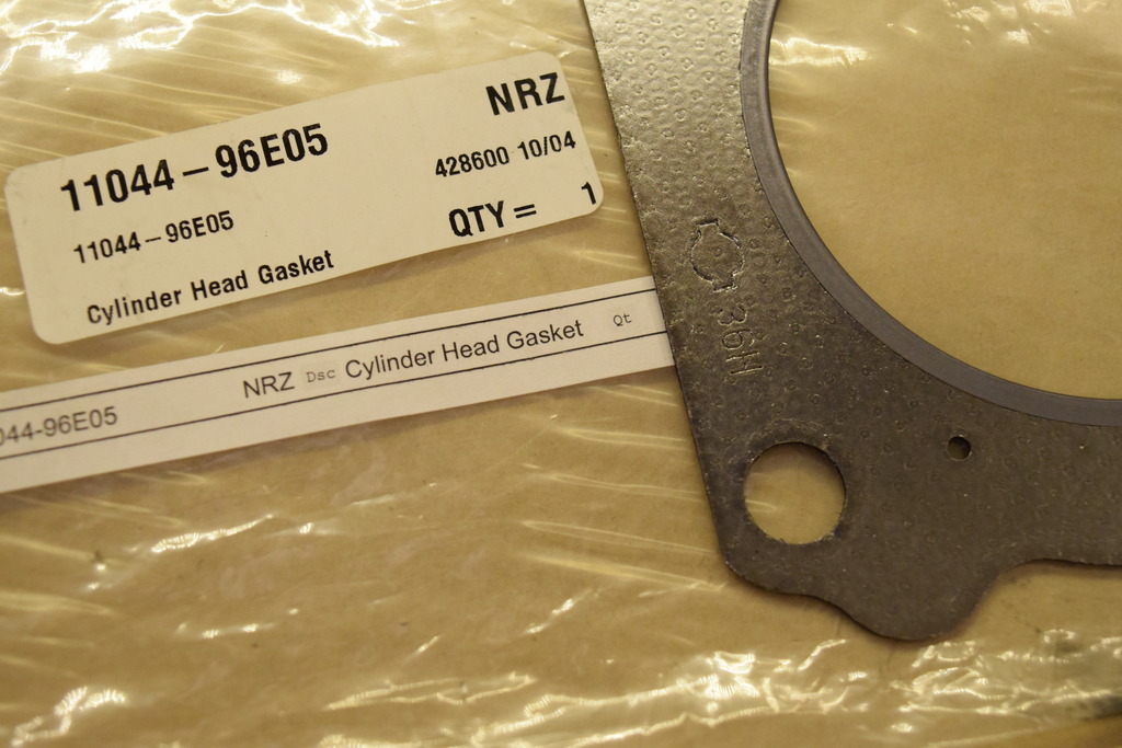

A few final pictures of the stamps on the Nippon Reinz (top) and Beck/Arnley (bottom):
Interesting, as it looks like the NR gasket is a repackaged OEM one. The measurements and quality all seemed to be very much closer to the OEM than the B/A gasket.

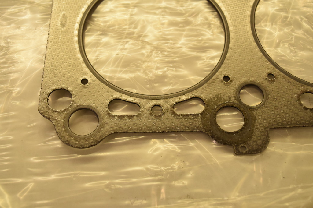

Here is another pic of the B/A gasket, noting the lack of the rubber sealing material around most of the galleys:

Like you mentioned, the Nippon looks more like the oem with rubber seals where the B/E doesn't. Also it looks like the B/E is slightly thicker than the other two, which is not a desirable trait in a head gasket. I would recommend the Nippon by far.

Pretty interesting. When I first saw you mention the Nippon name I was thinking to myself that Nippon is a supplier to many of the Japanese OEM's. Nippon and Ishino both supply the OE gaskets for Hondas and you can save money by going straight Nippon or Ishino on the Honda rather than the dealer, so it makes sense the Nippon appears to be OE for the Nissan. Looks like your Nippon gasket even has the Nissan logo right on it too?

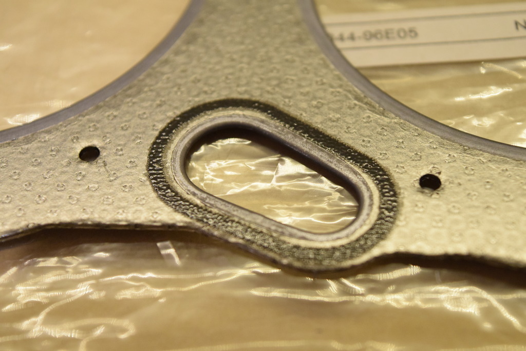

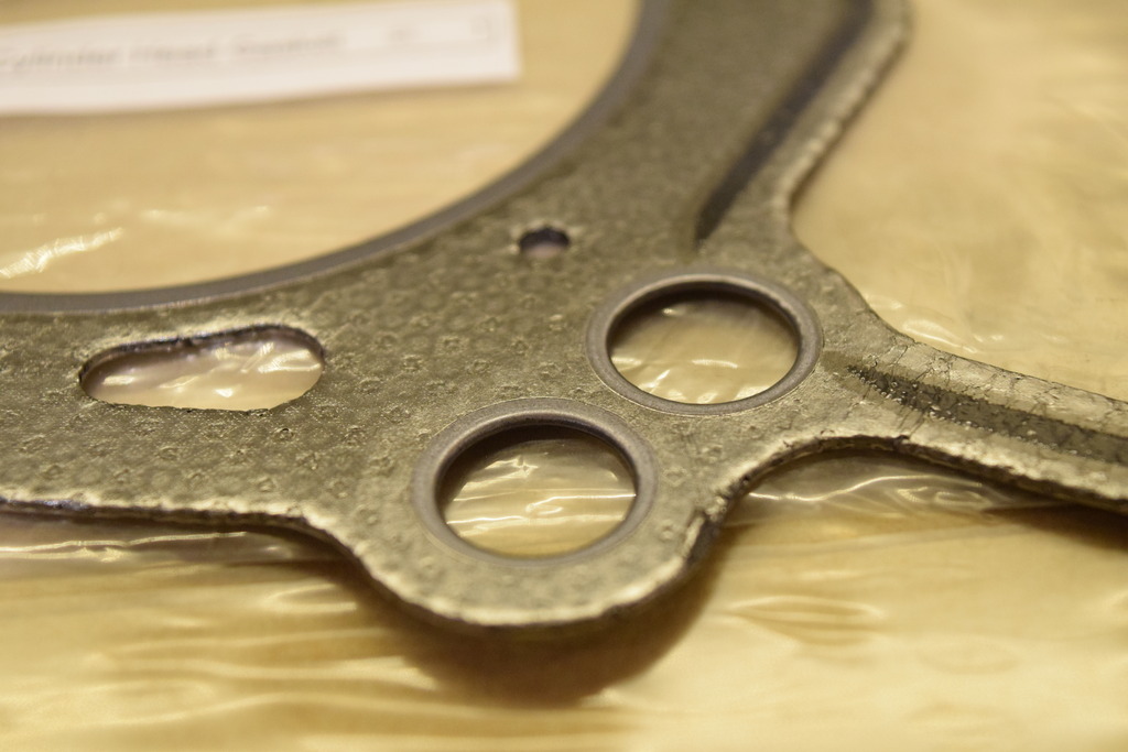

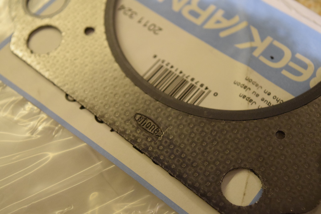

Here's an interesting update to this. Years ago I bought some OEM gaskets/seals from a member who was leaving 3rd gen scene, I can't even remember who it was offhand.
Anyway, so I have both OEM head gaskets and then one random Beck/Arnley head gasket from that old member. Seeing as I'm about to use the OEM set on my build I figured I want to stock up again to have an OEM set or two for future use and tonight decided to check out my Beck/Arnley and OEM's.
To my (happy) surprise, my Beck/Arnley is actually an OEM unit (it even says made in Japan). Pretty cool. Check it out:
Nissan logo on my Beck/Arnley:

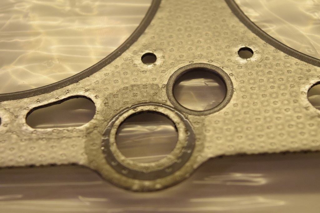

OEM vs Beck/Arnley seal comparison:
