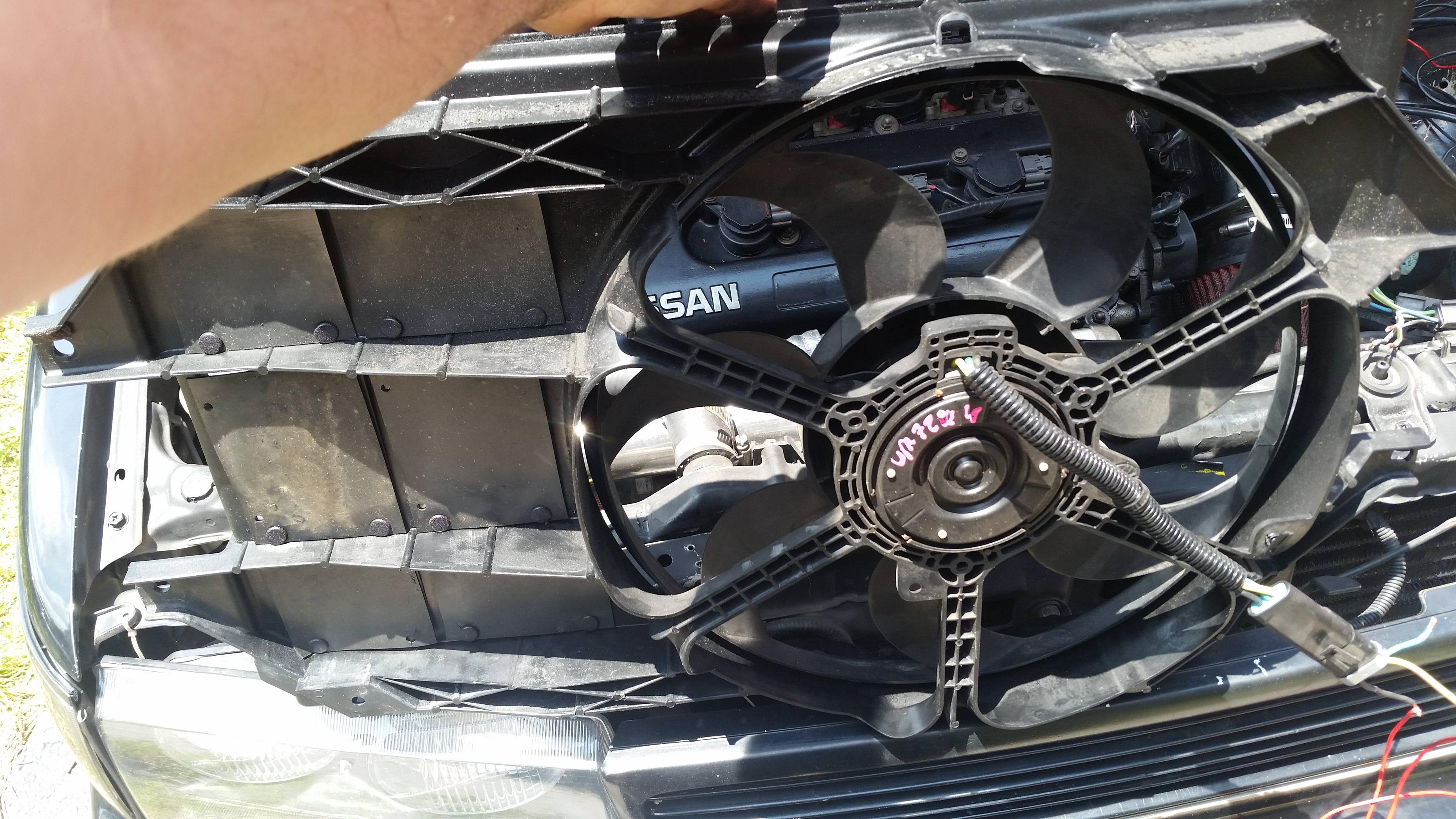

Is that single fan going to work as both your radiator fan and your condenser fan?
Old Jul 25, 2015 | 03:56 PM
TonyJr's Avatar
Joined: Sep 2011
Posts: 1,048
Its work for bradse92.
It will be on all the time. It cover the whole radiator
