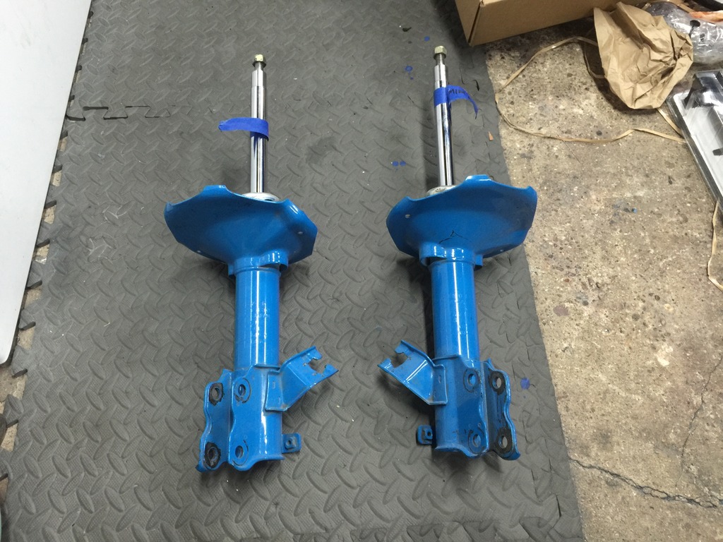

Yes it will work. I just checked my spare set of Tokico fronts that I picked up from Mike Kantor some years ago - the spring perches are actually the same on each strut. I figured they would be mirrored but they're actually identical. Hard to see in the pictures but the "notch" for the end of the coil is on the right side on both perches.
